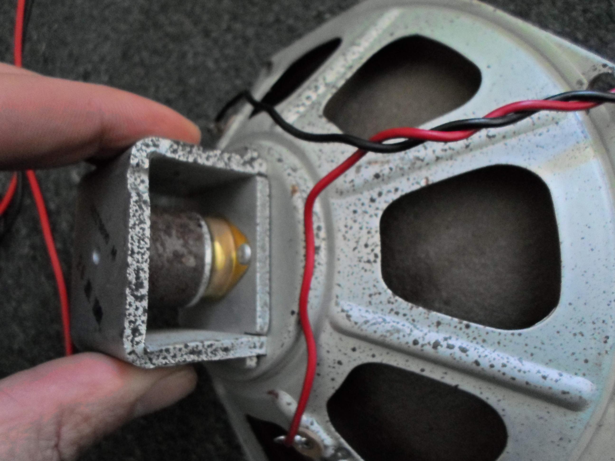

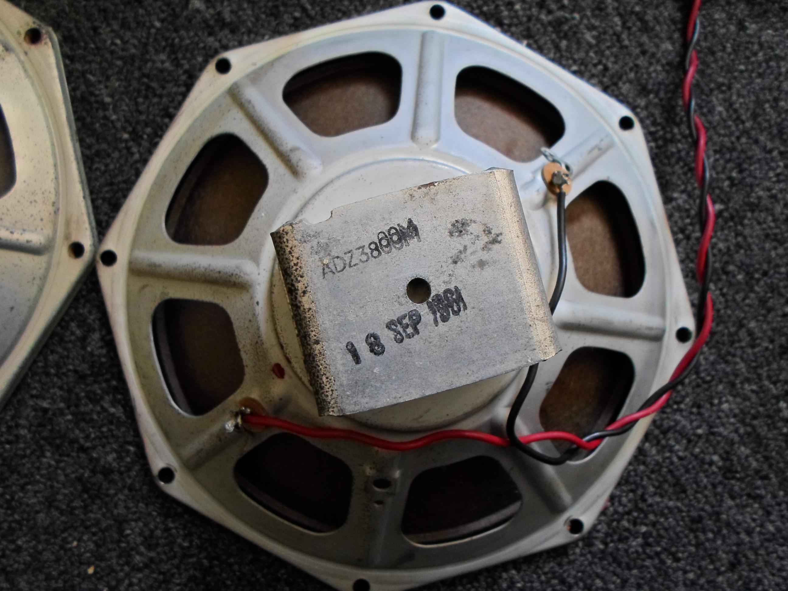

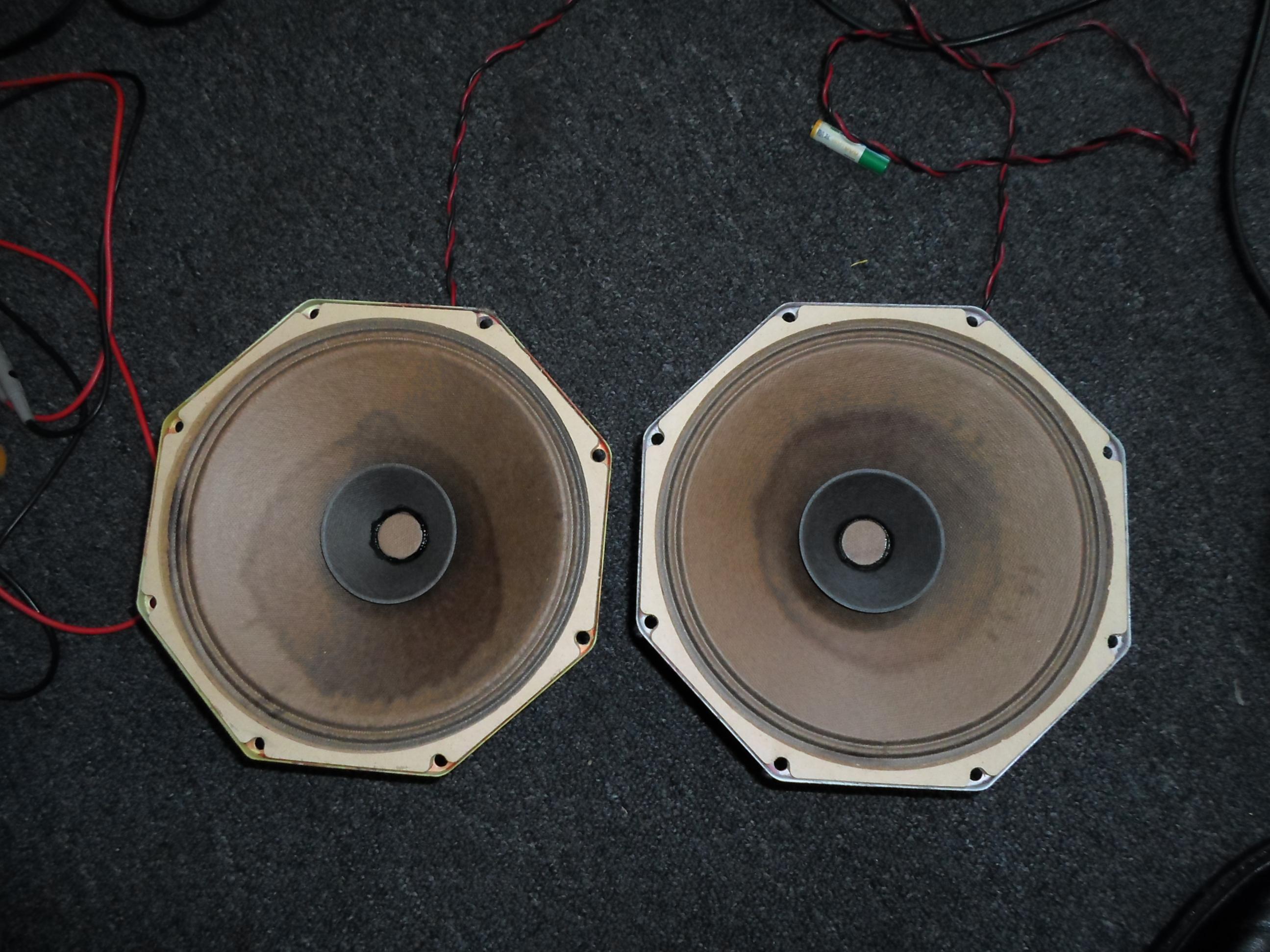

hello,
I bought some 8inch speakers for my stereo, they were sold as philips 800 ohm.
i have wired them in place of my 6 inch built in ones and am getting next to no sound, really quiet,
first i tried plugging them into my extension plugs and the sound was even quieter.
the 8" read 3.4 ohms each.
my original working 6" read 590 ohms,
have i been ripped off and sold broken speakers or are these just 4 ohm speakers some one has sold as 800 ohm? they were only $20 + postage, are they junk? they move smooth and the polarity is fine with 1.2v.

I think you got it: these are 4 Ohm speakers.

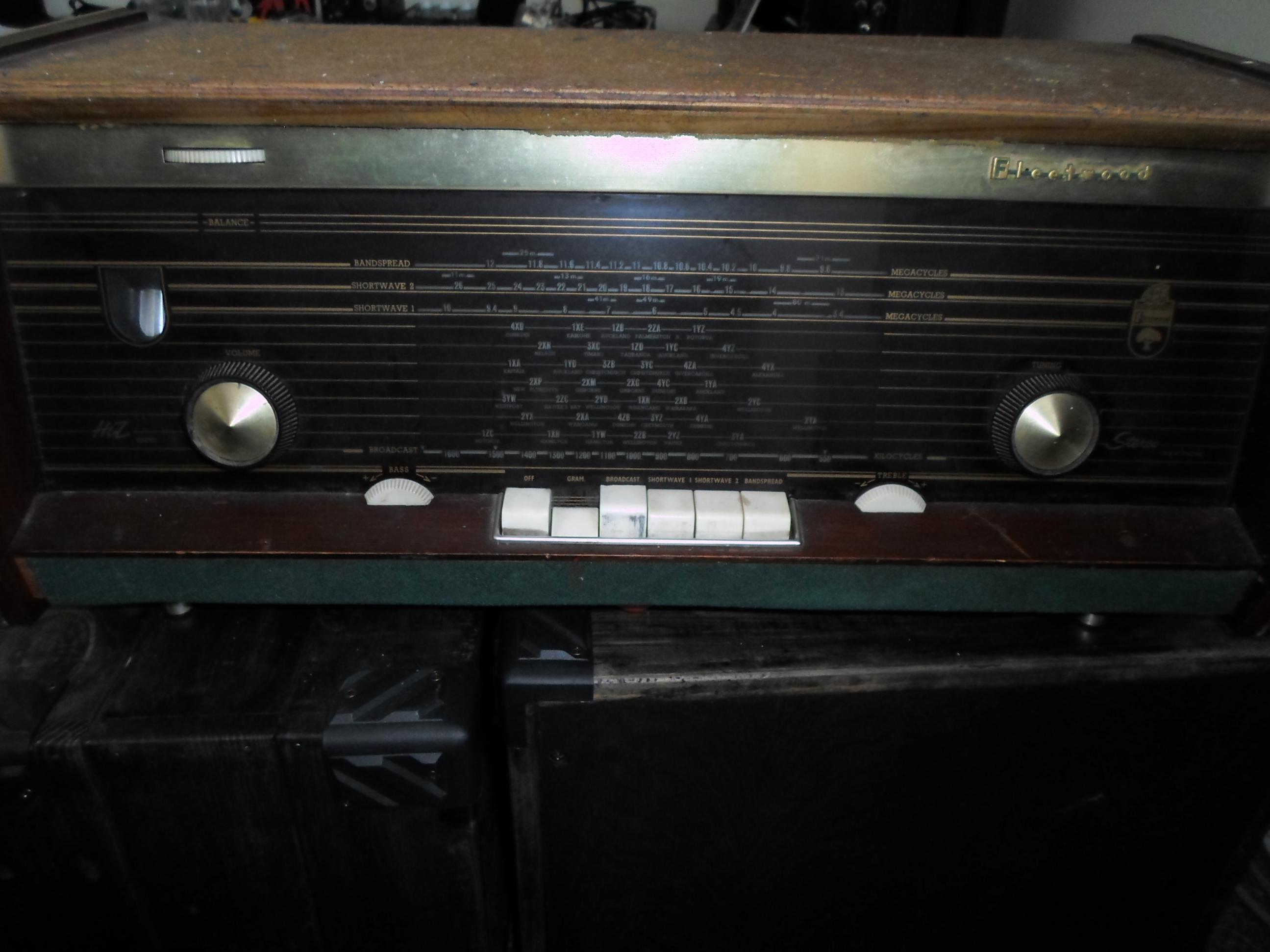

If that is the "800 Ohm" Philips radio, it will strain and be unable to put real power in an impedance 1/200th what it was designed for.
As all the 800r Philips speakers are getting old, it may be time to look at 800:4 Ohm 1 Watt transformers. Hammond's multi-tap comes to mind.
http://www.hammondmfg.com/125SE.htm
125ASE, connect radio to BRN and BLU, connect 4 Ohm speaker to WHT and BLK. This is nominally a 1250:4 transformation. Bass response will be a bit better than expected, treble response should be OK.

You measured the impedance? If they measure 3.4 then they are likely nominal 4Ω speakers.
They look pretty good for $20, but you can’t drive them with an amp designed to drive 800Ω

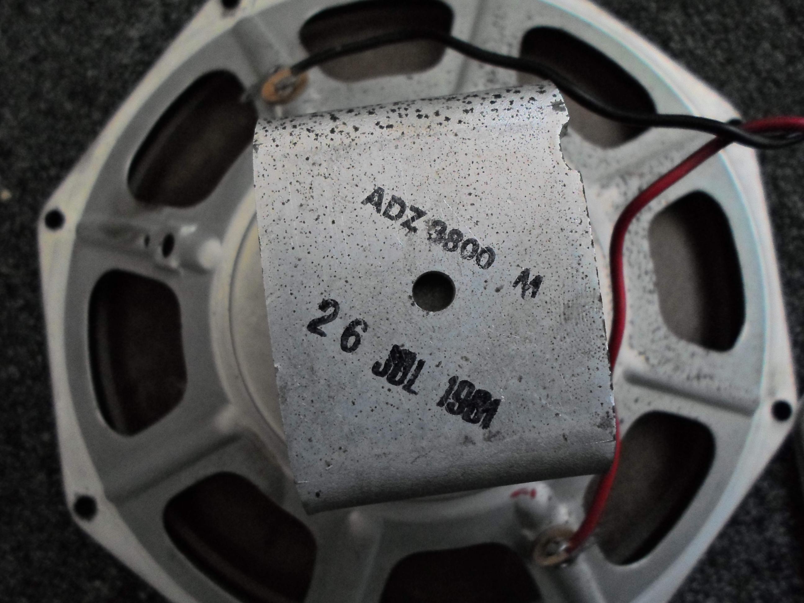

If believe the 800 ohm speakers has an "A" in the part no, like AD9710 AM which is an 8" with 800 ohm coil while AD9710 M is the same speaker with 8 ohm coil, as far as I can see while checking on the net it seems to be same for other Philips drivers, (an A is equal to 800ohm). So your drivers are probably not 800 ohm

i just tested the speakers through my 60's SS guitar amp and they work and sound really well so it wasnt a total waste. cheers for the link
