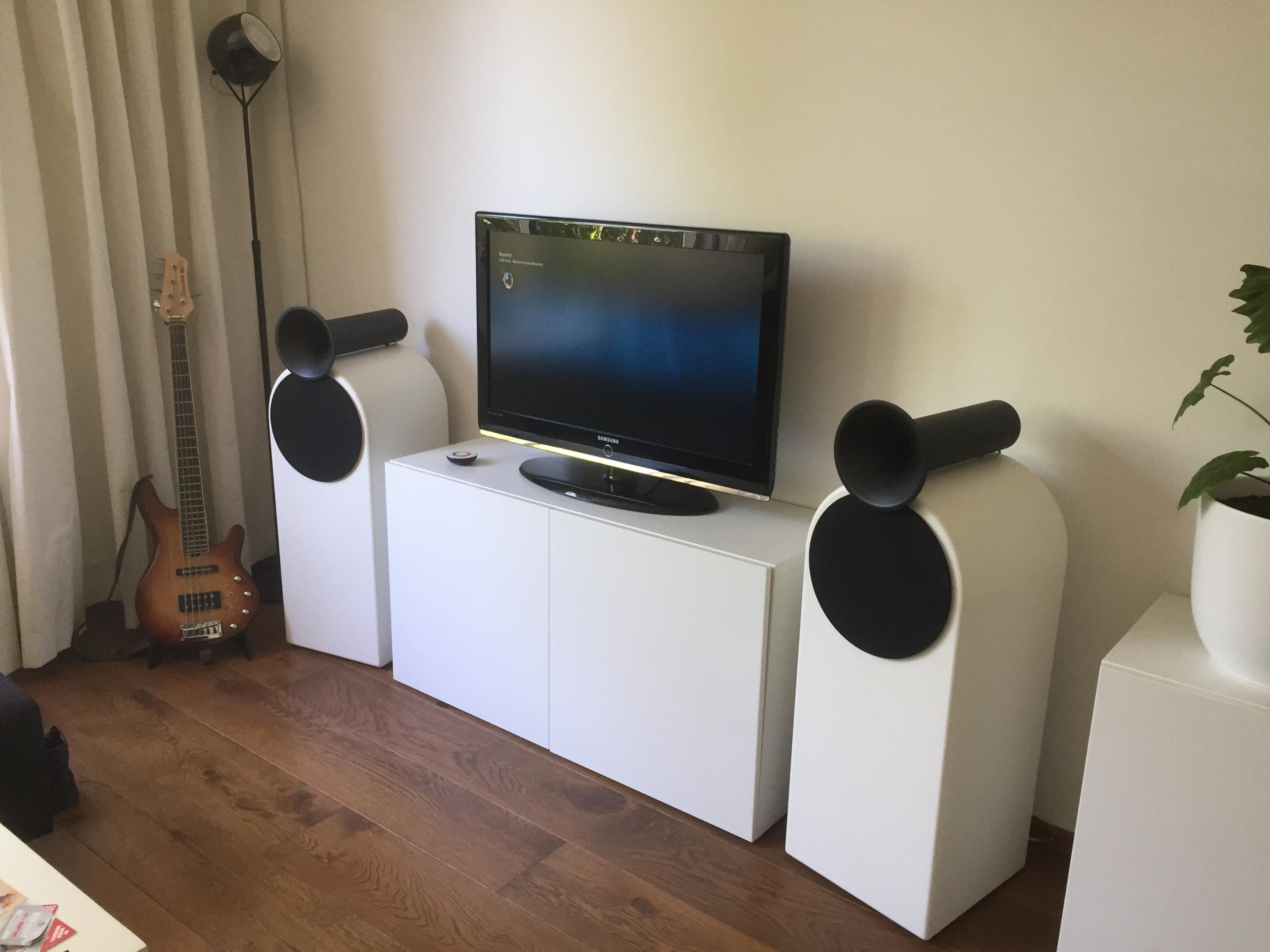

This thread will be to showcase my prestige project with a few old Philips drivers. It is an ode to Piet Gouw, who was the productmanager at Philips in the 70's and 80's, he was also responsible for the launch of the Motional Feed Back loudspeaker back then.
The drivers in question are the AD12100/M8 and the AD0160/T4, classic drivers for sure!
It all started about 10 years ago and I had several ideas about what to do with these drivers, you can read some of it in this old thread.
Brutus: concept with vintage Philips drivers
So, last year I finally finished the project and all I can say is that it's the best sounding system I've designed / build to date.
Below a few pictures of my setup, these pups are running for a year now and I'm still amazed at how dynamic and lively they sound. The amp I use is a small hybrid amp from Dynavox, the VR-307BT, it's only 25 watts per channel but it's more then enough to drive these loudspeakers which have an efficiency of approx. 93dB w/mtr.
More on the build and measurements on a follow up post 😎

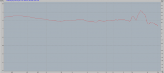

Below is the response from 300hz - 20khz (1mtr/15-degrees off-axis (tweeter axis))
There is a slight bump between 300hz - 1khz, I could have reduced that by adding additional components but my "ears" didn't notice it during listening.
The mids (1 - 9khz) are a straight line, nothing to complain here. Listening tests show that voices and acoustic instruments sound very life like.
The peak at 13khz was audible, hihats and crashes could sound a bit to forward, the decay diagram showed that this peak wasn't that bad because there was no real ringing visible. Still, I added the LC in series with the tweeter to remove the bump wich made the high-end less forward and more smooth and transparant.
