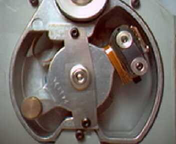

What lens is the Krell above using?
The Marantz CD 85, Philips CD 880 and Cambridge Audio CD 3 all use this lens. It does not look like a CDM 4 Pro.

Hello Prometheus, Purer,
Marantz CD 85, Philips CD 880 have Cdm1 mkII. Apparently this Krell too.🙂
Ward
