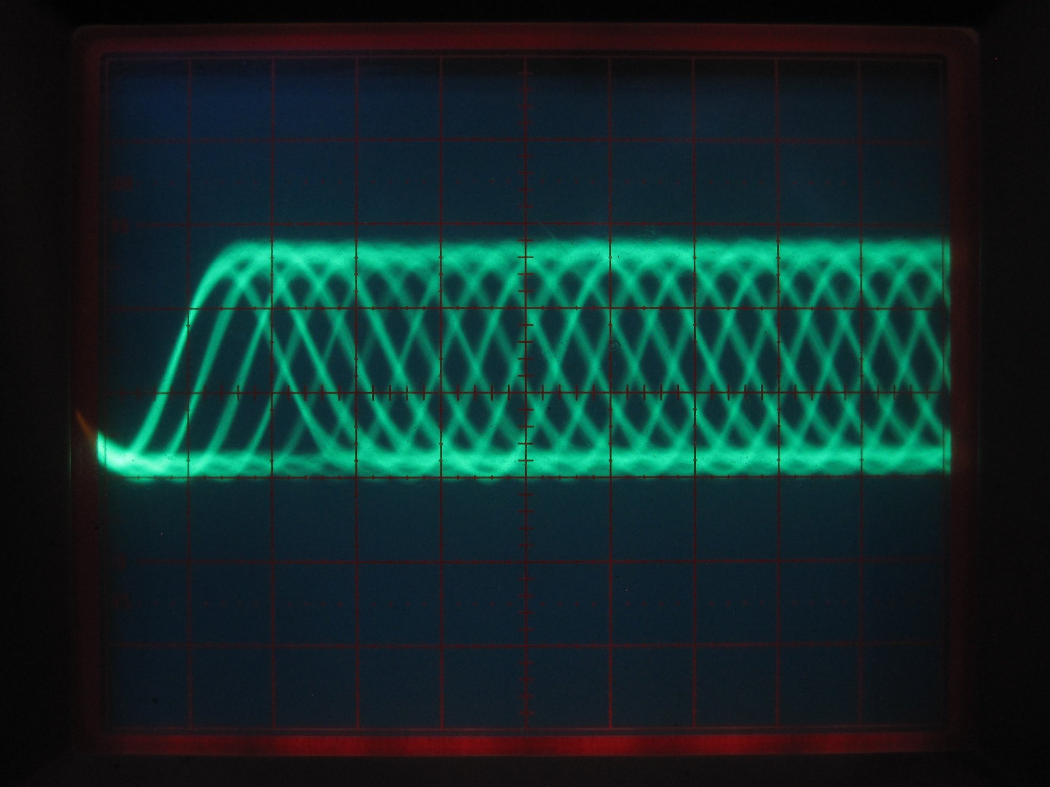

Regarding laser weakness, so far all of the units I've tested except one showed a measured laser current between 35mA and 37mA after warmup of a minute or so. One unit measured 55mA, which suggests that its laser is quite weak and the feedback diode is commanding extra current in order to maintain the desired light output level. Even this 55mA unit still reads discs perfectly, but I pulled it from use as a preventive measure and will keep it for test purposes and to help in the development of test equipment and jigs for further CDM-12 optical block investigations.
I'll share more info and pictures as this goes along. So far, I'm just happy I've brought a pile of completely dead CD players back to rock-solid operation without needing to source new pickups of questionable quality.
A quick teaser of RFE from pin-9 of the TDA1300 photodiode amplifier chip. This was after peaking the output by rotation of the LDGU. I have seen better RF waveforms, but certainly also far worse. There was noticeable low-frequency amplitude dropout which is often due to issues with the motor, disc clamp, or suspension; in the case of this unit, it was wear/dryness of the upper spindle motor bearing. A drop of oil on the motor bearing entirely eliminated the pattern error; at low sweep rate there is almost no low-frequency amplitude error, just how it should be.

You can easily check the laser current by measuring the voltage across the 6R8 resistor on the flex PCB. It is the emitter resistor for the transistor whose collector drives the laser diode. So the current through this resistor will be very close to the diode current. The 6R8 resistor is the large one next to the laser power adjustment potentiometer as you can see in the photo below. Setting the laser power correctly probably requires a laser power meter (Leader LPM-8000 or equivalent) and knowledge of the correct power setting. Unfortunately, I have neither. Anyone know the correct laser power for a CDM12?
I was able to do the suspension arm swap and LDGU cleaning per Duo's suggestion on my Philips CD920's CDM 12. It went from no-focus, no spin to spinning up, but now it shows a Radial Error 10 in Test Mode 1. Since it uses the optics to tell if a CD is loaded and enable spin-up, this tells me that the laser is not totally dead. Anyone have ideas for the cause of a radial error?
