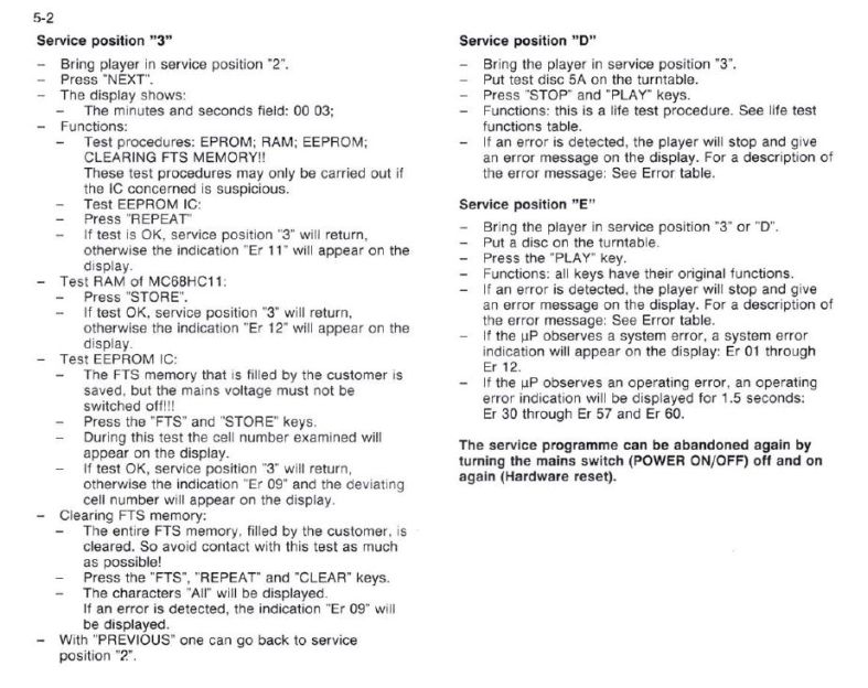

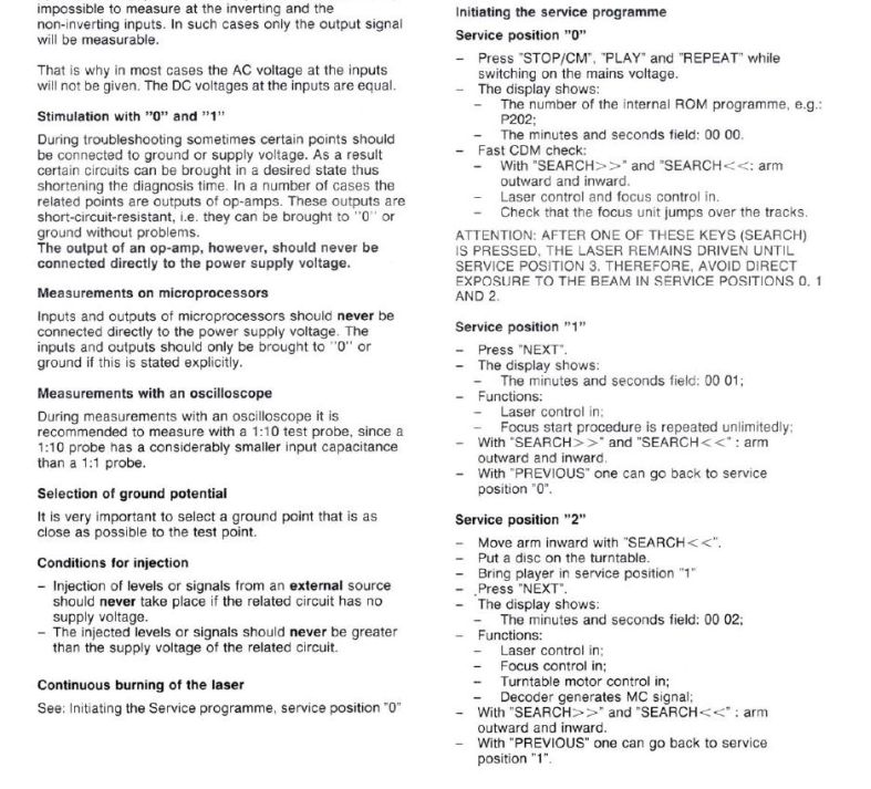

I suggest you put this player into service mode. It the first service mode (SM0) you can force the arm to move back and forth using the search keys, this will tell you conclusively whether or not the radial motor is working. Also, you can get the player to display an error code. This will let you know whether the player is failing to focus or failing to read a ToC, two very different things.

the latter, there seems to be a balance bias to the centre position. I'll try some of the test I didn't know about tomorrow. I got an error 02 doing something😕
