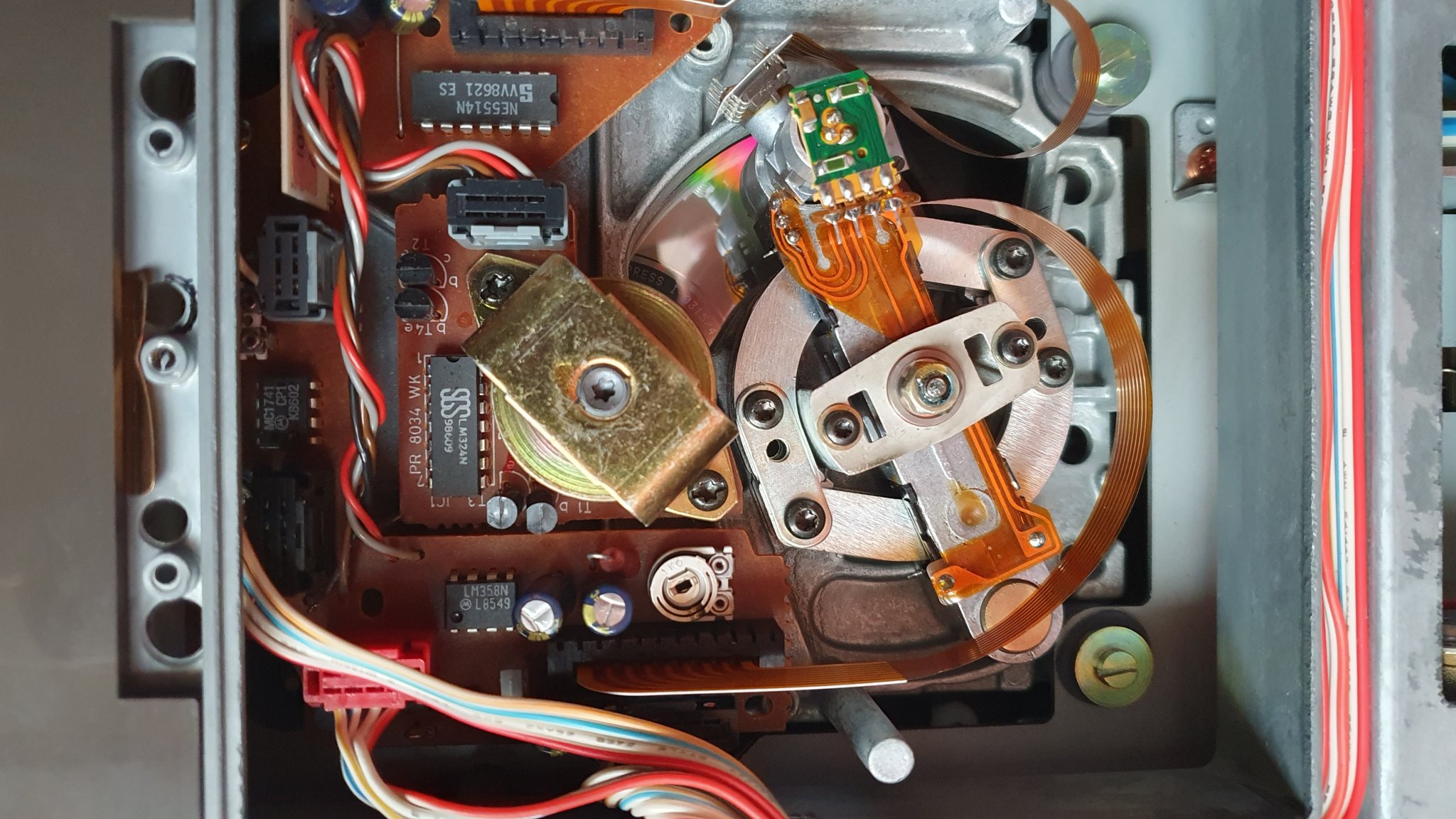

I have a Marantz CD-94 CD-player with CDM-1 optical unit. When I checked the laser current setting according to the service manual wich should be 575 mV +/-75 mV to GND at the test point (Q315 emitter), I found that it is only 260 mV.
The eye pattern is also blurred and there are occassional dropouts. The amplitude is about 1 Vpp.
Is it safe to readjust the laser current? I haven't touched it as long as this player is with me.

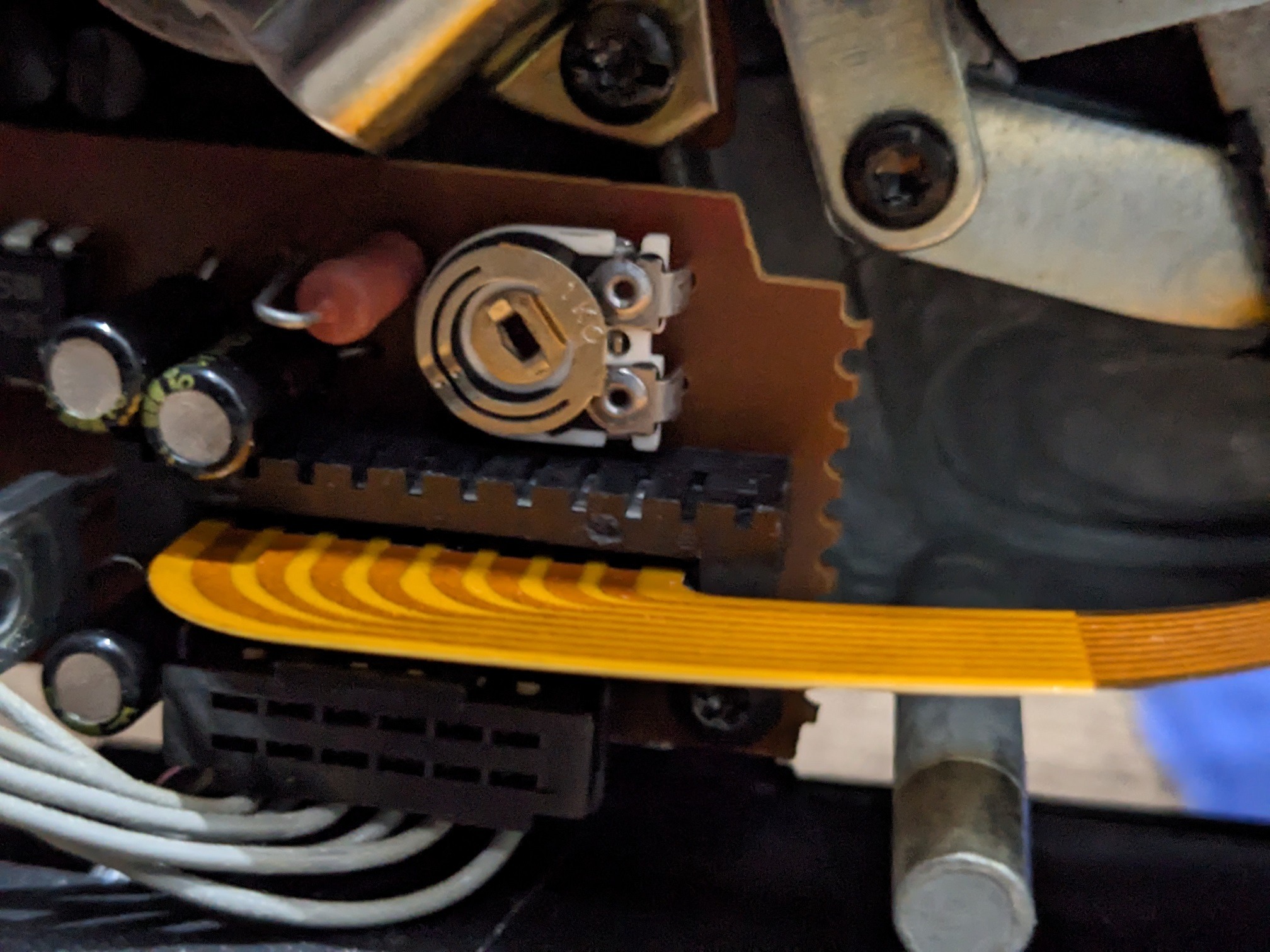

Is the pot itself ok? Dirty? Make sure the cap you used in the servo is very low ESR.
Clean lens it affect the MV. Adjust the screw under the motor it affect MV. Both of these affect eye pattern!

Your setting is very low. It should not drift that much. I measured mine before and after recap maybe 50-100MV difference. Yours is very low. Maybe accidentially hit?
I just use a good factory CD, solder wires across that resistor on the PCB on top of CD player and slowly adjust the pot (closes to ribbon cable) and measure and adjust and measure again. I do it in steps as its difficult to adjust and meaure at the same time. I set mine to around 500MV

I think the eye pattern has to do with the height of the turntable motor (spindle). I don't understand the whole 1.2Vpp part sorry. I'm not that technical.
If its noisy or bad its probably the height of the motor. Check it first and fix that and fit it back just to allow you to continue your testing. You will know if its a good height as the tracks will work at begining and end perfectly and not skip.
You can set the laser strength first as it doesnt need tweaking afterwards, then do the height adjustment to get it perfect (after you took it out and checked it first). I checked the eye pettern on my cope and there was very little change when it was higher or lower but there is a "sweet" spot. You will know it when you keep changing tracks. Note also the speed of the track changes etc its a good indication of the sweet spot.

The RF or Eye Pattern level is directly related to the optical output of the laser and the nominal 1.2 volt peak to peak level of the recovered signal from the photodiode array. At this point it is an analogue signal. The stages that process the RF are designed to operate with this nominal 1.2 volts pk/pk input signal and the first stage is a 'data slicer' (like a comparator) that converts the analogue transitions into a data stream of 1's and 0's. That data slicer works on this nominal 1.2 volts pk/pk analogue input level.
Altering the turntable height alters the 'fixed' bias voltage needed to bring the lens into focus on the disc. If you raise the height then the bias voltage needed is less and vice versa. This 'fixed' bias voltage is still modulated as necessary to track the moving disc. The height should be correct to ensure the lens is operating in the correct mechanical region of the lens suspension assembly.
I adjusted the turntable height with the motor supporting Torxx screw so that the FOC- signal is around 0 Volts checked on an oscilloscope. The laser current adjustment range is up to 450 mV on the test point. It is at the upper limit of the adjustment varable resistor. Now I get 1.2 Vpp, but it is still noisy. I wiil check if it plays without dropouts now.

Have you chekced the main transistor that gets hot on the laser pcb? Or the resistor (red one). It seems somehow you have low voltage.
Definitely some issue and not so much related to laser alignment.

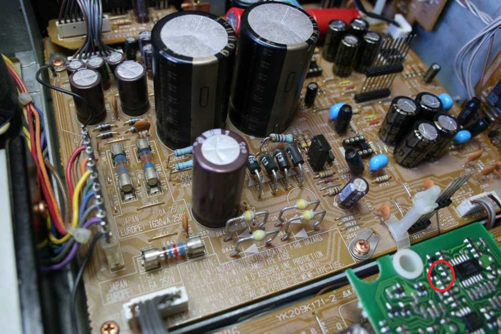

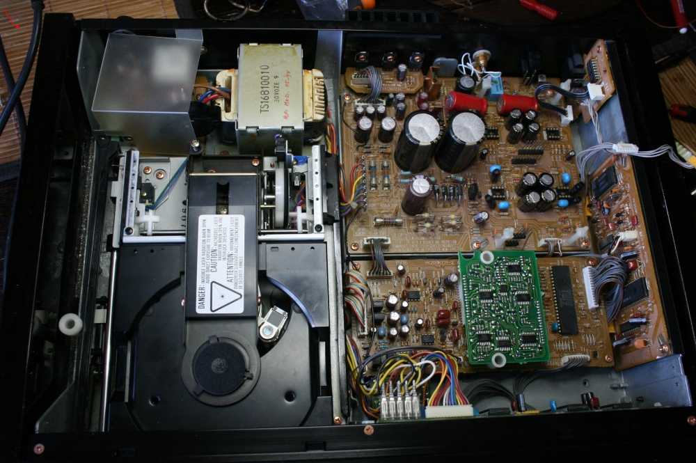

The SM says on page 10 Fine adjustment of laser current that 575 mV should be measured on the resistor 3308 on the Servo PCB. The issue is that there is no such resistor on the Servo PCB or anywhere else. But! The Philips CD304 Mk II has it. Compared the circuit diagrams, the test point on the CD-94 must be TP35 that is R309 connected to emitter of Q315. The circuits are more or less identical. This part of the servo is somehow related to radial error correcion. It is not clear for me, what has the laser current to do with radial error.
I got the image from online. Look at the green PCB, I found mine mine on the green PCB by the top white platic hole. Its a very small resistor. I measured that and set my voltage for laser
literally in the red circle
