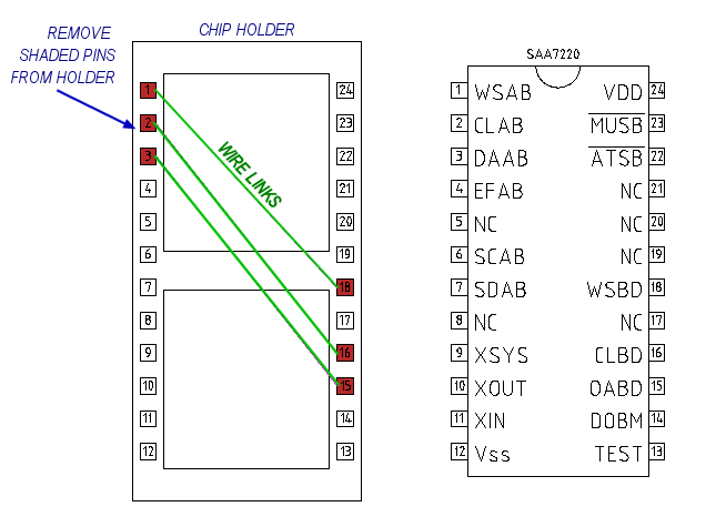

I just picked up a minty CDB-630 for $25. Many lists show it with a TDA1541, but it actually has the A version, made in '89. The transport, especially the gear that seems to wear out, is in great shape. The circuit board is the simple Philips/Marantz variety common to many units. I'd like to mod the DAC to make it unfiltered zero oversampling. I know some of you will recommend I keep a filter on it, but I'm want to go the minimalist 47 labs route.
I've been doing some searching, and have found a few methods and a bunch of outdated links. I've seen the mod where you cut a few traces and make some jumpers. I've heard about mods where you remove the 7220 chip, bend some leads, bridge some others, and put it back. I've heard folks mention removing the 7220 all together.
What is the best method? I have done some soldering (built a chip amp) etc, but working with little traces worries me a bit. I don't have a soldering station, and I destroyed my Sonic Impact. I think I can pull most anything off, but easier is better. Cheaper is good to. Also, I've downloaded the Marantz CD50 service manual, which I believe shares the same board. I do understand schematics a bit, but I am by no means fluent in circuits.

I was hesitant to drill holes in the board, but I as I think about it, it seems easier than completely removing (bending pins, then replacing) the 7220.

You can install the socket and do it this way.
