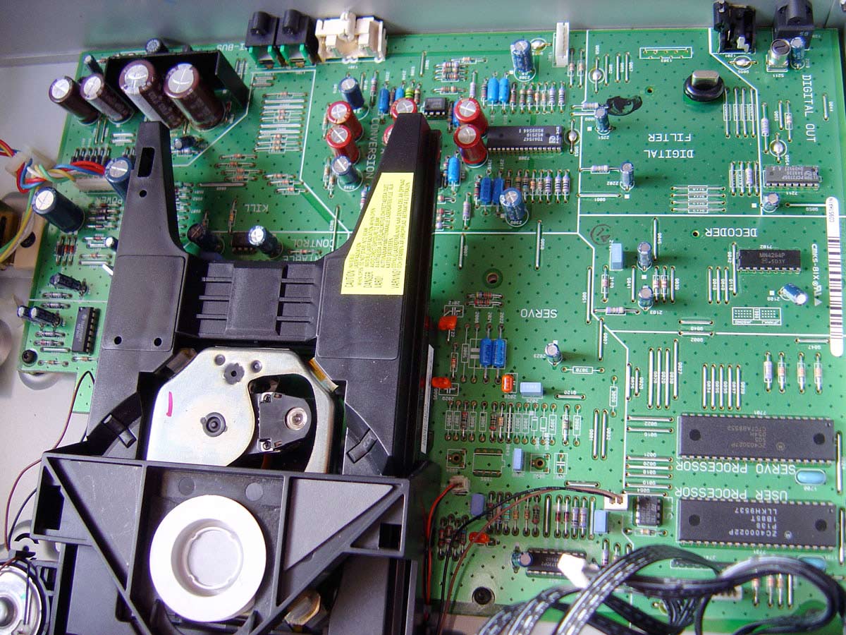

Hello there,
I've been given a Philips CD951, CDM9/65 mech and TDA1547. (Thanks again Jan).
The mech is hold as a good one (it plays CDR-W wich is nice), the TDA1547, with its decoder and filter on separated ICs, is great on paper and specs, sounded nice in some good stuff.
My aim, wich will tell how much and how I'll go, is to compare it to my soon to be rebuilt Marantz CD-53 (check the huge thread about Marantz CD-63 mods) and a Xmas gift wich will be a familly unused Marantz CD-40 with a CDM4 and TDA1541A R1 DAC.
I need only one good player, will try to get the best from these 3 guys and get away the 2 loosers to my ears. And the CD951 can do a good transport seems, even if right now an integrated CDP is all I want.
As for now, virgin CD951 but some years old (caps dead?), it's heavier than my CD-53, bigger (nice headroom for adding stuff), at first I tought the front panel was plastic but no, Philips made the aluminium front looks like plastic...
Inside, it's like they applied the Special Edition treatment from Marantz to the CD950: Cerafine aoround opamps and DAC. The caps on other ICs are so small... they deserve to leak in peace. Opamps are JRC bugs. The top lid is a bit dempened and the TX humms... bad news. And last thing they've discarded the 2 lines dot display from 940 for a single line one under the large screen.
The sound, compared to my CD-53 (state of the CD-53 right now, smoothing caps @ opamp PSU, PFM Flea clock on clean test-board, Servo reclocked from /2 Flea, Regulated drivers and Rubycon ZLH caps around digital ICs, analog stage still factory but 6.8µF MKP and removed transistors).
Stock CD-53 is warm but dull (boomy in fact) and in the right now state more open and clearer than the Philips but the main point is the lack of the half down (again, compared to the CD-53 as modded now) the lack of bass and mids. Or too bright if you want, with maybe clearer highs than the CD-53.
But it's a bit unfair as it still features cheap lytics as DC blocking caps, tiny decoupling caps and such nasty things.
First step, I can free the standard sound with LM4562 or OPA2132, fit 470/35 or 220/50 Rubycon ZLH at ICs but the DAC (or the DAC?), try to use bigger standard caps (from the CD-53 removal) in the PS and bypass here and there with 1µ MKS, maybe 4x MBR1100TR schottky left and MKP caps for the output. It should already sing more.
And then we'll go for real work (unless I really don't like the cheap mods I'll try tomorrow),

Yesterday in test purpose I've tuned it on for hours but had the opportunity to listen to it later. It was warm, but when pressed play aid a couple of time error. Some more press and it was OK. I thought it was an RC problem as it was another one... but in fact that was stupid as it worked fine sometimes and with the Marantz.
But today, after opamp changed and many caps changed for bigger (that's all) it refuse to turn the disc, it spins backward en a bit normal but "error" or "loading" messages. I've checked the flex ribbbon a couple of times without success.
I don't know where to check and I'm not familiar at all with the pcb, a bit lost.
Maybe bigger caps can harm there??? Sounds strange anyway...

Bigger caps shouldn't hurt, as long as you stay in the 2x or 3x range...... Maybe you shorted something with some solder? 😕
Fixed!
Stupid at iron... I've seen a small cap at 2107... 2.2µF not for supply, changed it for a 470/35 😀 back to 2.2 it works just fine! Will change this to film.
