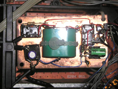

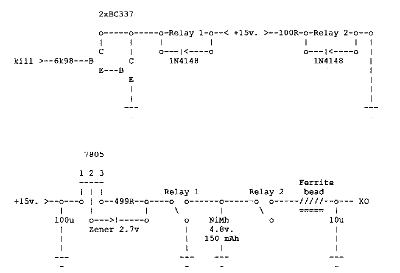

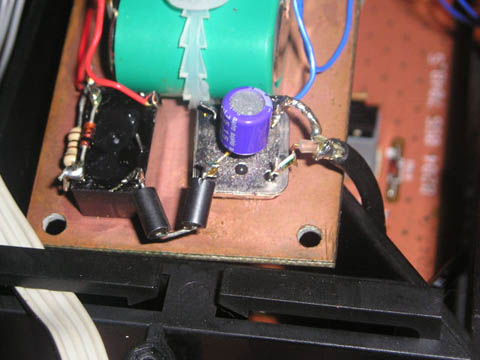

Peng said:Roberto(RR- who was also so kind to send me the schematics) has put in a tent clock fed by battey with a charger relay. I'm interested to see how he implemented this in the 850.
Hello Peter,
I've found an ASCII esch. from an old email (weird). I hope it's clear enough.
The circuit needs connections to a +15v supply, chosen because there are one line spare from the original op-amps, now unused.
The kill signal (~3v) connects the charger to the battery when no music sounds through relay 1. Relay 2 disconnects the battery from the XO on power down.
The 7805 regulator is configured as a current source, that brings (5v+2.7v)/499R = 15mA. Given that the XO uses 10mA, you end with a charge of 5mA, that should be safe for the battery and keep it charged with normal use of the player.
Now I would delete the zener, and change charge resistor accordingly (I blindly copied an elektor sch. then), and maybe increase the charge current. If someone could suggest ideal values it would be great.
Roberto

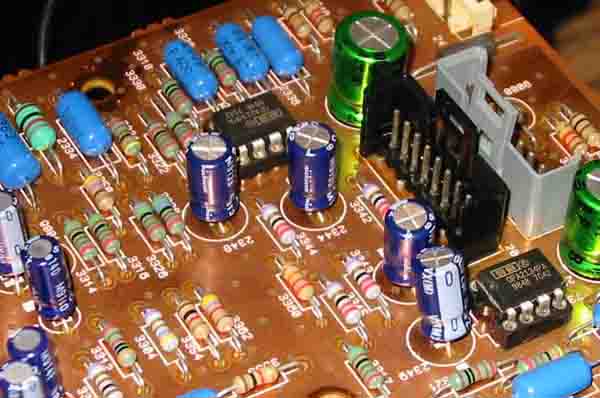

Some small changes.
I changed the headphone chip from JRC4559D to an OPA2134. There is improvement in voice and the hf and transients. I am not so sure about the bass. But surely it was an improvement. I use a HD580 , 600 ohm headphone. For low impedance phones like 150 ohms I think the OPA2134 is OK. Lower that that you will have to check it out. I put a socket in place so that I can try other chips or defeat the phones output altogether.
The main output is through two OPA2134's. The sound was compared to a TDA1541 with tube output.
It is quite good. Bass is not the same. Transient drums do not have as much bite ( not as meaty ) as the TDA. Voice is good and Hf is good but a bit light weight ! Guitar strings seem to lack body as compared to the TDA.
I will have to try tubes and bypass the existing filters and capacitors. Mute transistors will have to go and be replaced by a relay. This Cd player is really great for tweaking ! Lots of things that one can try out.
Cheers.
The picture shows the OPA2134 in the line output stage. Note the machined sockets.
