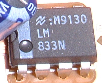

cartman said:What is the recommended OPA instead of LM833N ?
Please advice!
thx!
