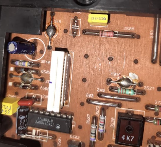

Attached the image of R3501 which is shorted labelled 248 in PCB.
The 104k R3502 resistor is a SMD resistor mounted on the rear end of the PCB.
Yes, but a SMD resistor with 104 on it, has a value of 100k... ;-)
The SMD resistor though measured 104k in the multimeter.
Any pointers on how the laser current can adjusted with the short in resistor discussed above ?
