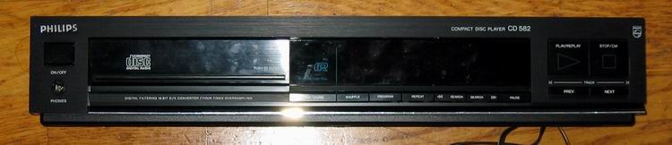

Just picked up a CD582 at the local seconhand-shop....
CDM4.19 + TDA1541A...
So I will give it a go, to see what you guys rave about
But a schematics would help speeding up things....

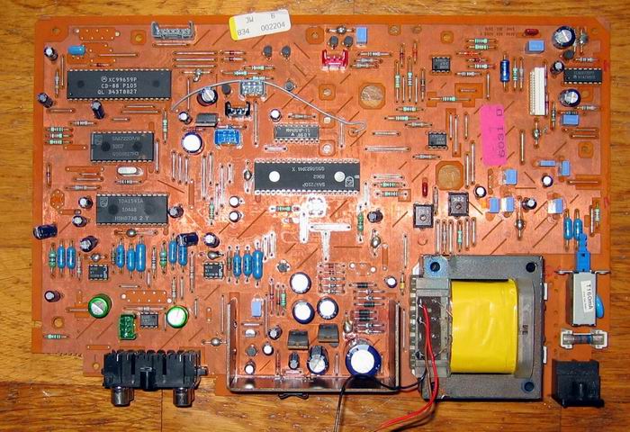

BTW the mainboard you showed is a commonly used PCB in most of the standard types of that series. Marantz CD65 has the same board for instance. Please remove the opamps that's in between the MUSE output caps ( headphone amp ). Replace all caps and wire it for 240 V instead 220 V. The transformer has 240 V windings. You can also change the blue KP caps in the filter section for styroflex types. The ones that are used now are magnetic/ferro types. Remove the muting transistors, they have a bad influence on the sound quality. Be sure to shield the plastic case as they are made of plastic and these cdplayers radiate some RF. When the bottom of the case is sandwiched with a 2 or 3 mm metal sheet it will benefit from it. I once used stainless steel and that one sounded very good.

Maybe I will try that. And remove the headphone op-amp, no need for that.
Have trouble locating the mute transistors, as there are at-least 6 smd units under the board...maybe only aditional de-empasing?
(Then they all can go...)
Arne K

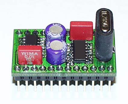

Arne,
Remove the TDA1541 and everything downstream of it.
(SAA7220, opamps, muting etc.)
Stick that little TDA1543 board I sent you in this player and report back...I think you will think differently about the "bad" quality of these players. 😀

On the CD582, only the LM833 are for the output, change to your favourite flavour dual op-amp. And change the two electrolytic DC-blocking caps for something better, or at-least bypass them with a film-cap. The mute-transistors are SMD, underside.
The last op-amp is for headphone, and is pretty useless, as this player has no volume-level for this. Remove it.
