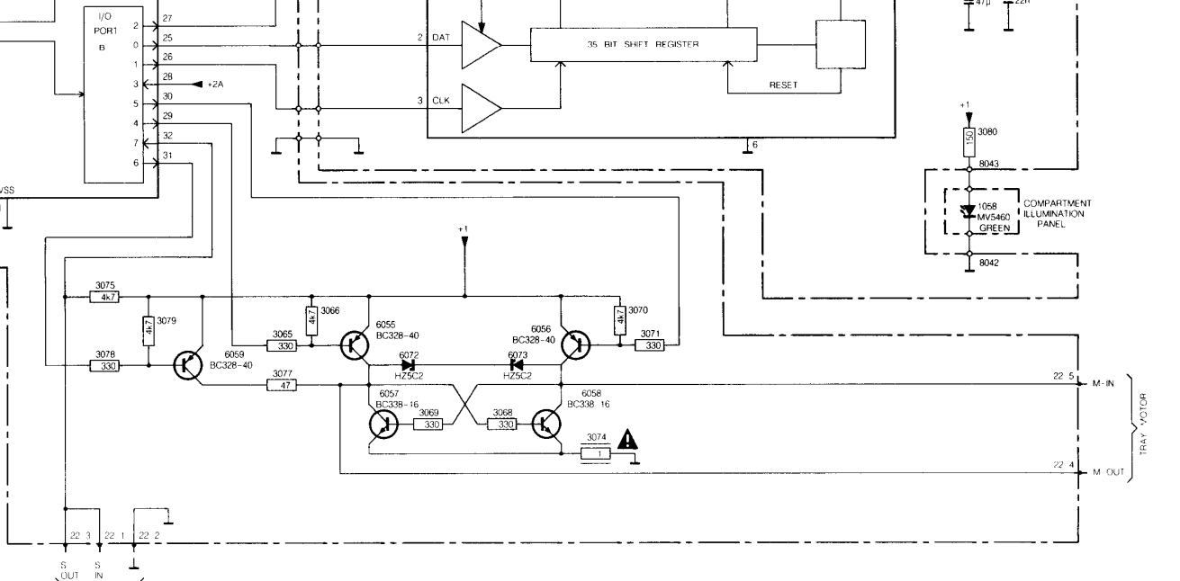

So yesterday it just refused to open the CD tray. I opened the chassis and started helping it even more (pushing the wheel etc). Sometimes it helped a bit sometimes not.
Again closing no issue whatsoever. I googled a bit. Seems like people advise to replace the tray belt (still if the belt were bad why would it close nicely?).
Anyway I have another Cd160 which seems to be exactly the same player as CD460 but in a smaller box. Even the PCB is the same - the interior of CD460 has more voids which can be filled with my stuff.
The CD160 opens and closes nicely. I thought first I would take the belt from cd160. Then I though why not the whole drive with servo and all.
So that is what I did. And it behaves exactly the same in the CD460 body as the other drive. Put it back to 160 and everything is fine.
Has anybody any clues?
Not much time today, but my limited electronic knowledge tells me that something went wrong with the buffers supplying voltage to M-OUT (tray out I presume). My bet is on transistor 6057 or 6058.
