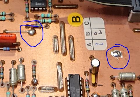

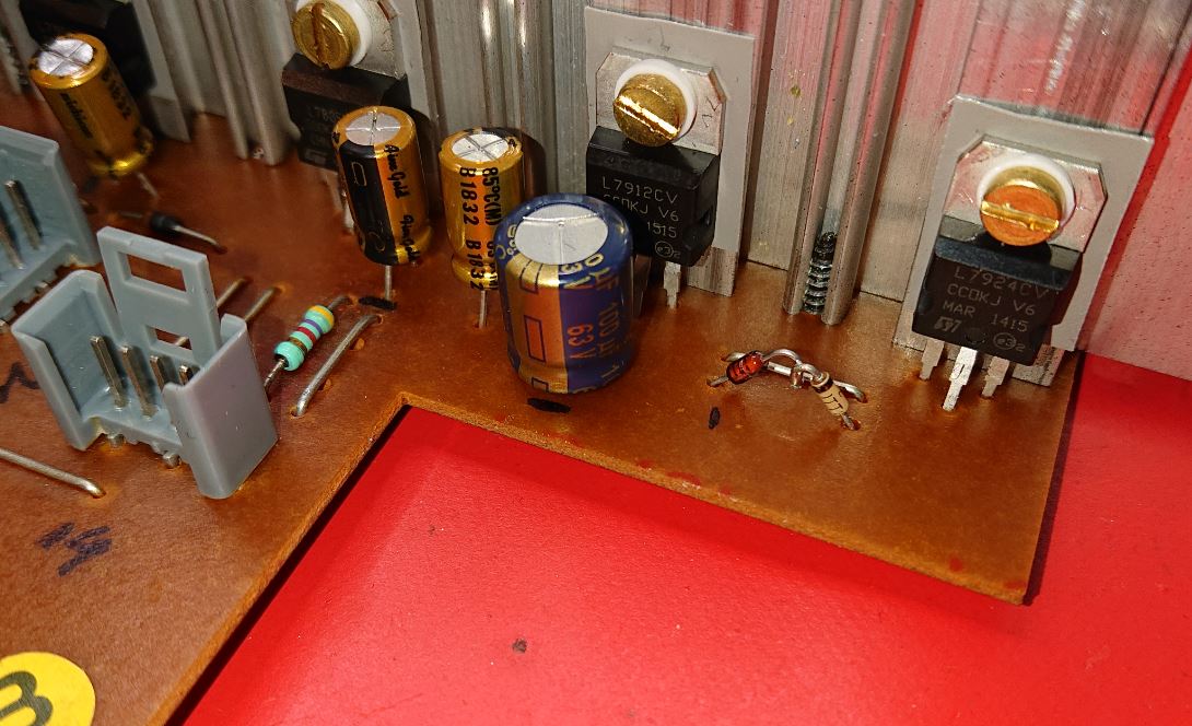

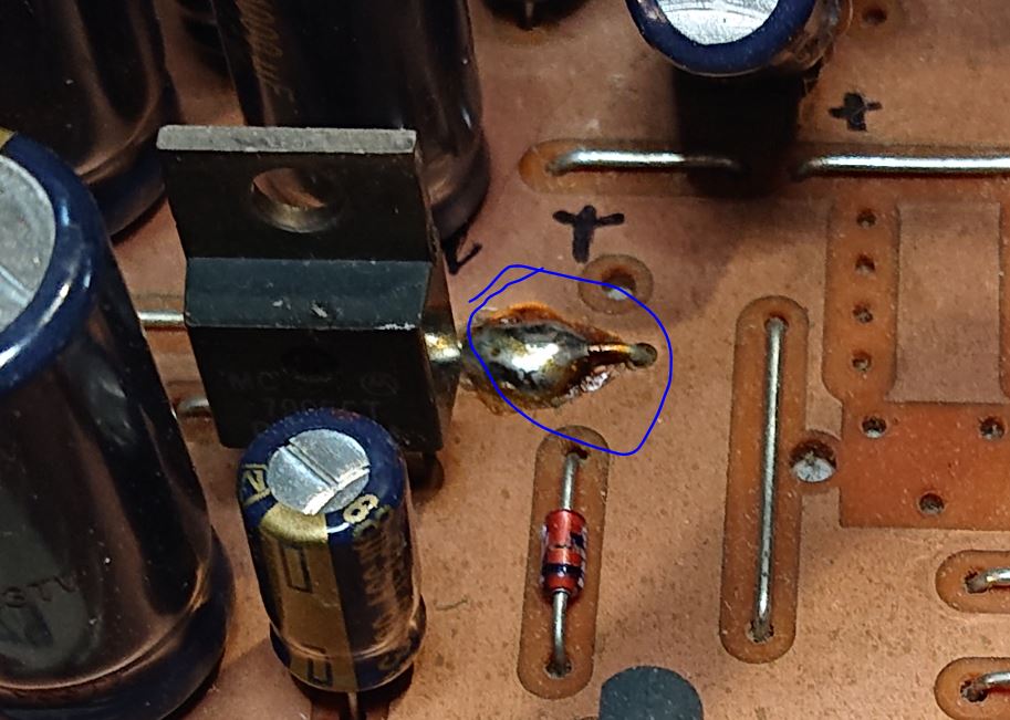

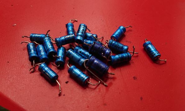

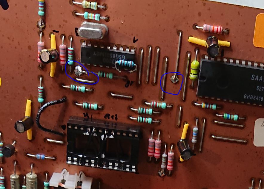

I've reworked several Philips CD over the years, and in particular the 304 MKI and II show the same illness after a time. Besides the blue caps (I recommend Panasonic FA and/or Elna Silmic, throw the blue stuff far away) the culprit often is the connection between upper and lower side. Best is to put a piece of blank wire through the hole and resolder it on both sides.
When you take this old guy apart, it's the perfect time to replace especially the 5V regulator with a 2A-type, as the original one's running on the edge. Servo-and Laser-current should be adjusted after replacing all caps and regulators. Clean all trimmers before re-adjusting or just replace with new ones.
BTW: never found a failure on the 4385 🙄 flying wires going through the chassis.
Some pictures below (including NOS-conversion)
