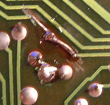

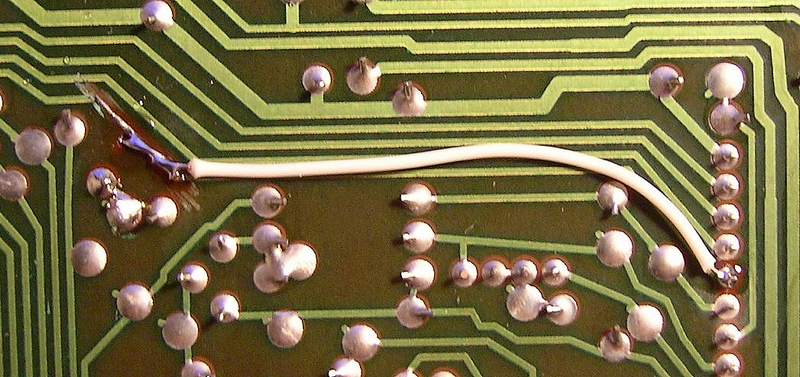

Hi!
I have dissasembled the servo and the decoder board for strenghten some solder joint. I have found a broken part on the decoder board. It was soldered (maybe in service) above.
I have patched this soldering.
Then i have reassembled the parts, and the player read the TOC, and play the first tracks. But after the 7.-8. track i hear some high freq noise from laser unit (not from loudspeaker). After few seconds the sound being disorted, then stopped.

Hi Makk,
from your description it sounds like the focus loop is too tight, at least the 'ringing' I heard when adjusting the focus ofset on my laser drive made a sound like you describe, near thew end of one particular CD (a CDR).
Please check with a variety of discs, it may be just one specimen that is out of tolerance.
But before you race out and turn potentiometers, I would offer that electronic units don't go out of adjusment suddenly, so the focus ofset problem is probably the result of some other failed part. I would suggest turning your attention to the focus and radial control (Rafoc) part of the board. This is on the servo board, just look for the series of wires that go to the laser unit and work your way back into the board.

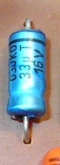

Yes Makk,
the little blue capacitors are the ones. Most are marked 33 uf, some are 22uf, voltages vary but they are marked also. Just use same voltage or higher, and care about polarity - but you probably know this.
The 22uf are more likely on the decode board, and look slightly different, with both wires comming out of the same end (radial) unlike the ones you pictured (axial).
Include all boards in your renewing of capacitors, including the laser board (there are 3 or four there, from memory). The ribon connector just pulls out of the plugs, do this firmly but gently. Make sure you 'earth' yourself before, so as not to damage the chips with electrostatic charge. (Otherwise everithing is over).:bawling:
The silver capacitors are less likely to be problematic, and should not be candidates for blanked replacement. Having said that, it was exactly one of those that failed in my CD200 :cannotbe:
