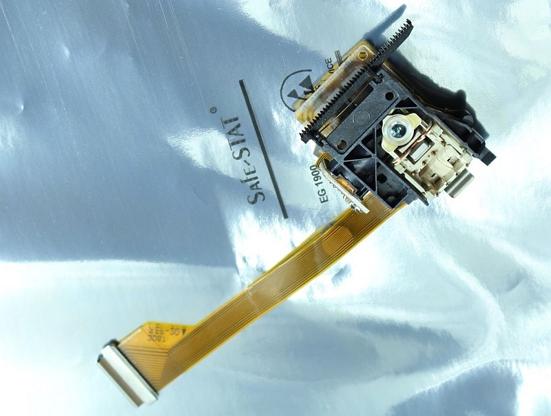

He says it the Laser only, no mech, made by Rodenstock Germany for Phillips?
It could be as you said and I also think just a CMD 12.4 laser, but keeps it quiet for max profits.

Emailed him to send a pick, to see what I would getting, he sent this.
Looks very much like it's a CDM12.4.
CDM 12.4 - VAM1204 | Laser Pick-UP Unit | CDM 12.3 - VAM 1203 | NEW | Philips | eBay
Cheers George
Just to be sure, a flip side of the picture will be helpful...A TDA1302T part on the opposite side on the flexi-PCB will confirm it's a CDM12.4
