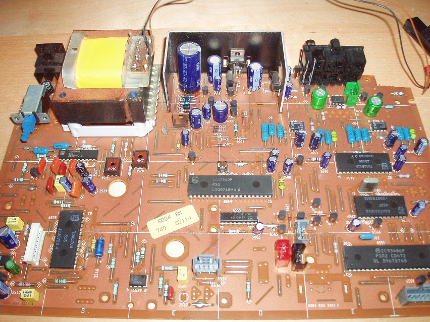

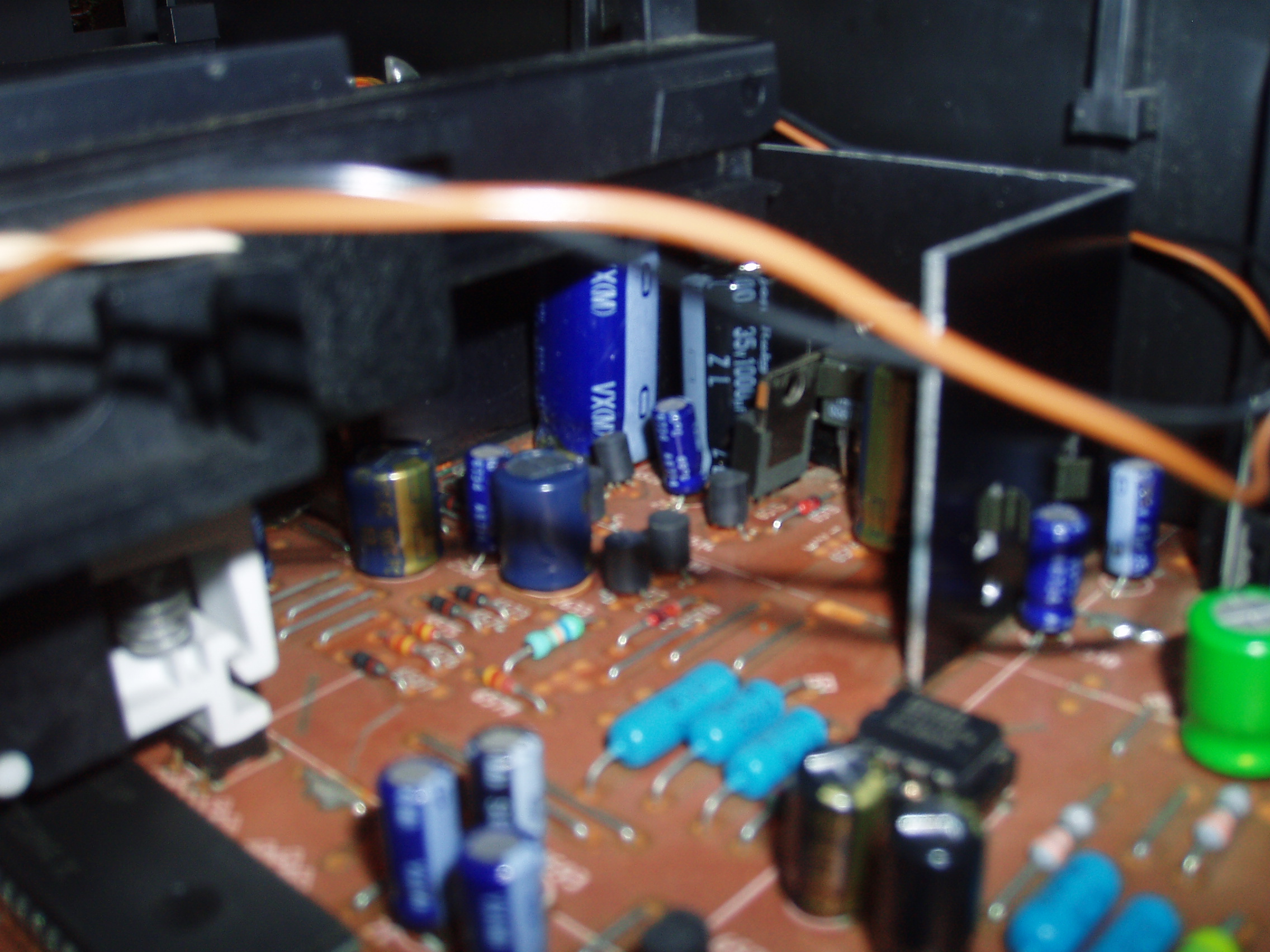

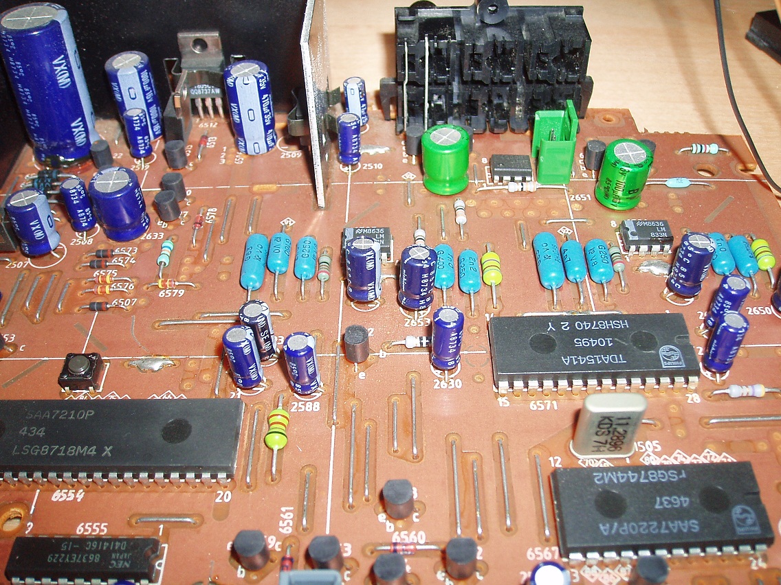

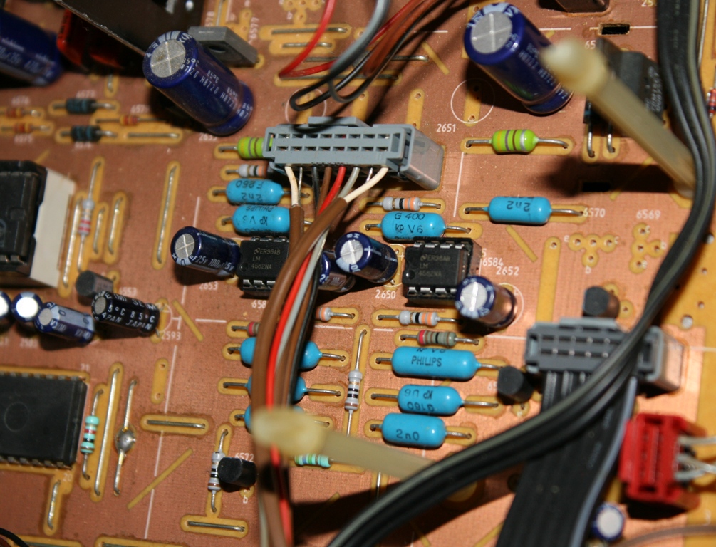

Here 2 pics of the player (standard)

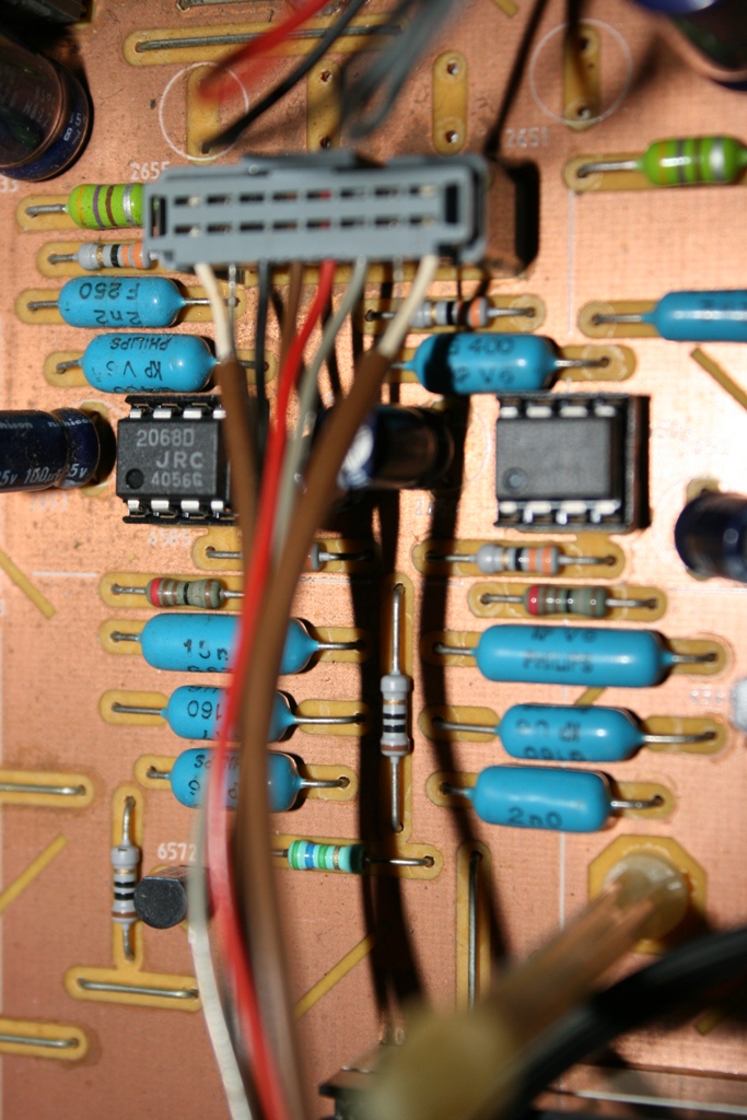

It sounds like you've covered the basic improvements pretty well, and the list you posted looks good, you're heading in the right direction. I have a few comments:

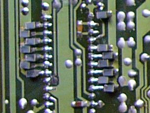

- Replacing the TDA1541A's many surface mount decoupling capacitors is worthwhile, they directly effect the sound, but not very dramatically. I recommend using polyphenylene sulphide (PPS) film capacitors, you can get these in 1206 and 1210 size package which will fit the PCB, much neater and more mechanically stable than tacking on leaded components. I've attach an image of this done on a TDA1541A based player.

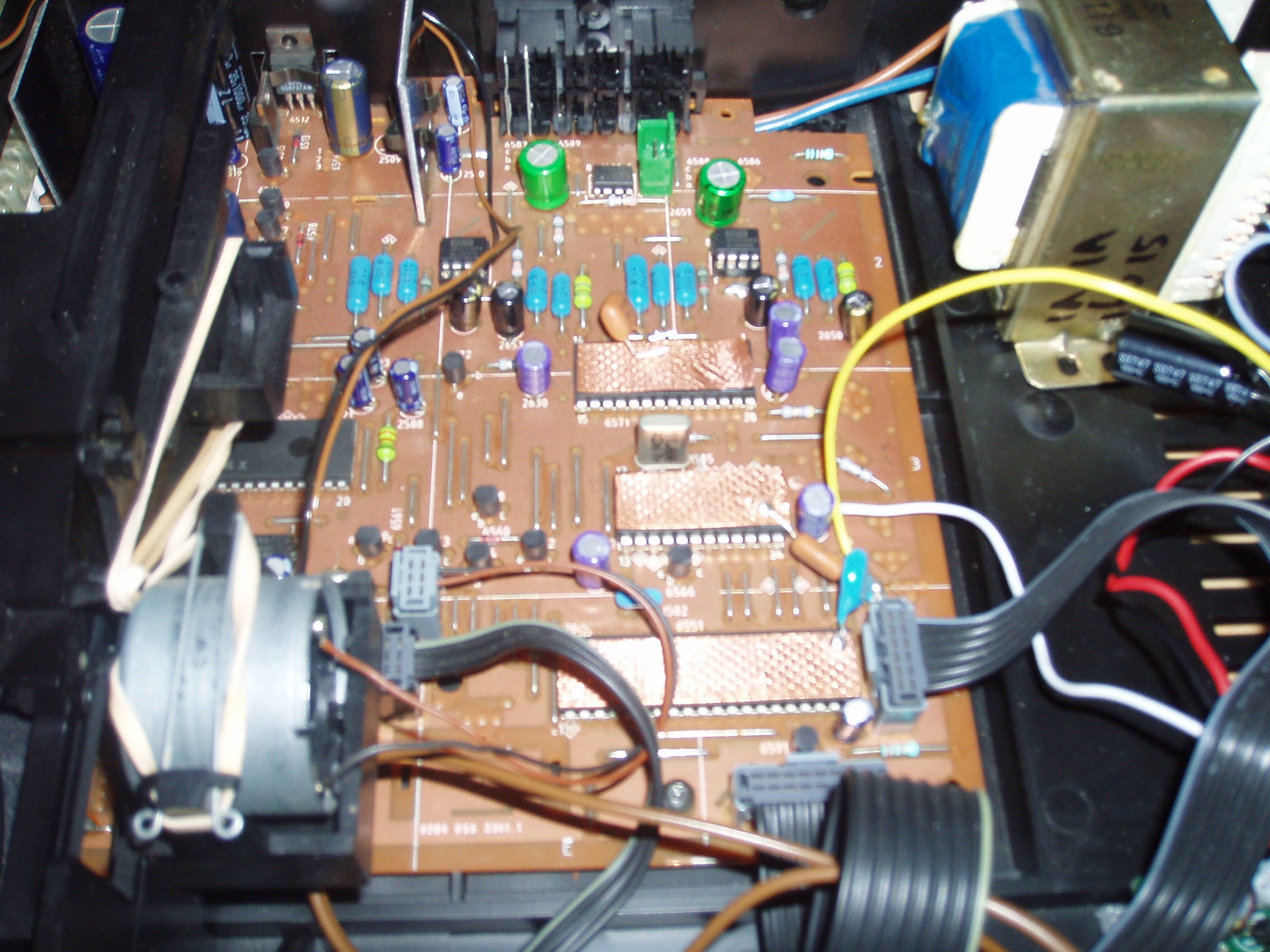

- If you install copper foil over the ICs, don't forget to couple it to ground. I'd connect them to the ground plane through low value ceramic capacitors.

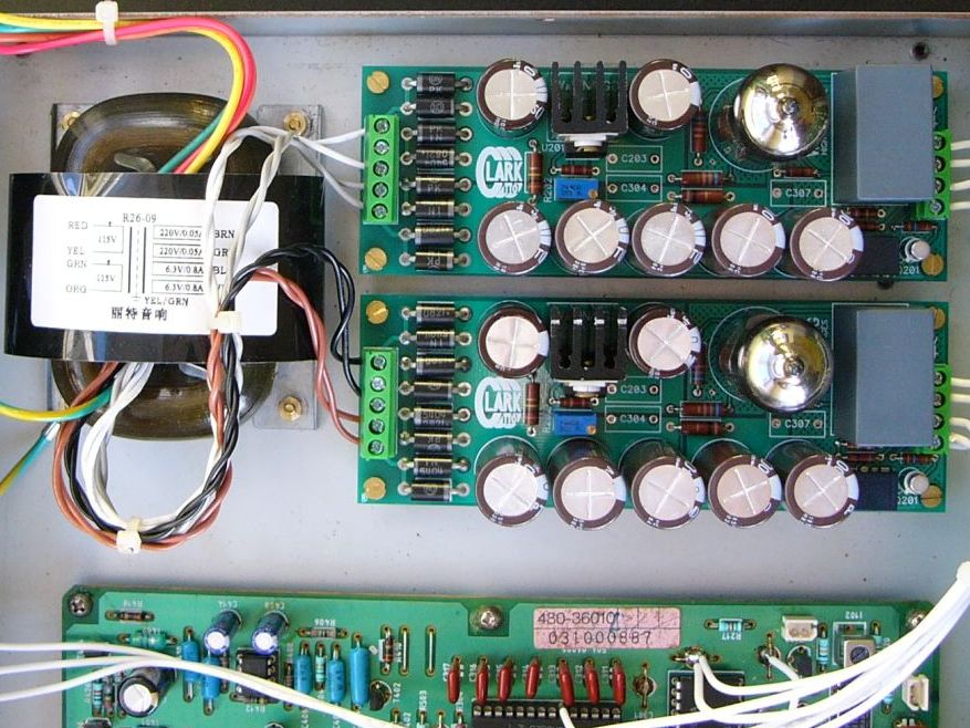

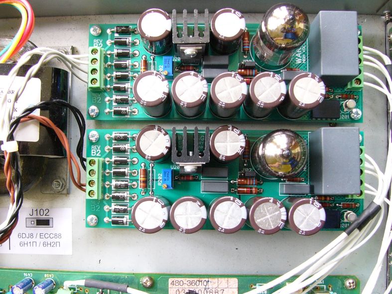

- Yet another thing to think about is alternative output stages. There are lots of designs out there, using vacuum tubes and discrete solid state. It's a big modification, a lot of time and effort is involved, but the results are very good. I've tried a tube output stage, and I was pretty happy (see attached image).

Thanks for your input!
I´ve got several wima mks caps for the tda decoupling, but they are to big.
The mainboard don´t fit anymore, the caps touching the bottom case. :bawling:
A solution is to saw a hole in the bottom at the place of the tda.
But these pps caps are a good replacement! What brand are they and sounds it better like wima,vishay, etc?
About the clock...i got also a shigaclone with a trichord clock 4 with psu (black gate caps). I can use this clock for a little test.
What value did you use for grounding the copper shield or isn't important?
I want to build several psu's (pre-regs) with super regs for feeding several chips like the saa7220p/b, tda1541A,saa7210,maybe the clock.
So i need the space in the player, because i want all the components in the player. It's probably imposable but i give it a try with several toroids (30va/50va).
PPS capacitors are really good, probably somewhere between MKT and MKP. They have both low leakage current, ESR, ESL and DF, so they're ideal for the application. Just keep an eye on the voltage rating. I used AVX made ones, but both Panasonic and Cornell Dubilier make them as well.
I don't think shielding the ICs is important at all, but just use whatever ceramic capacitors you have lying around.

As a matter of interest, what make are your tube buffers and where are they available ?
The tube buffers are my own design. I have a few PCBs and parts left over, PM me if you want to know more. I realised those photos are quite old, I've posted a more up to date image.

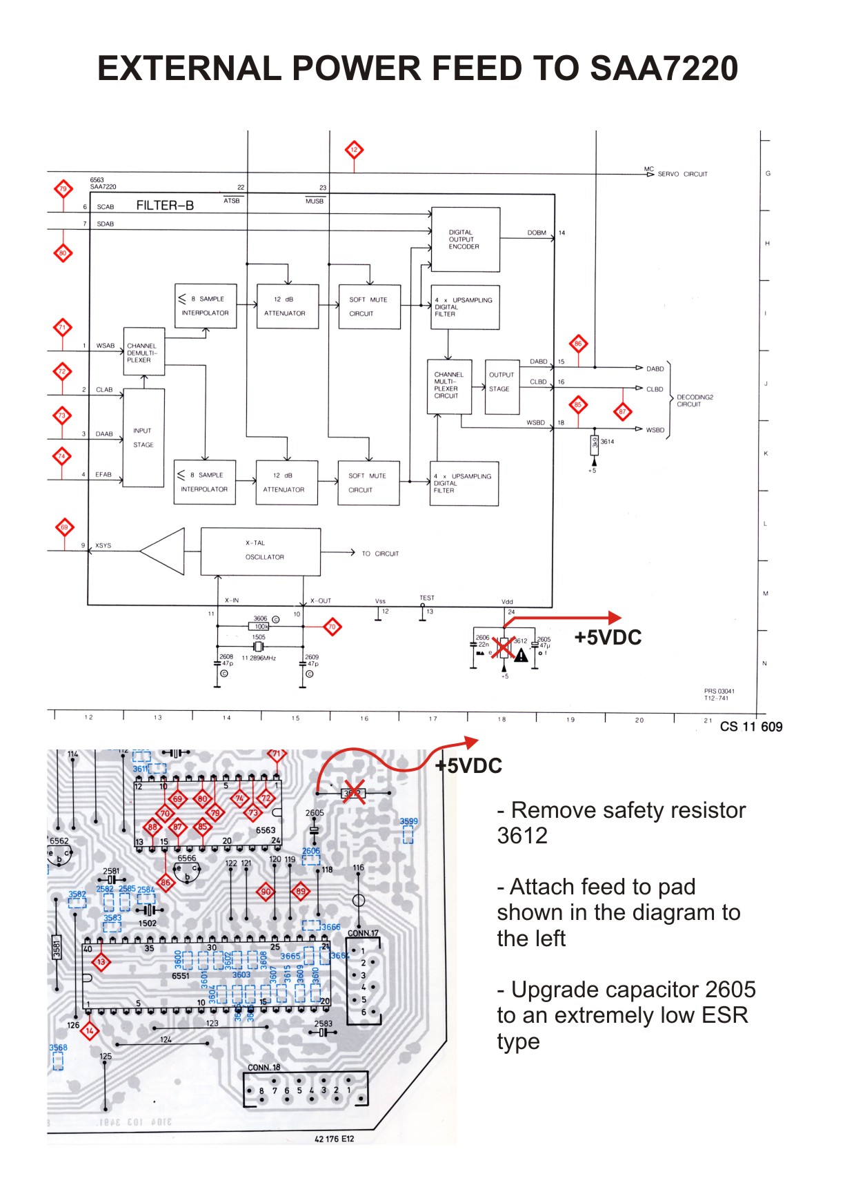

I need a little help please...

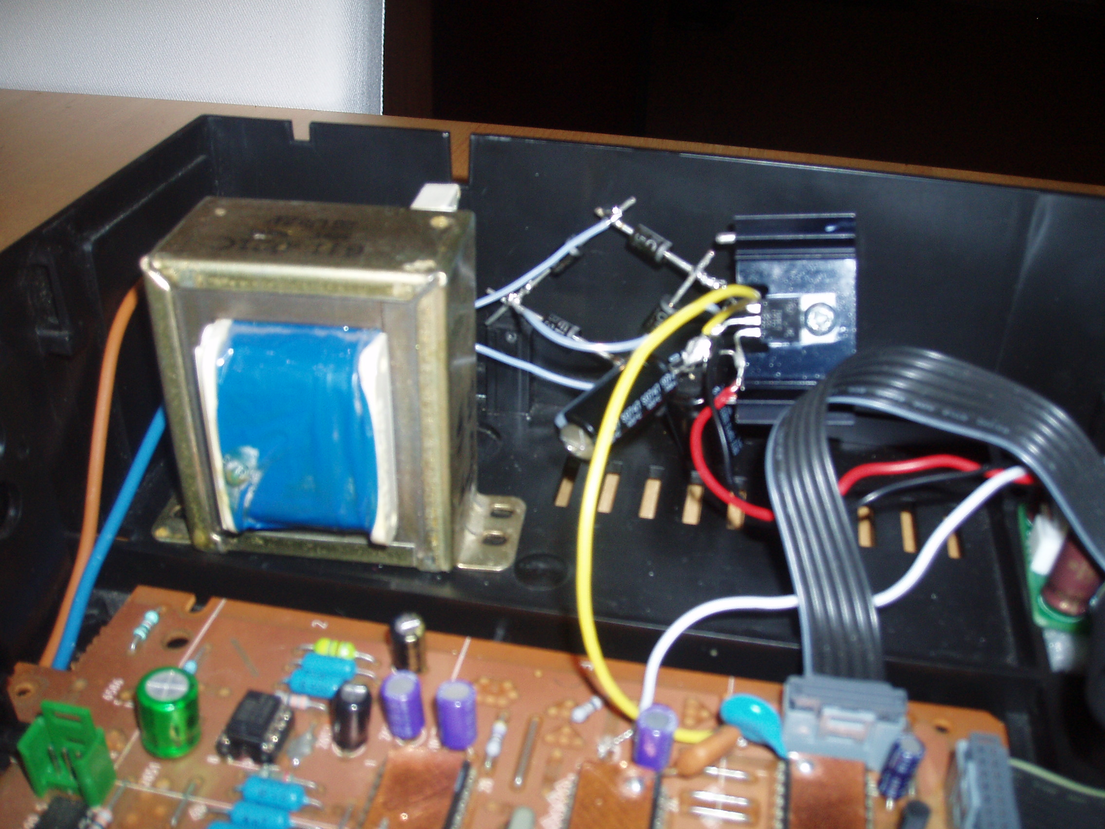

I want to put a new psu with the burson audio super reg.
I´ve got a build psu from my shigaclone to test it and i want to feed the Saa7220p/B separately with the new psu.
But i don't exactly where to put 5v line into the saa7220p/B chip.
Can someone tell me where i have to look?
Thanks.

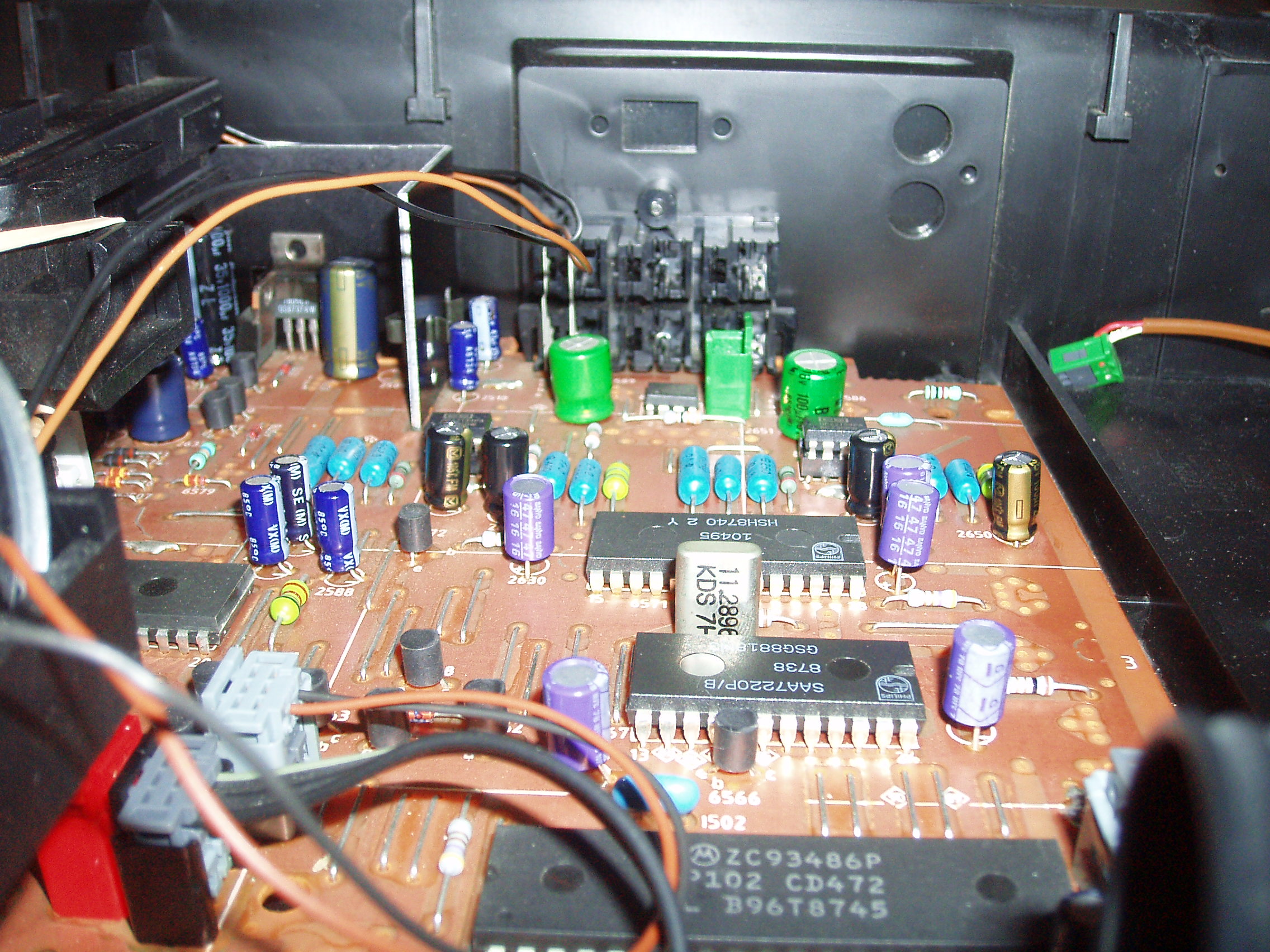

Today i spent a little time at my cd-471..
I put copperfoil on the 3 biggest chips and couple it to ground with ceramics caps.
I tought it was voodoo to put some coppershield on the chips... but i must admit, that it works very well!
The dynamics seems to be improved. I'm happy with it! 😎
I drew up a diagram on how to connect an external power supply to the SAA7220, it's a pretty easy job. A couple of caveats though:
- Make sure your supply is actually putting out +5VDC, or at least very close to that.
- The SAA7220 is going to burn through 180mA while operating, make sure your supply can actually handle that.

This is great! Thanx.
I'm gonna start with a standard lm7805. after that i have some burson audio super reg for further improvement. Maybe i put a alwsr super reg on this chip.
I want to put seperate toroids for the chips like saa7220p/b, saa7210, tda1541A. I'm searching for 30 or 50 va toroids because this fit into the case.
Probably is 2 toroids the max for this player, but i have to measure that.
Capacitor 2605 is already changed for a sanyo oscon 47uf/16v.
Is this good enough? I have some panasonic fc/fm lying around.
pics later...

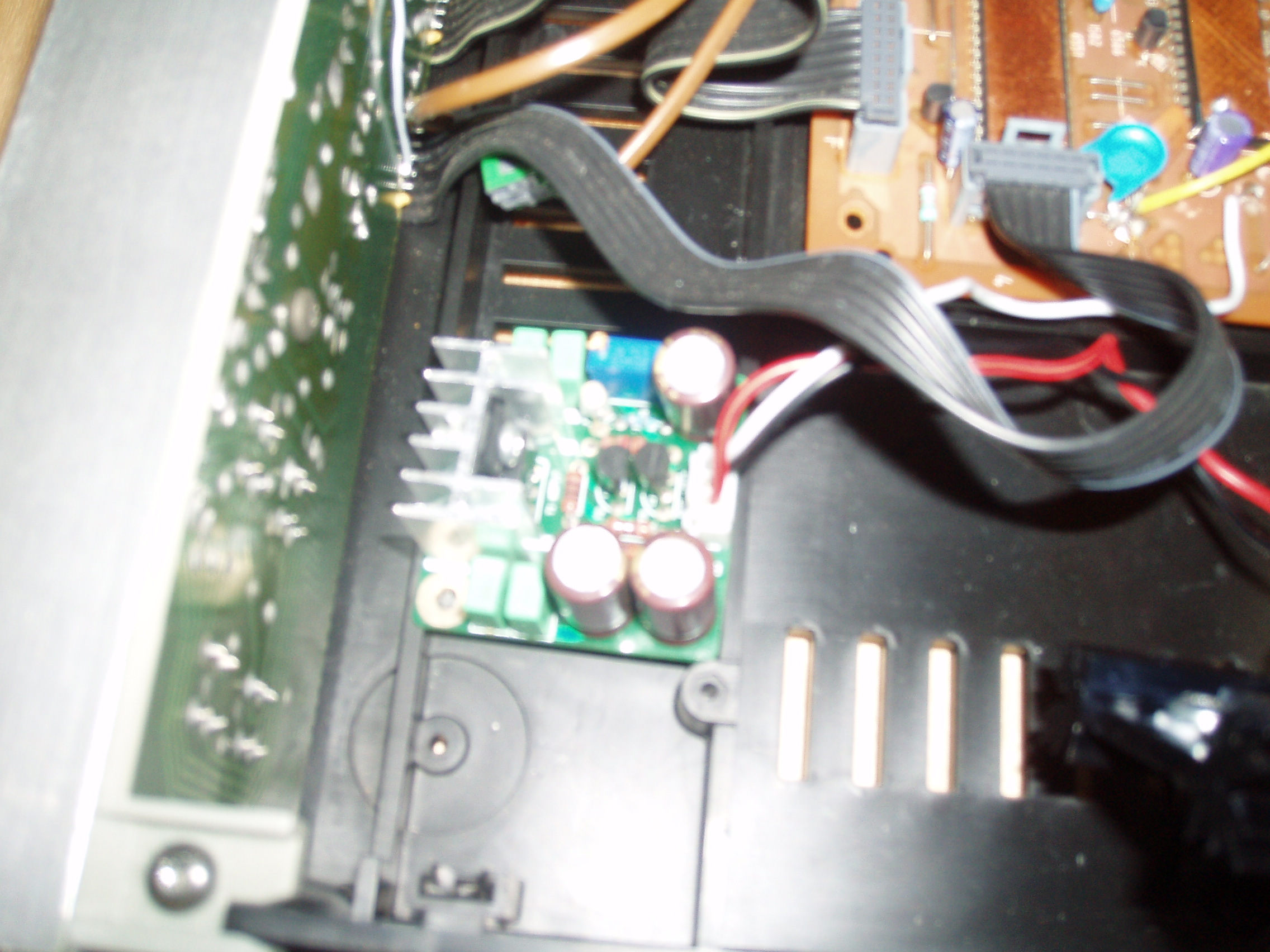

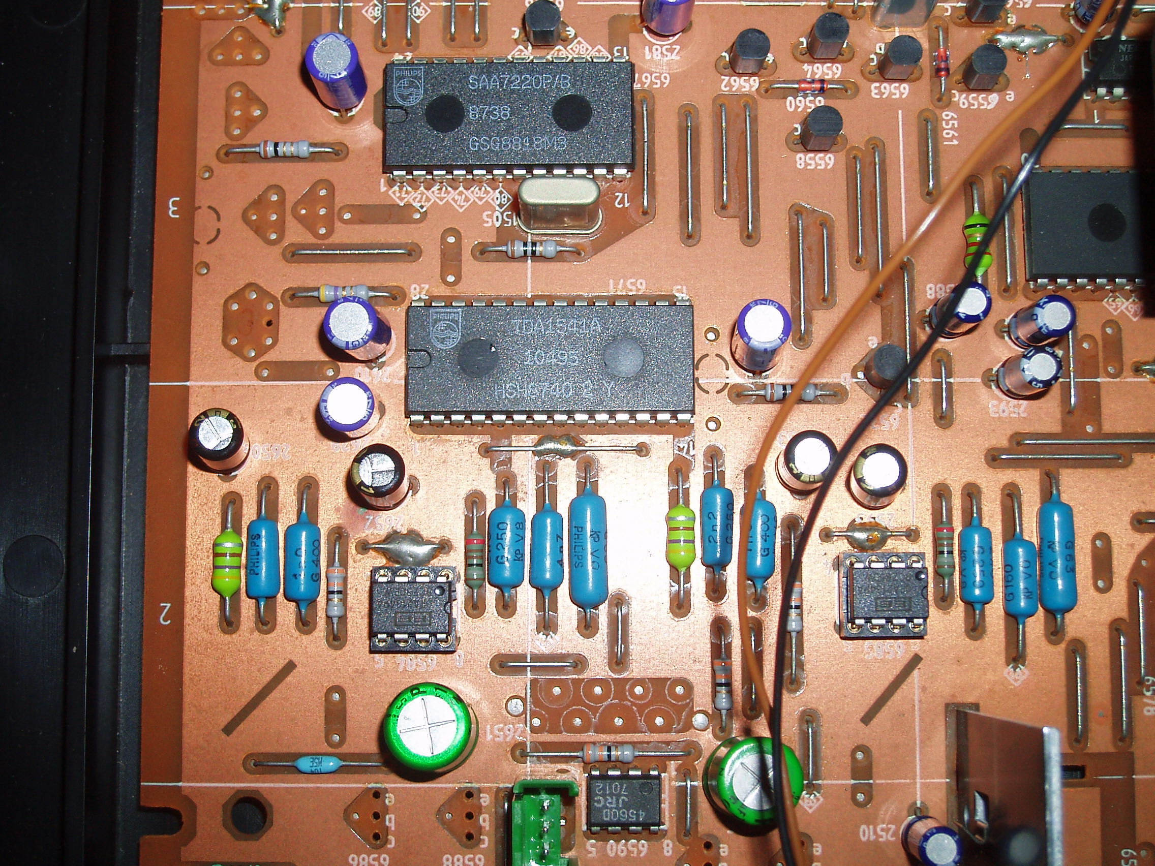

This is only test setup. I need to rebuild the circuit a lot smaller.
Next step is a second psu for the saa7210 or tda1541A.
It plays already very nice. 😎
