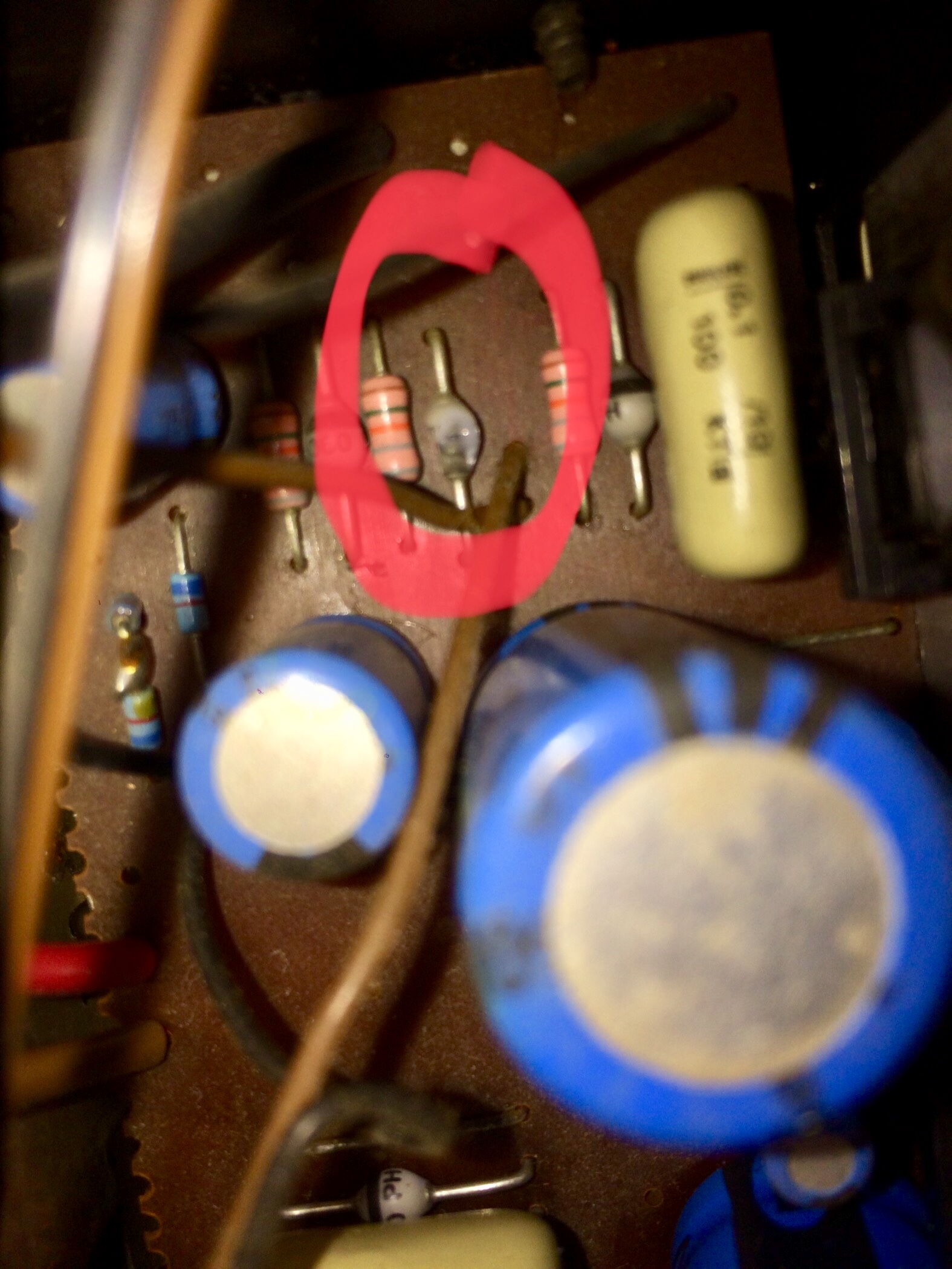

after massive resoldering lots of broken pins on all the PCB of my Philips CD-303, It come back to life after 34 years.
Everything works fine exept for the audio output.
As soon as i switch on the player, on both channels appears a loud "hum"; when CD playing starts a lot of popping comes from both channels too.

Thank you for the replay, I Will try to replace them.
How can I identify their type/model to buy the spares?

It's a dead diode/rectifier.
Look carefully for a black band round one end ( similar to the one to the right )
Replace it with a 1N4005 making sure you orientate it the same way.

The popping during playback is probably due to lots of soft errors, too many for the ECC to fix or interpolate. This could be due to many issues with the optical head assembly, but a good candidate is dirt build up and hardened grease on the mechanicals. 34 years is a long time. An air-duster gently applied is a good first thing to try for dust/dirt.
