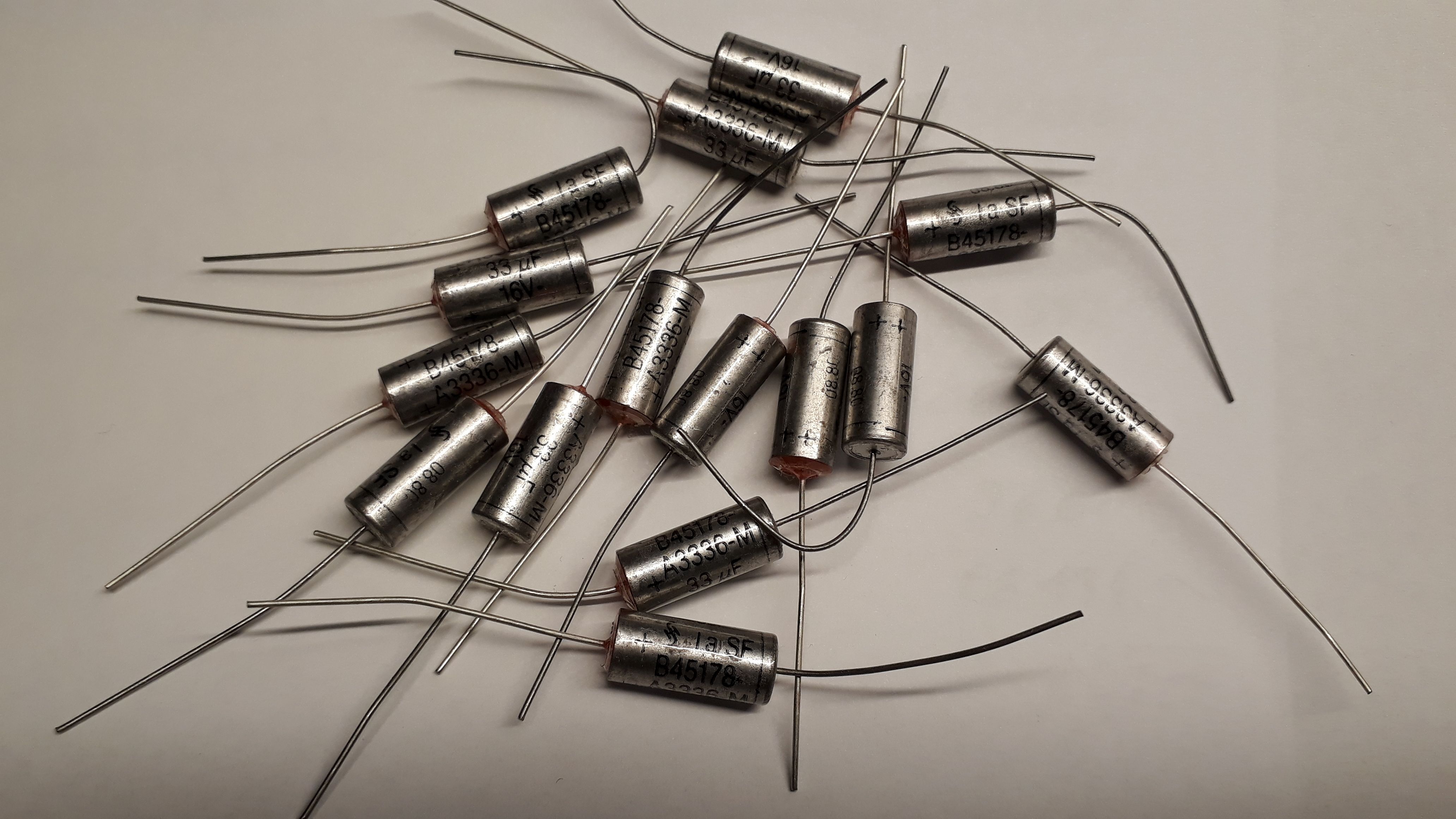

Are these Siemens (ROE) tantalum capacitors any good for recapping the CDM-1? B45178-A3336-M 33uF/16V
Not a big fan of tantalum, when they fail, they fail spectacularly to a short (often with a pop). I do not like them near delicate electronics as in the CDM-1.
One way to reduce the risk is de-rating their voltage, i.e if the electrolytic caps was 16 V, use a 25 V tantalum. But honestly I would not use old stock tantalum, even if they measure fine.
