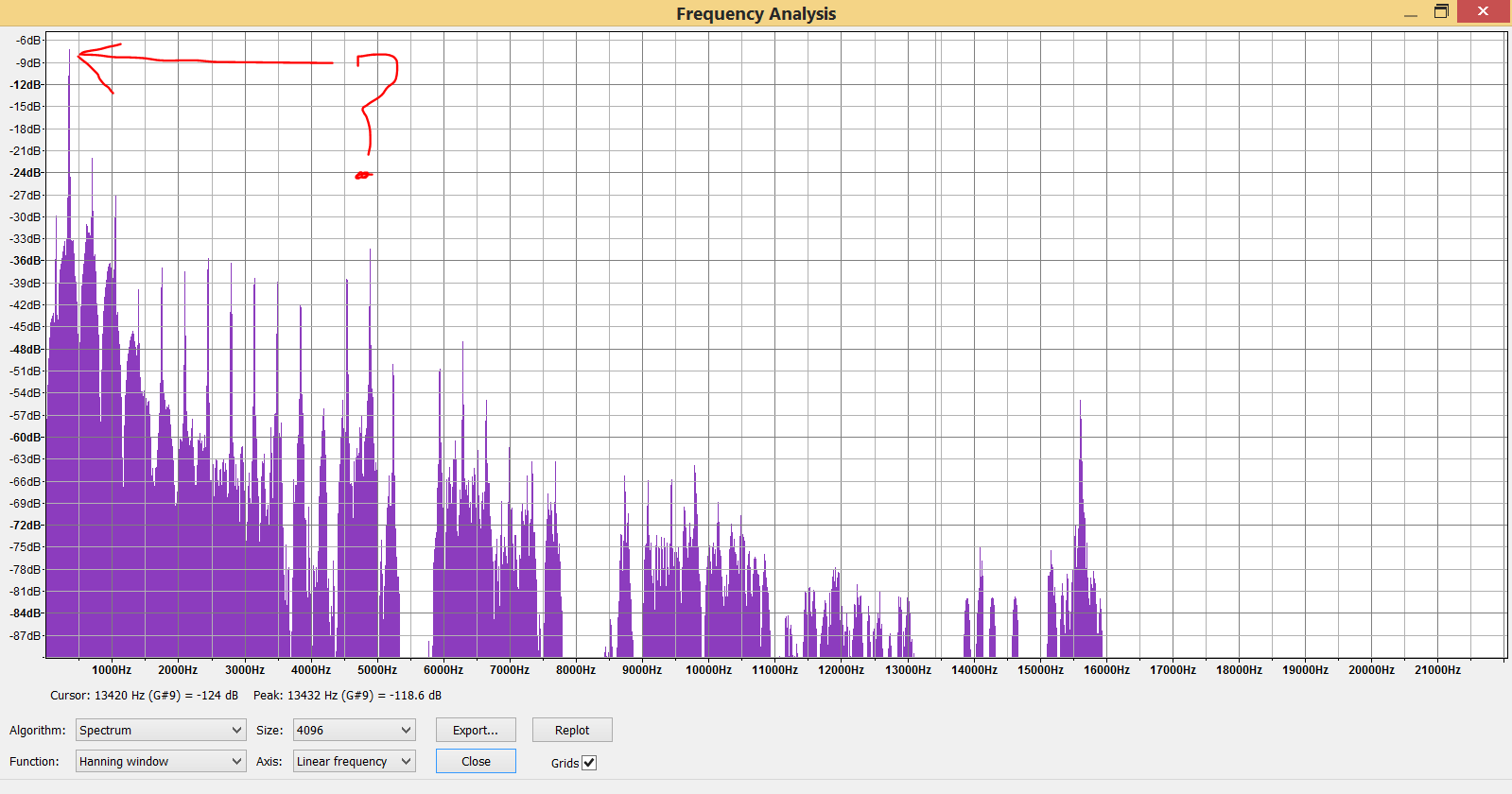

I've never come across anything like that. Loading the track into Audacity shows the noise and it seems centred on 300Hz.
For no good reason I just wonder whether it is a problem with the DAC or something closely related in the processing chain. Glitches and error correction or faulty RAM issues just don't sound like that.
Baffled on that one 🙂
