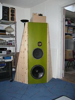

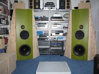

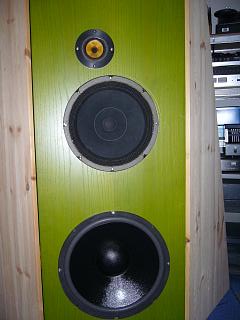

Hallo EmPee,
Thanks for the interrest. For the moment I'm using them open baffled (will send pics later on this weekend).
Did some experiments with "helper tweeter", because of my 24 years old daughter, who heard some missing highs.For the moment the best sounding tweeter is a Siare TWRV 1090.
They realy sound wonderfull and warm.
In fact they sounded more pleasing then my fostex fe 166 horns.
So I will continue experimenting.
I'm aiming for something like the supravox open baffle.**
Couldn't find any TSP's for them. So I'm using the TSP's from another very simular looking Philips: AD 12252/HP ( Fo 55 , Qt 0,69, Vas 111L), which looks from the outside very simular.
This indicates Open Baffle will be the right approach.
Onken encl. will be no good; to high Qts (0,69).
Because there were no reactions at all, on this post, I went on on my own. But from now on I will post more to lett you know how things are going in the future.
Leon.
I did try to attach the supravox open baffle file, but it is to big.

Hello TOMAC,
I don't no, did a search for high Q 15 inch cheap.
The are from Belgium, and are called"Spynkx".
Qt 0,78 and Fs 27 Hz.
Didn't want to pay much because first experiment with Open Baffle.
Payed 40 euro each.
I took the "Lampizator"- approach ,star with wide band midrange, do a lot of listening, add tweeter and adjust cap to MY ears, add woofer 15 or 18 inch and buy ONE good inductance
(3,9 mH 0,16 ohm) adjust midrange to woofer etc.
Philips was 2e hand : 7,50 euro each and tweater was on the shelf.
