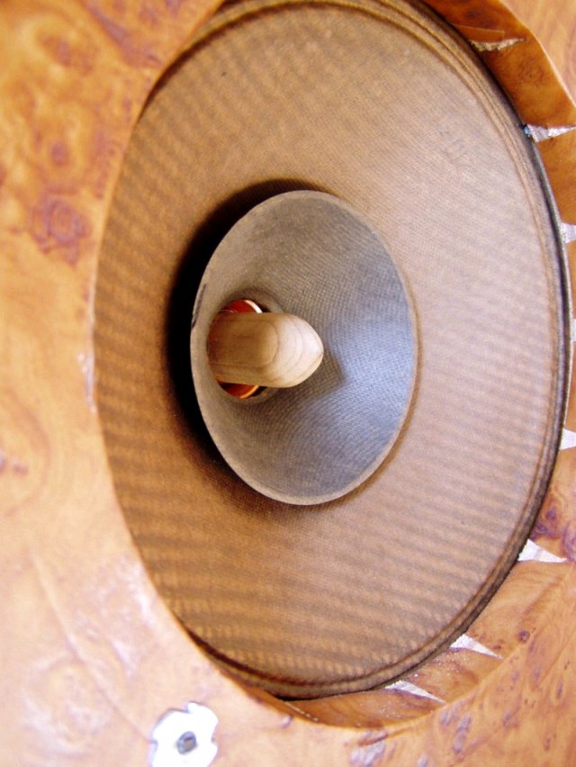

I got my 9710m:s in a pair of voight-horns; Here is the thread on one of the swedish forums: http://www2.hififorum.nu/forum/topic.asp?TOPIC_ID=35794
The plans and measurements are on page 8.

Certainly
On page 8 of the thread there is a picture with four different measurements. The area of the port is at the top of every measurement(ignore peak/dip at 50Hz). We settled for 110cm2.
Yesterday i put the filter together(still running it FR), but i am not totally happy with the sound, i guess ill have to experiment some more...
Please ask if anything else is unclear!

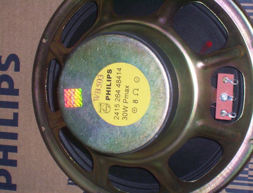

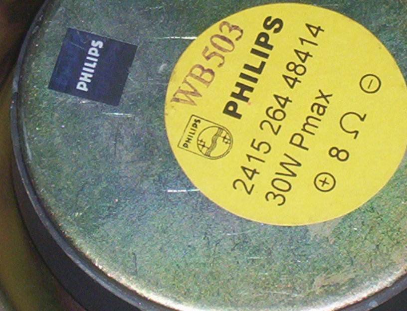

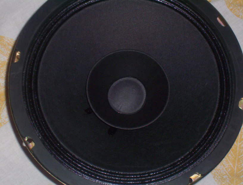

i got two indian made philips fullrange speakers.the numbers they had mentioned are different. but it looks like 9710.it is an 8 inch fullrange driver.can anybody identify these speakers.it is very cheap here.it is costingonly 6 american dollars.please see the attachment
renjiish,
These look like quite new speakers to me.
Philips stopped building the 9710 since I believe 1975.
I do not think these are 9710 speakers

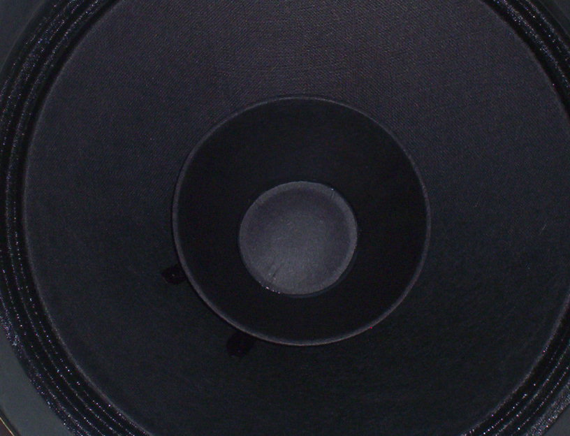

I just managed to erase my answer😡 but Ill sum it up:
Not same driver
Different magnet (ceramic - AlNiCo)
AlNiCo one sounds better from what i have heard people say.
Cone looks similar
Cheap and i bet you can make something nice out of them
