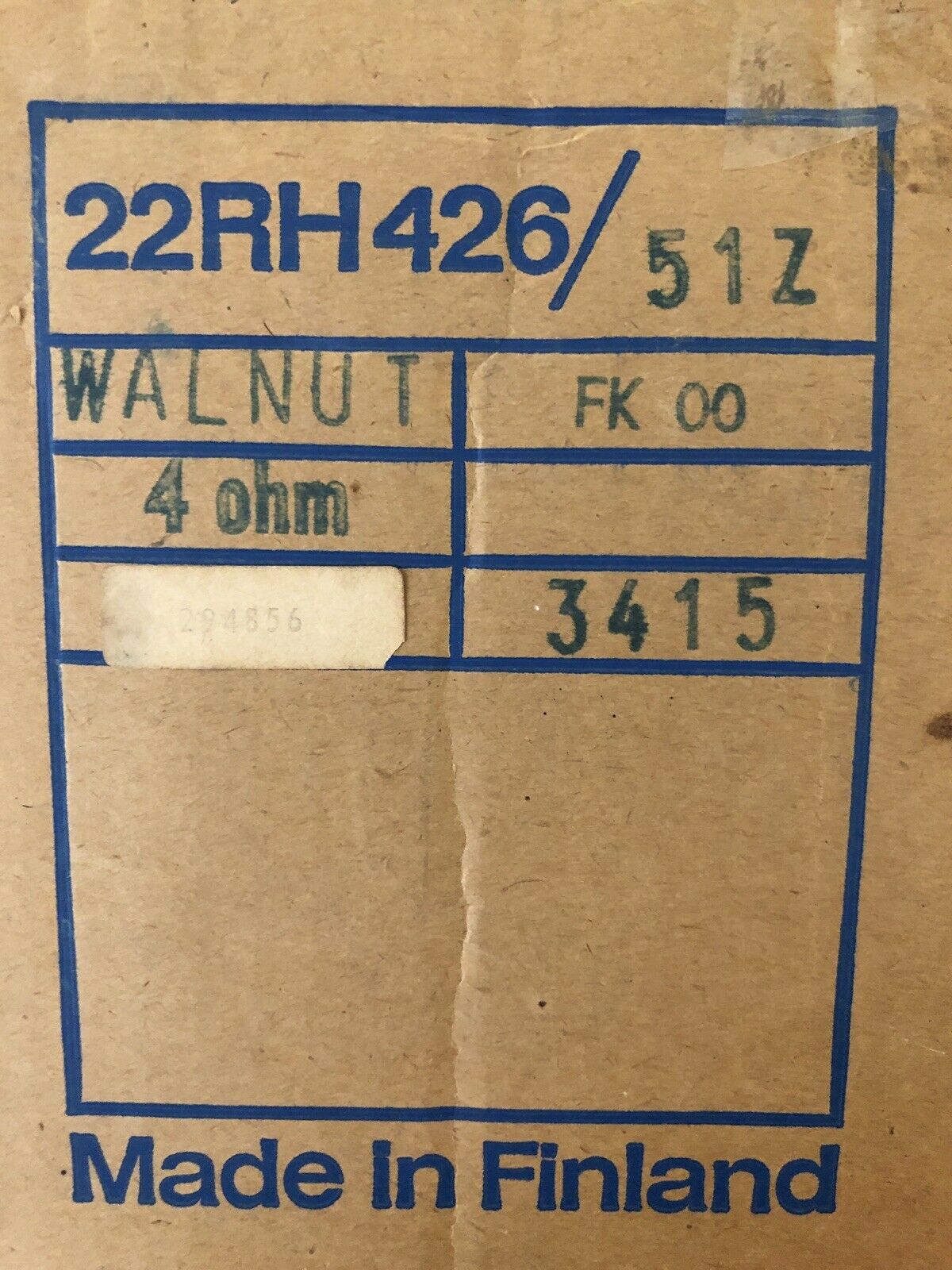

I've recently acquired a pair of Philips 22RH 426/51Z speakers, from the early '70's I think.
Not much info. about them online, although I did manage to find the service manual. The pdf is too big to attach, but can be found here:

I like to see pictures of vintage speakers, and the attached could actually be of the ones you've acquired, as they were recently sold at auction! :happy1:
Hi Galu,
I'll post some pics of the speakers tomorrow. They need a going over with a damp cloth and a polish, but aside from some light scratches and a few splashes of paint they're in good nick overall.
They were a gift from a friend, so they're not the ones which sold recently. They were her fathers, and as far as we know he bought them new back in the day.

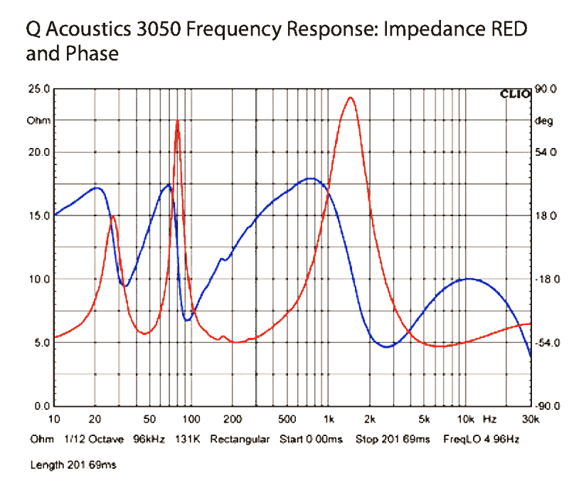

Your EL84 SE will be sensitive the real impedance curve of whatever you connect it to. Speakers with XOs rarely concern themselves too much about flattness of impedance. Your Q do not look to be a good fit to your little SE.

The Q's are not a good match for my SET, but they are better than the Missions. Not an amazing feat, but a (small) step in the right direction - plus as I said, they cost me nothing.

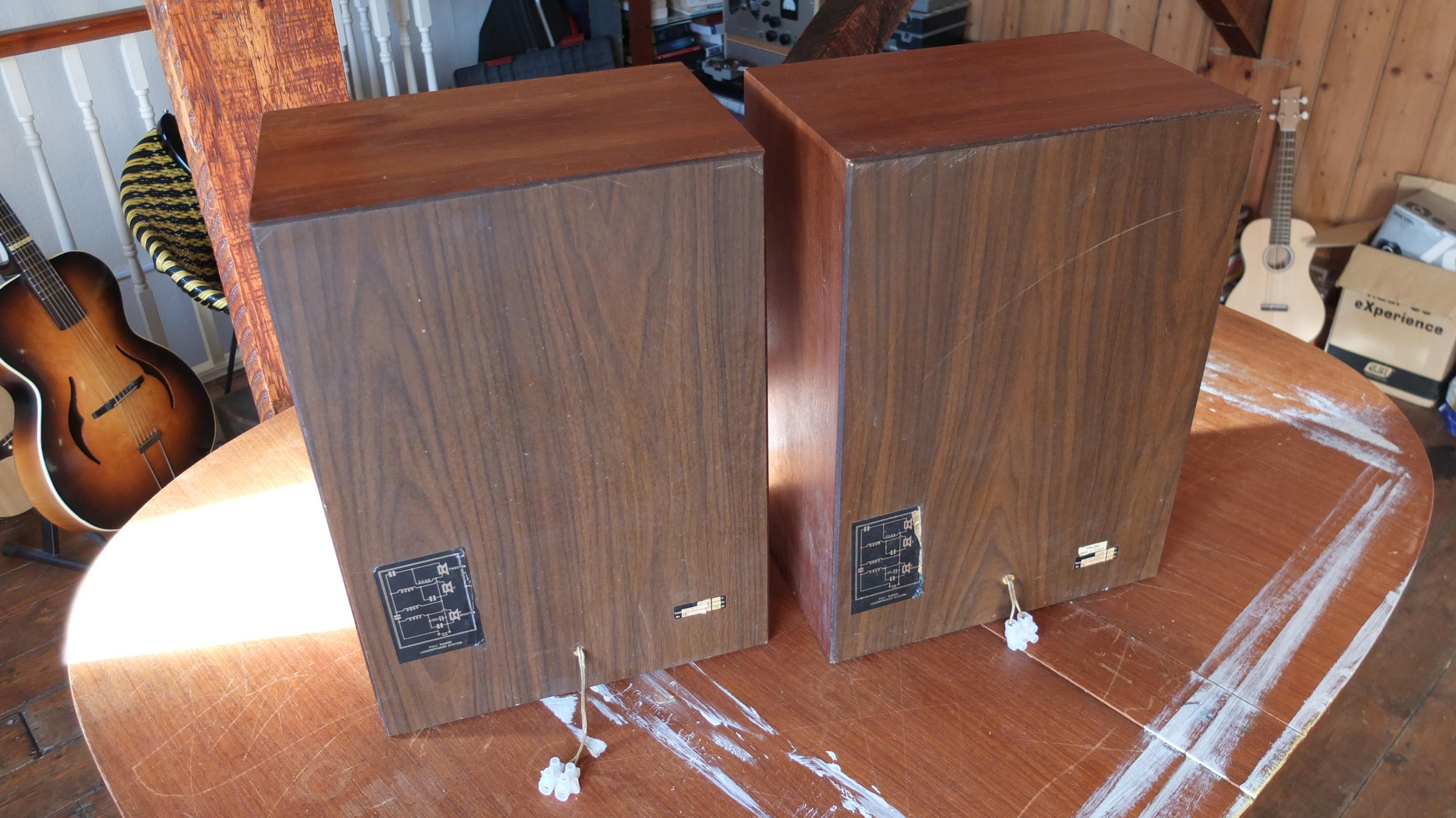

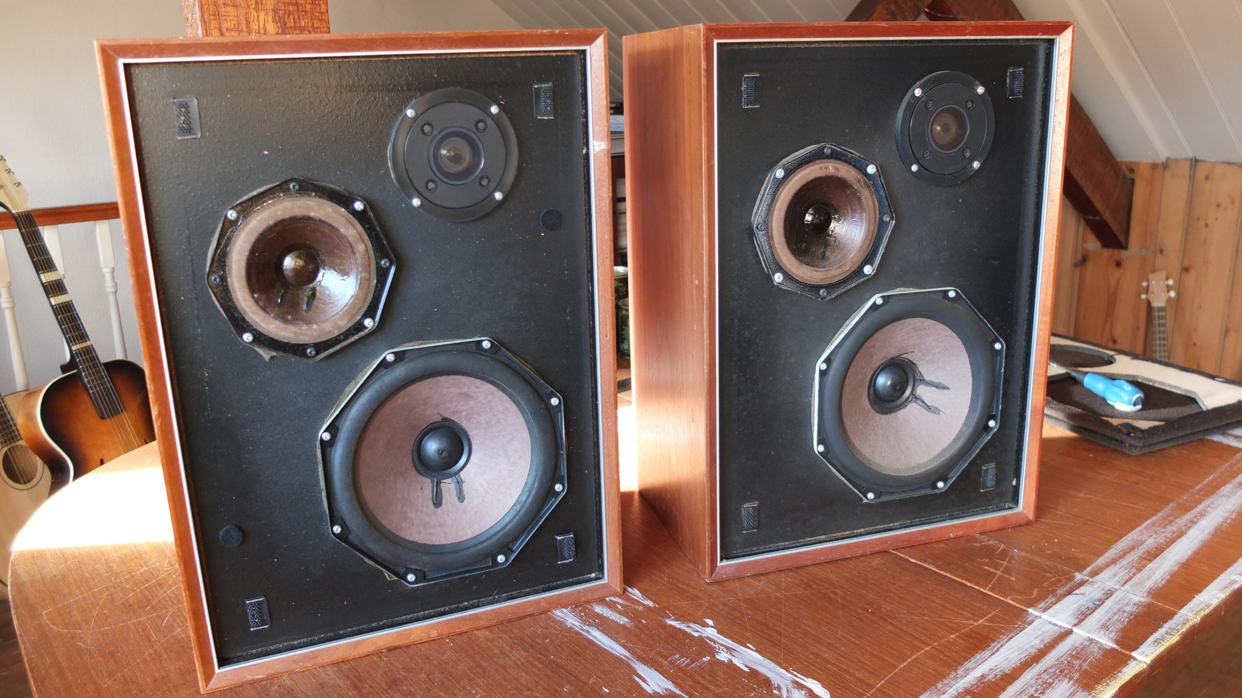

Photos...
Hi all,
As promised, some photos of the speakers:
Not in bad condition for their age, and they look quite good in the wood-panelled surroundings of our attic. Given that they're probably a non-starter for the main hi-fi downstairs, a second system up here beckons...

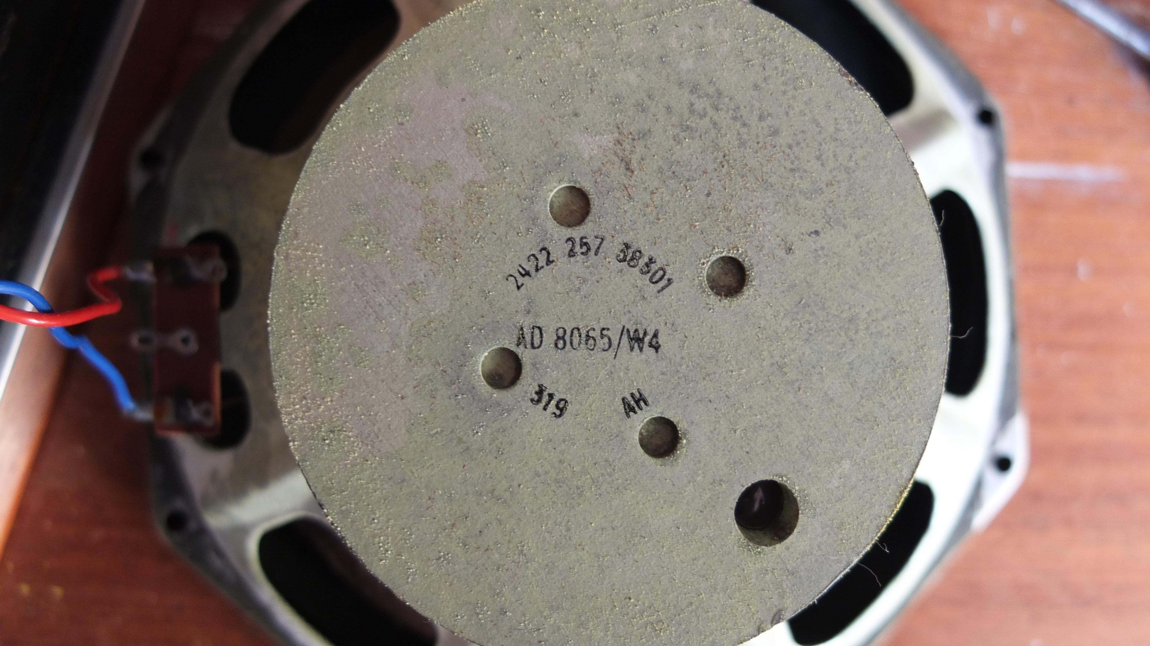

Do the codes on the woofer tell us anything more about their quality/provenance?

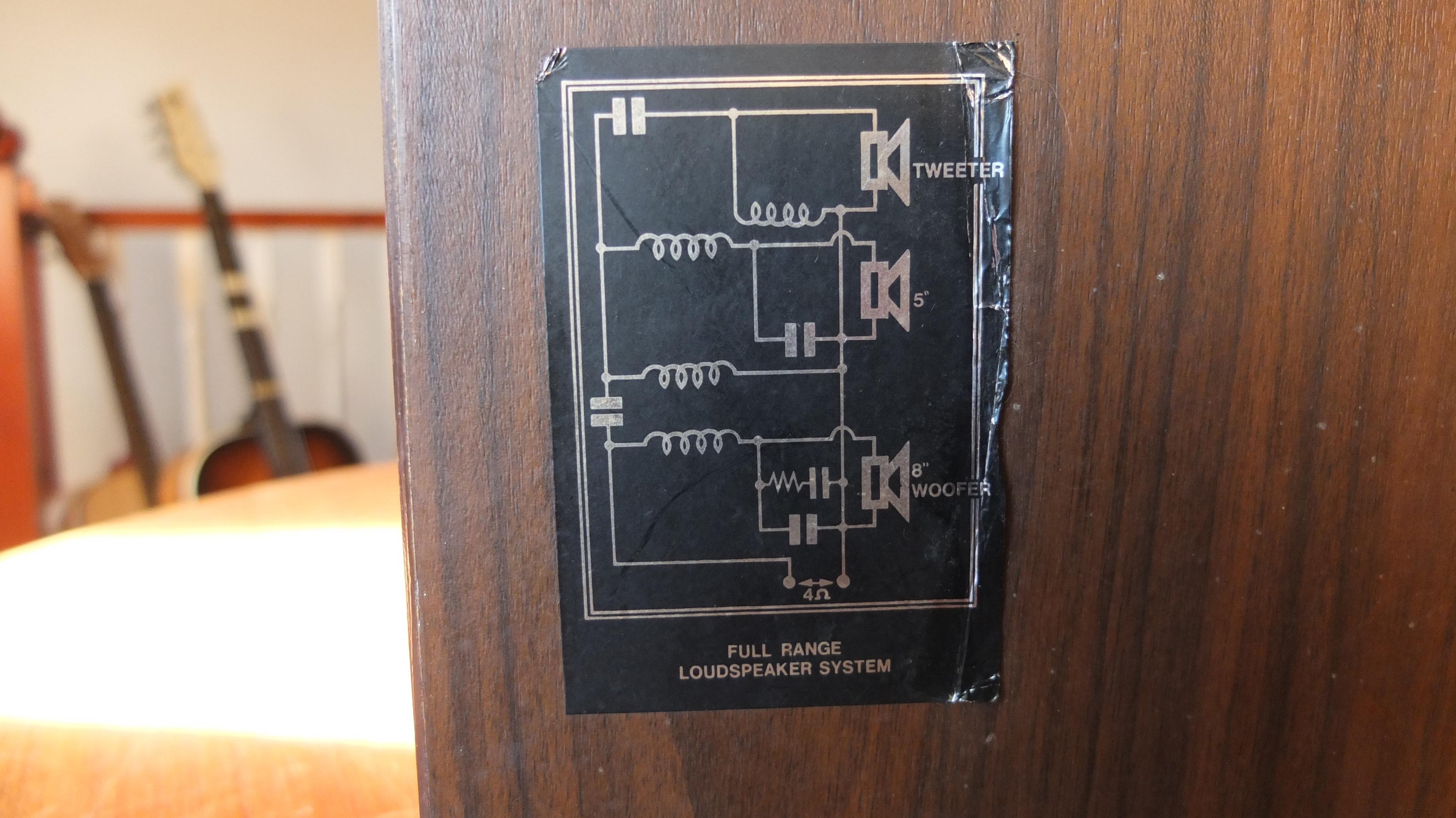

#planet10 - I took some shots of the XO's for you, although at this point I assume they'll only confirm your suspicions that they're rubbish. I thought the component quality looked ok, but I'm no expert. Plus as I said before, quality parts in a crap circuit aren't going to save the day 🙂

Yes those are the XOs. Besides being generic, you have ancient Elco cas and iron core inductors.

Those are the standard 8”. We used a lot of the 8Ω version.

That would seem a reasonable use for these handsome, retro look speakers.
I probably wouldn't do much more than replace the bipolar electrolytic capacitors with modern equivalents. Simply choose the current standard uF values closest to the ones in your crossover. In this simple crossover, a small difference in absolute capacitor values will be outweighed by the use of fresher capacitors.
Here's a handy source of replacement capacitors: Mundorf Electrolytic ECap Capacitors
Hi Galu,
Good point regarding the ancient electrolytic caps, it hadn't occurred to me to replace them (although it should have - I've replaced enough over the years!). I've a fairly decent stash of spares, hopefully I'll turn up the correct values.
