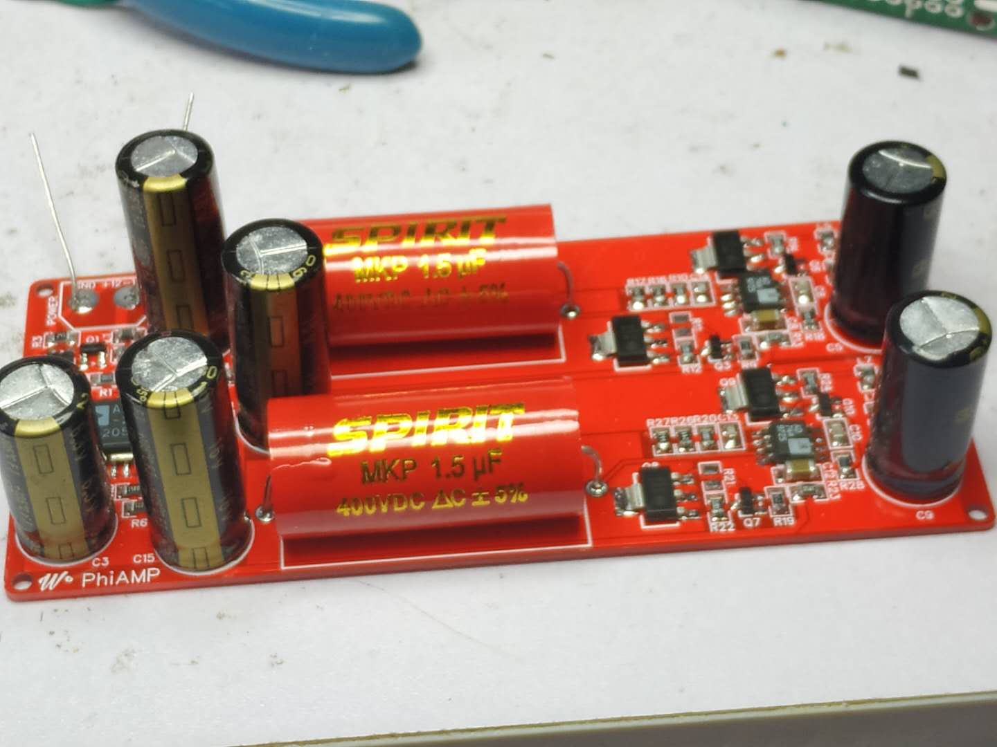

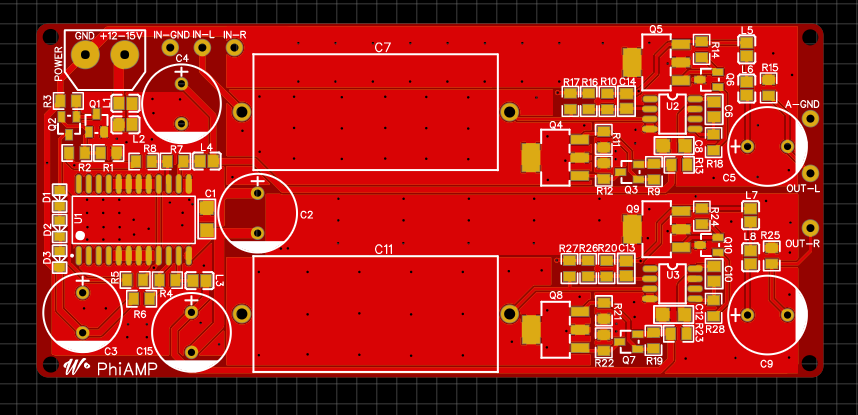

As the PhiDAC hex doesn't drive headphones directly I designed this headphone amp to partner it. Its very simple and has low BOM cost, using the JFET input AD744 with a classA SE output stage. A couple of prototypes have been built and here is the first PCB layout. Would there be any interest in kits of this too? PCB size is 10 * 4.5cm - JLCPCB currently has a special which gets us 5 PCBs for 5RMB, including shipping. Normally shipping alone costs more than this 😀

This schematic represents the first prototype of PhiAMP - I built up two and my friendly beta-tester has also built one. Based on a couple of minor issues with the initial builds there's a rev2 PCB coming back today with fixes.
This amp is designed primarily for higher impedance headphones - ones which likely need voltage gain from a DAC. Examples are HD6XX and DT880/990. I find HD6XX works great with unity gain from a 2VRMS source - in this configuration it runs fine from a 12V supply, same as PhiDAC hex. My 600ohm DT880s want more drive though which necessitates a higher supply voltage. The rev2 makes setting a higher supply easier as it uses a zener diode for reference rather than LEDs. Choosing various colour LEDs for particular voltage drops is rather a crapshoot, a zener is far more predictable.
The second issue is related to grounding - with the DAC and AMP running from the same supply the ground connection can carry noise currents if the supply powering both is noisy. To circumvent this the grounding on rev2 is configurable, depending on whether its powered by the same supply as the source, or not.

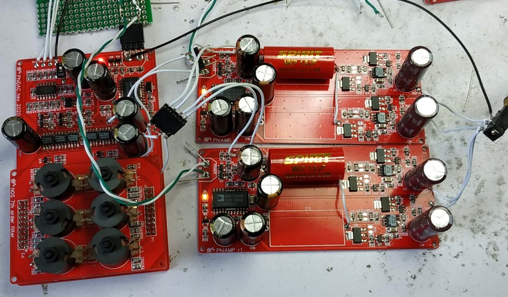

I also plan to try paralleling this amp - if two or three can be paralleled then the output power could be increased enough to drive planars. I have some Fostexs here to run them into.
Paralleled PhiAMPs
Early days yet but the way the Fostex's are sounding with this configuration completely distracts me from how uncomfortable they are to wear.😎
