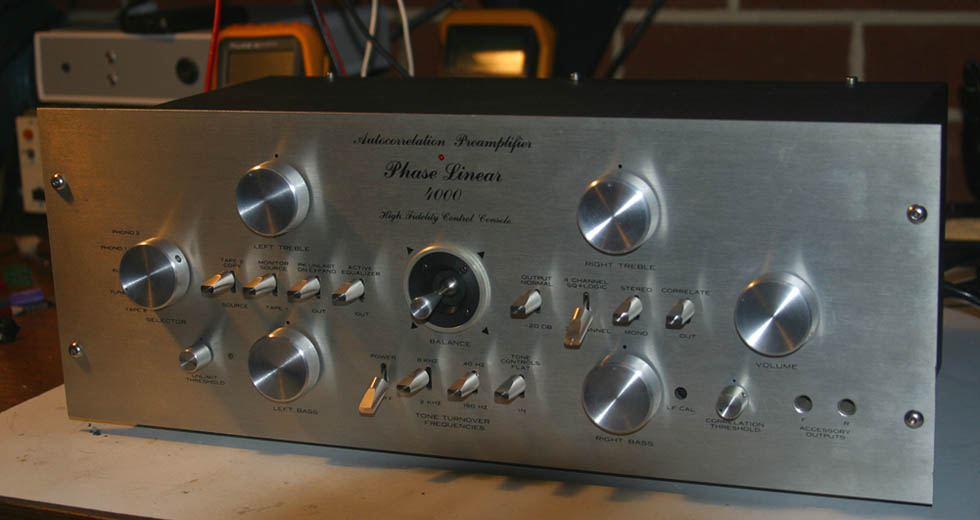

I have always wondered about their preamps, and in particular the old 4000 series and all of their inbuilt processing.
I recently stumbled across one of the 4000 series 1 preamps, which is in excellent cosmetic condition, but unfortunately it does require internal repair.
I bought it, and now I am unsure if it is worth the effort to get it up and running.
Any thoughts???

PL4000
Thanks for your comments djk, d3imlay.
Well the PL4000 is up and running, but it was not without its heartache and a lot of work.
The job was not helped by the fact that someone else must have tried to repair it before me, and made a mess of it.
This is what was required:
1.Clean all of the switches
2.Relpace the voulme pot (was completly shot), and also required some creative modifications.
3. Rebuild the power supply.
4. Replace over 40 electrolytics, including some matching for the delay.
5. Redo some wiring, including all of the 240V
6. Has 2 broken RCA jacks
7. Resolder countless joints, and repair some cracked tracks.
8. Stabilize from further damage lifted tracks.
9. Pull the entire face plate off and a good clean.
I have not hooked it up yet, but on the bench it appears to have a very clean wave on the scope, and no signs of anything abnormal, except for the joy stick control, which seems to balance across the diagonal rather than true side to side.
I will yet you know how it sounds when I hook it up this weekend.
Anyway, here is a pic of the final rebuild.

PL4000
Well
I could not wait untill the weekend, and managed to test the preamp tonight.
In summary, what a fantastic sounding preamp, and in particular, the phono stage.
I am very glad that I decided to fix er up, rather than ditch it.
However, it does have some rather unusual charecteristics.
1. Engaging the "correlator" - what ever that is, results in an immediate loss of treble, regardless of the setting. Best left off.
2. The Threshold control / PK expander control does not work well on pure acoustic and vocal recordings. Seems to have a pumping effect.
However, on material that has very fast, lower register attacks,such as a kick drum, the audio effect is quite good.
But after all of that, I simply defeated or turned off all of the whiz bag stuff.
In summary, suprisingly good, and well worth it, provided you can find one without paying too high a price.
Hope someone finds this usefull.
