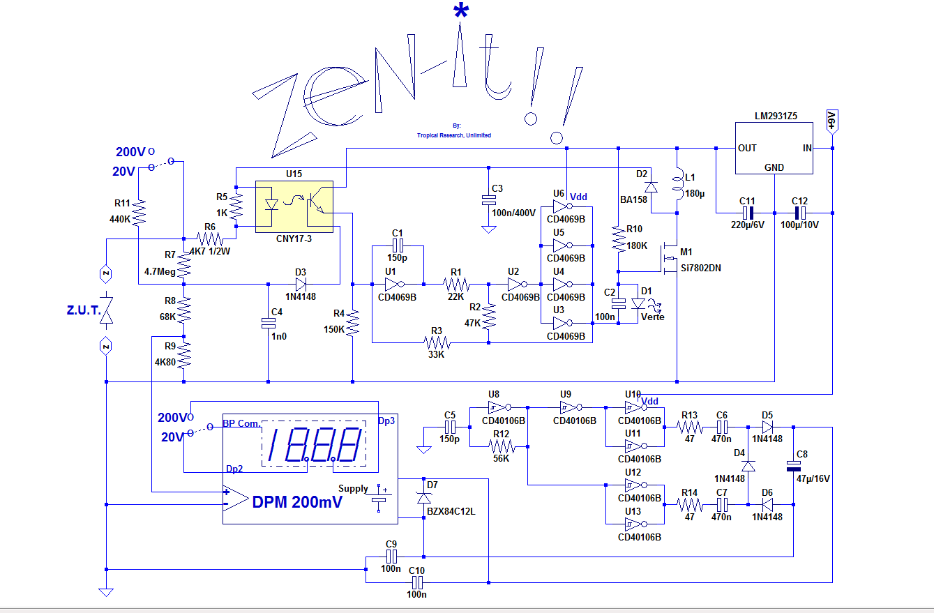

I need to make 9v to 48v dc dc conversion (for powering a condenser mic from 9V battery) . I found this schematic 9V to 48V DC-DC Converter
The problem with this schematic is that when I adjust about 40V output - it consumes about 60mA. It's too much. Lowering the output voltage lowers the consuming current. All the above was tested without any load (with mic as a load the picture is almost the same). According to the schematic L1 should be 68uH. When I used this value I burned the chip. Then I replaced it with 470uH (exactly this value is used in the real board on the photo). I also replaced 0.33 ohm resistor with a jumper.
I measured the consumed current as voltage drop on 33 ohm resistor connected between the plus of the battery and the plus of the pcb.
The question is how can I increase the efficiency of the schematic or maybe someone knows other schematic with low consumption.

The 0.33 resistor is importent, it keeps the peak current under 1A.
C5 must be low ESR.According to the factory data, the zero load current is max.4mA.There is allready a load by the voltage divider R3+R4.Total consuption goes up over 10mA no load.To lower consumtion, try a bigger C1 to lower operation frequency.Factory data use 1n ... 1n5.

The converter of this tester has a much more reasonable consumption (depends mainly on the quality of the inductor).
It is the upper part of the circuit, around the 4069
As it is, it's a constant-current, voltage-limited type of 20V or 200V, but it can easily be converted.
For 48V, you would need to make R7 ~1.3 Megohm.
You could keep the current limitation, it will protect against shorts, and phantom power normally needs next to nothing, but if you want to remove it, use a simple transistor instead of the optocoupler, and remove R5, R6.
The voltage regulation isn't tight, which shouldn't be a problem in your case, but if you want to tighten it, you could use a 39V zener in series with 220K in place of R7.
