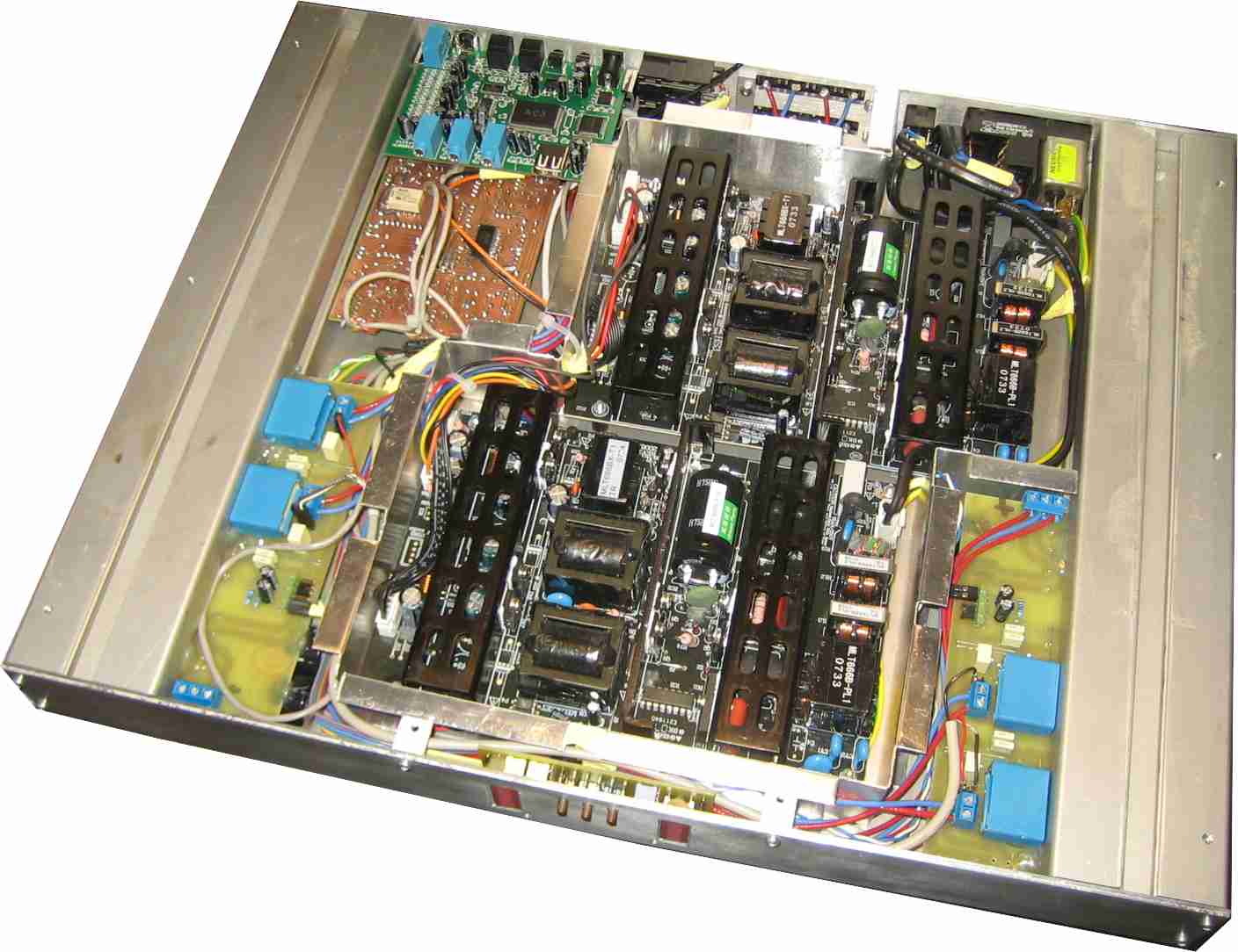

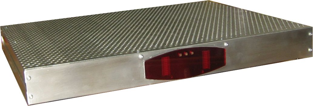

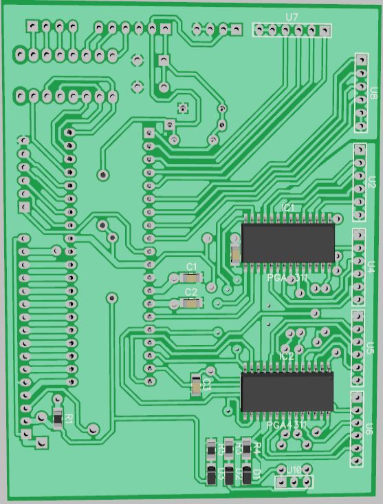

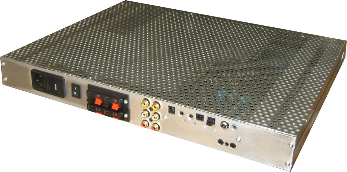

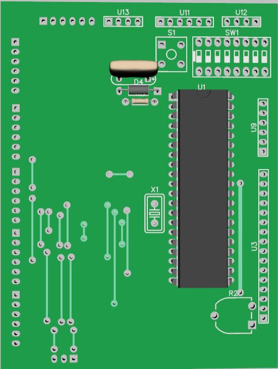

I did a project recently using PGA4311, dspic33F for control and online VU-metering with the embedded DSP core, 4xTDA7296 (60W each) power DMOS amplifiers, and two powerful SMPSs for 240W. The AC3 decoder is a modified AC3 gear (seems to be a Cirrus Logic device, but not sure) fitting to the housing.
See the figures attached. if you need some advice PM me.
