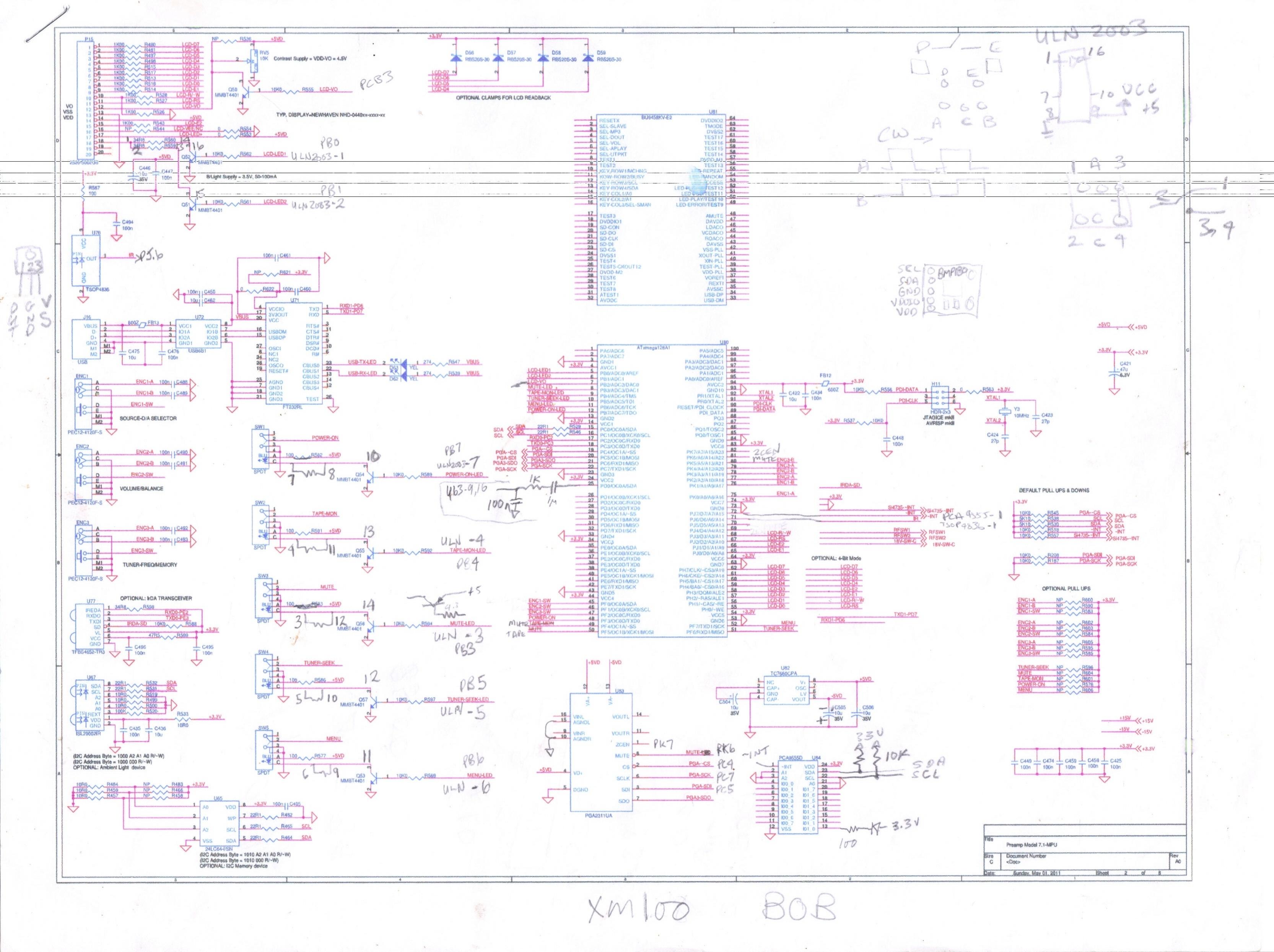

PGA2311 programming & ckt
Kulamario,
Post your schematic and code and i will review it for you.
Don't really need a schematic, as far as the MCU interface to the PGA2311/PGA2310/PGA2320 parts.
I attached my example schematic.
To start with, I used a Sparkfun xmega100 BOB (Break Out Board) and the ole wire-warp sockets/wire/gun,soldering iron & parts. I used a standard 12VDC wall-wart,5V & 3V regs such as 78xx or 317 (not drawn on the schematic).
The rotary encoders work well!!
Okay will post the test schematic and can provide the code as well later if you want it. It is all xmega based so over kill for what you want to do as you described.
I used a PWM, using pin "PD0" to generate a signal to test the PGA2311 & PGA2310, both work at +/- 5V.
Four line LCD as indicated
A great learning tool!!
