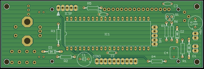

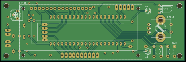

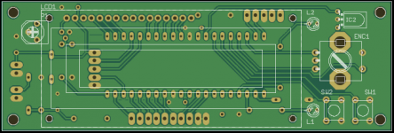

I'm working on a project of an interface for the pga2310 volume control IC.
The interface can also control an input select board equipped with relays
or analog switches, and is remotely controllable with an RC5 type RC.
I think it could be used as a starting point for various preamp projects.
It's intended for the diyers that aren't familiar with microcontrollers.
Here is a VIDEO of my first prototype.
I'm planning to make a kit if someone is interested.
I attach some image of my idea, it's a compact module of 120x40mm (4.7x1.6'').
Comments and suggestions are welcome.
Bye.

Not bad, but I would use PIC18.It has more memory and is easier to program.

The program is wrote in assembly using MPLAB IDE.

How does it compare to say, a stepped pot?
Other than that it looks good! I think I would rearrange the selection so that source selection comes before balance.

I'm not a great audiophile, so I will not enter in this debate.How does it compare to say, a stepped pot?
On the paper the pga2310 looks very good (and pga2311 has still lower distortion).
I think the price is very low compared to that of a good quality stepped pot.
In addition it has the source select feature and is remotely controllable
(maybe there are motorized stepped pot, I don't know).

My project pertain only to the control section.
My intent was to create an easy way to provide the SPI signal
(3 wire + gnd) for the pga2310 logic and 8 (or more) TTL signals
to drive the input select board (my first idea was to use SPI also for
input selection, but I tought it's simpler this way).
In addition there is an on/off
signal to switch the audio part from remote control.
The audio part is left to creativity.
I think the quality depend greatly on the design.
The pga2310 require a low source impedance, so an input buffer
is mandatory. The minimum load is 600 Ohm, so an output buffer
may be needed too.
Surely one pro of this chip over the stepped attenuator is versatility.
It provide attenuation as well as amplification (-95.5 <-> +31.5 dB)
in 255 (0.5 dB) steps. Probably you don't need such resolution,
but the steps are easily modificable in software, or be user selectable.
It's more reliable than mechanical switch, the more fragile part is
the rotary encoder (that costs < 1$).

There is already a recent open source PGA project on the forum......
http://www.diyaudio.com/forums/analog-line-level/207430-pga2310-line-preamplifier-free-software.html
Existing PGA23xx remote kits are already widely available. How would yours be different enough to attract buyers?

Nothing indeed, probably I like it 'cause I've designed it following my taste.
I tougth my idea was original.
I apologize for the intrusion.
This is interesting project.I like this possibility to change the input names.
Can you explane the algorithm for this?

This is already been done by Linuxworks with his LCDuino:
AMB Laboratories DIY Audio • View topic - BurrBrown PGA2311
Link LCduino:
The LCDuino-1 Display I/O Processor
Don't give up! Those others threads may save you some time and help with decision for your own design
