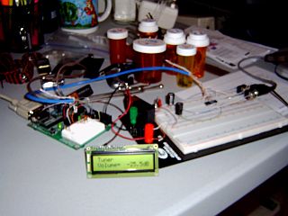

Thank you for the help. Duh - had shiftout set to lsbfirst. Also, attached is code segment w/back of napkin BS2 gain formula and serial LCD output. Additionally, this is a really great sounding chip - compares very well with higher end Burr-Brown ops amps I have heard - very cool
Thank you again, - ALBQ
code segment:
setting = abs((1 */ 8064) - (128 - abs(128 */ volume)))
low 6
pause 10
shiftout 7, 8, msbfirst, [volume\8,volume\8]
pause 10
high 6
serout 0,baud,[i,192, "Volume="]
serout 0,baud,[i,201, "-", dec setting,".",dec1 setting,"dB"]
