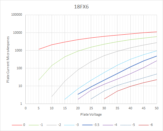

The name doesn't quite fit anymore though (the original's budget was under 40$, intended to be built p2p in a recycled case). And I wonder about the use of the 18FX6. Adapting it to the very common/easily sourced 12AU7 would have been a good idea.

18FX6 -- nice beefy tube, 2,2W dissipation if plate and screen are connected? mu looks like 6DJ8 ~36

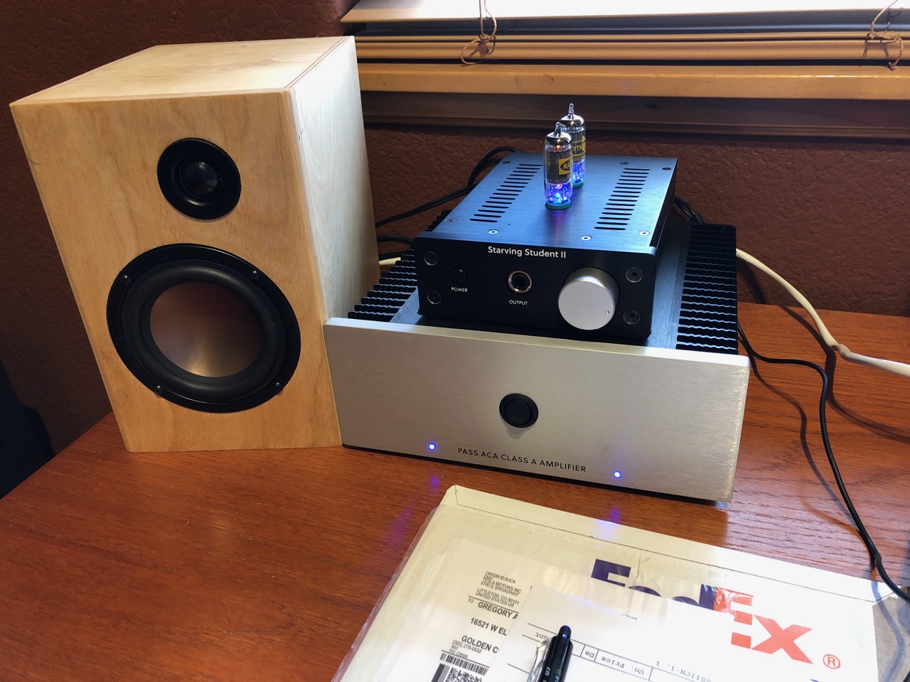

If you are on the fence about pulling the trigger, just do it. This is great little kit and sounds fantastic. The versatility of the build is amazing. Sounds amazing with an ACA, and I bet it would bring new life to many other amps out there.
This is my third DiyAudio build, and it was a great experience. I did the stuffing of the PCP over two shorter sessions over days, then final assembly during a third build session. No issues at all with kit and build. Teamed with the ACA I built last summer it is the best sounding desktop/computer system I have ever heard.
Kudos to 6L6 for his advice and guidance. Thanks to Pete Millett for the design and for sharing.
