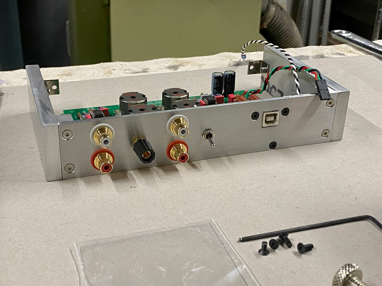

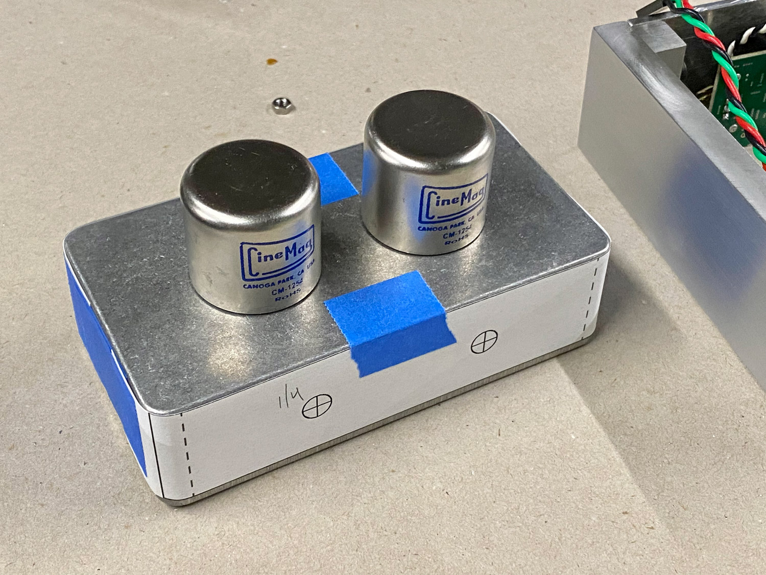

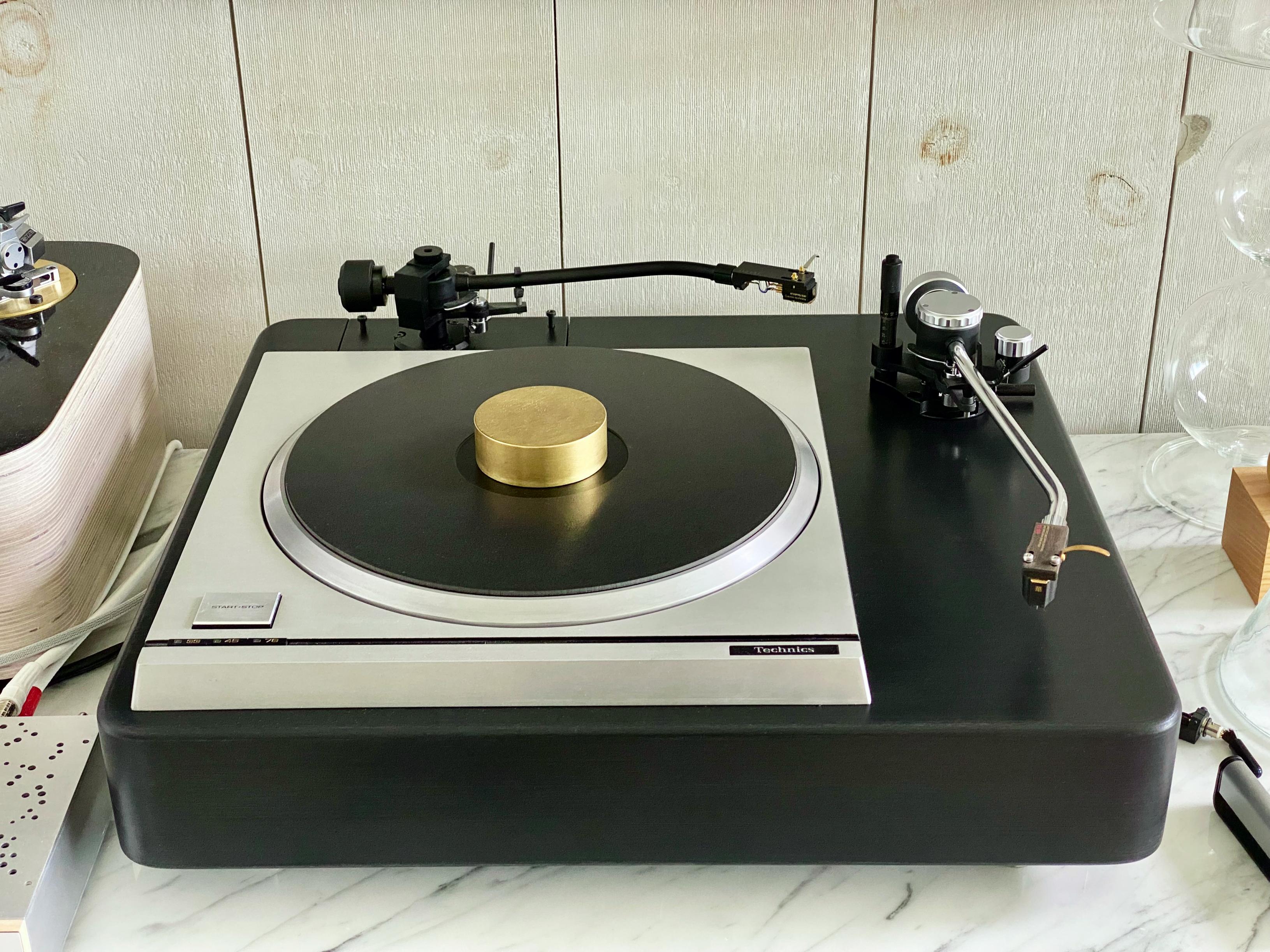

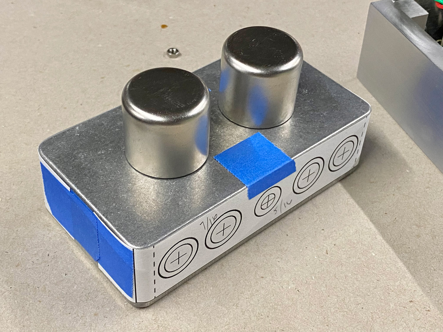

@mr ed. Did you ever build this? ... Here's mine in progress, along with the 2 arm plinth recently fabbed, upgrading from my single arm one, and a SUT head unit. Phono will be battery powered (silent swticher). My other phono amps.

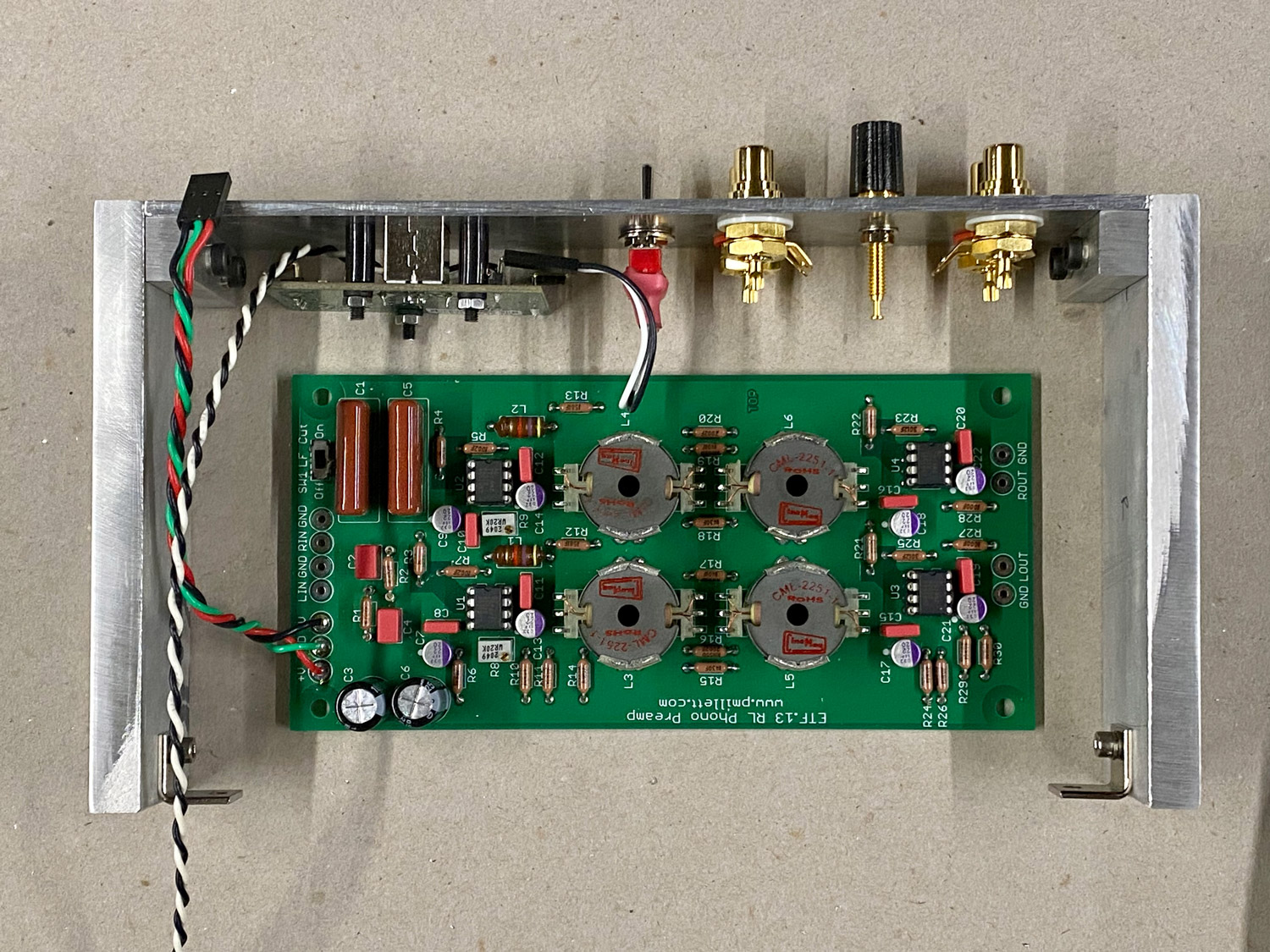

Actually, a little drama... I'm unable to zero the DC offset per Pete's succinct instructions on his site... So... looking into this (Can't get below 5VDC and 3VDC respectively with the 20K pot)...Silent Switcher is freaking awesome—works perfectly.
100%? I’m very trusting.. Pete’s instructions do say open…or rather “no input signal”… I sent him an email about it.. I can’t find any errors on the board or suspect joints. Also for fun I did feed it some music and saw some DC bouncing around on the outs.. more learning here to do for sure…

I’m feeding the stage with a LOMC cart, into some cinemag SUTs w/ switchable ratios, then to LR phono. I’ll plug an arm/cart into the board and see if I can null the DC on the outs, for curiosities sake, and maybe that’s the ticket…

Well...an update... plugged in an arm as suggested here... and zeroed the DC no problem. (was able to zero w inputs shorted from the get go—just confused by Pete's instructions as mentioned.) Unplugged the arm and DC is almost 14V, fwiw. So, note to self, I suppose. I'll report back with some pics when the chassis and SUT box is finished and I've had a listen...waiting on some materials. Thanks for suggestions guys!
Yes, its a DC coupled amp with over 60dB of DC gain... Unplug the input and the only route for the large bias current of the AD797 is through the 47k load resistor, and this offset voltage then gets multiplied by over 1000.Unplugged the arm and DC is almost 14V, fwiw.

My SUT box is almost complete...I'll probably have this project online by the weekend for some listening.

The AD797 bias current is about 0.25µA, which is 12mV across 47k resistor.
12mV +61dB = 13.5V,
12mV +41dB = 1.35V
Both are horrendous transients when unplugging a cartridge, but I guess if you use RCA connectors you are used to this with the ground disconnecting first (!).
If your power amp is DC-coupled this sort of DC offset is of genuine concern.
