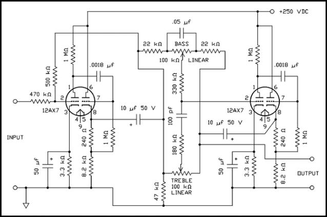

Forget tone controls. Tone controls done "right" require fairly sophisticated circuitry, including gain, and (IMO) are not in character with this project. Just use separate left and right channel volume controls. Alpha Taiwan makes OK controls that cost little money.

I've attached the schematic for a single channel of "proper" tone controls. Even if the cathode followers are replaced by ZVN0545A MOSFET source followers, you need a pair of 12AX7s, just for tone controls. A quad of tubes is needed if you forego "sand". Again, I ask, where's the room?

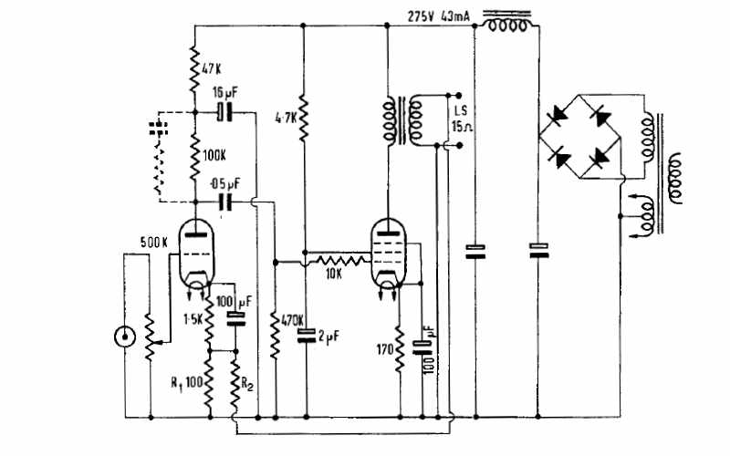

Eli, Thanks for all the info, I have decided to scrap the ideal of using the old chassis at all. I will build a amp from scratch and use the cabinet only to get the old school look. Later today I will have to gather parts once I decide which way to go. I think I will try to build it to be a nice amp if I have to start from scratch. Until I ge tthe parts I have decide to use the amp below to play with. Any suggestions on it would be appriciated.....thanks, matt
Any suggestions on it would be appreciated/QUOTE]
Here's a nice suggestion: redo all the first triode's circuit. Follow the attached
schematic. ECL86 is a very good sounding tube, but doesn't last that long so maybe you will need a new one for best sonics.
R2 sets the amount of feedback, here personal taste dictates but a value between 1.2 K -3.9 K. should be OK.
