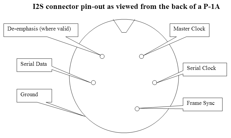

Additonal Information
To all that are using this thread please find a picture of the pin configuration of the P-1a (also P-3a) on the 5 Pin Mini Din for I2S connection .
I have linked a diagram on another thread which is not correct and I am going to correct that thread now . Please be careful as this configuration is for Audio Alchemy / Perpetual Technologies only and is not likely to work with other companies that use I2S (Stello being a case in point) .
