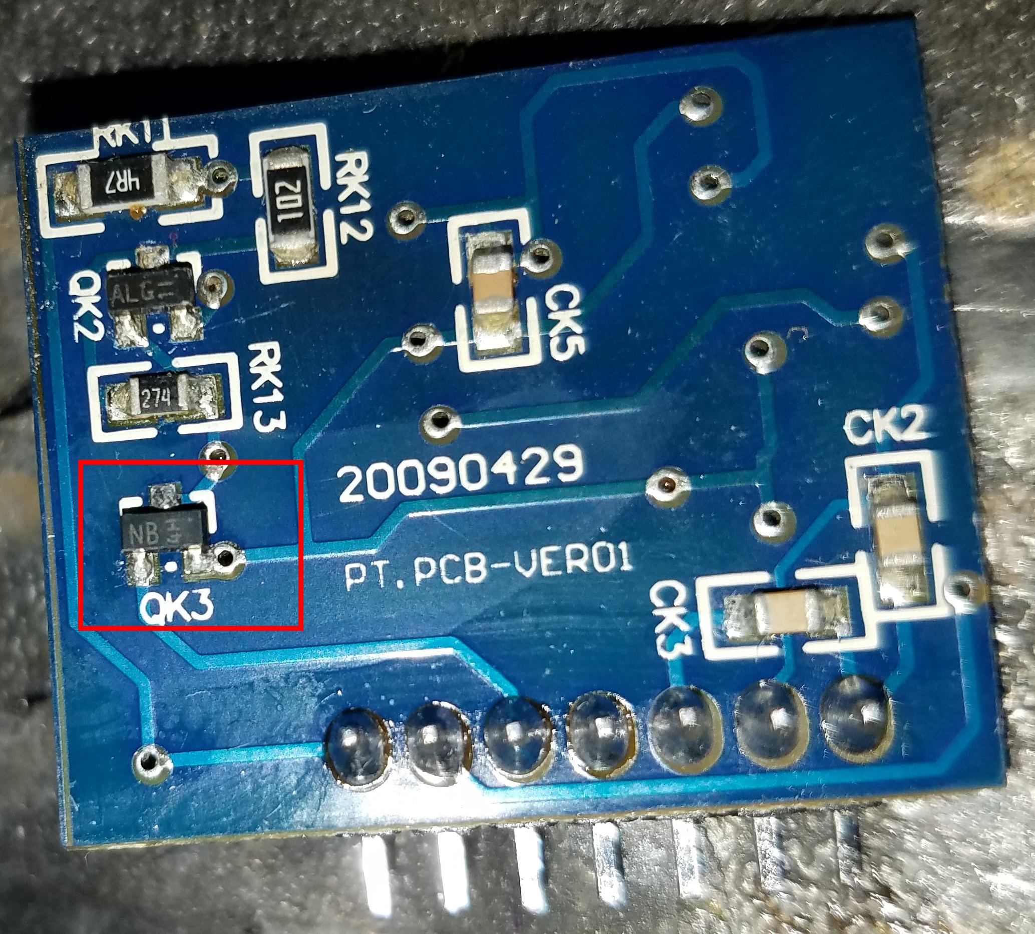

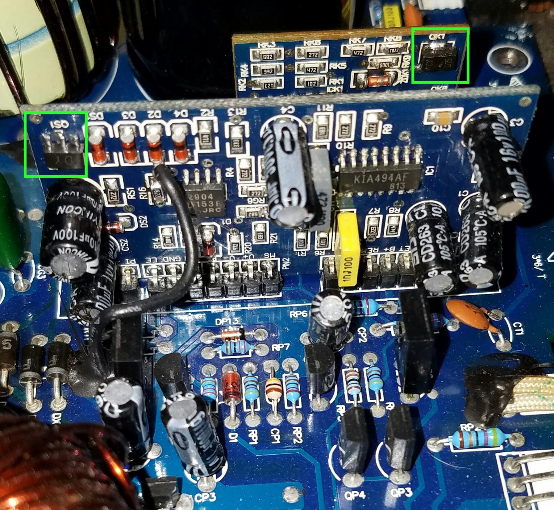

Hello ,Im working on this amp and need some help .
-The red light is on (no relay click, no sound ).
-If l remove QS1 or QK1 (green marks on picture) the amp gets out of protection and it works (clean sound ,no overheating ) ,so i think the output section is fine .
-I found a bad transistor on the back of the smaller board QK3 (red mark on picture), l did some research but i couldn`t find the part number, maybe someone here can help me identify this part.
Thanks in advance!

I took it out of the board and checked with my DMM and the only reading I get is 1.106 (diode mode) with negative test prove on center pin and red one on the right pin.I get nothing using other combinations ,thats why i assume is bad, unless this is a special type of transistor.
Thanks Perry, i just checked resistance between Pin 1 and 2 ,I get about 20K ohms ,so this is a KRC102S ,at least is not shorted and internal resistors are still ok .Ill keep looking to find out what is triggering the protection circuit.
