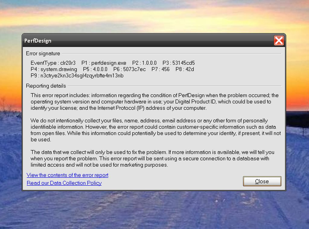

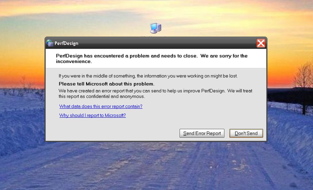

I just tried to test out your software and it doesn't seem to work for me.
I am using XP64, I will try it again later on my Win7 machine.
I have Netframe 4.0 installed as I have VS2010 installed as well.

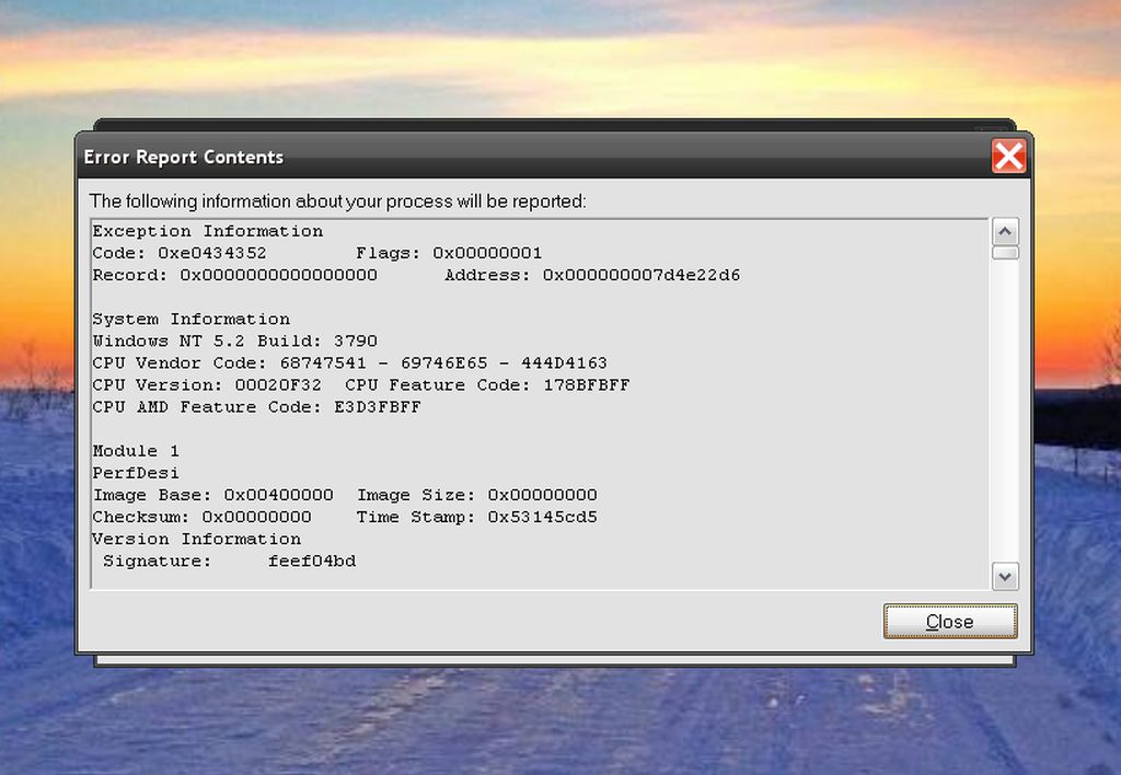

Hi Gerald. Thank you for trying out my new software.
I don't know why the program crashed. I haven't tested it yet on XP systems. I can't figure it out from the picture you sent, try clicking on the "What data does this error report contain?" and post the result here, maybe i can figure something out from the data.

Verify whether you have installed XP Service Pack 3. .NET requires XP-SP3 or higher, along with many other updates.
XP64 does not have a SP3 available for it.
SP3 is only for XP 32bit users.
jer 🙂
