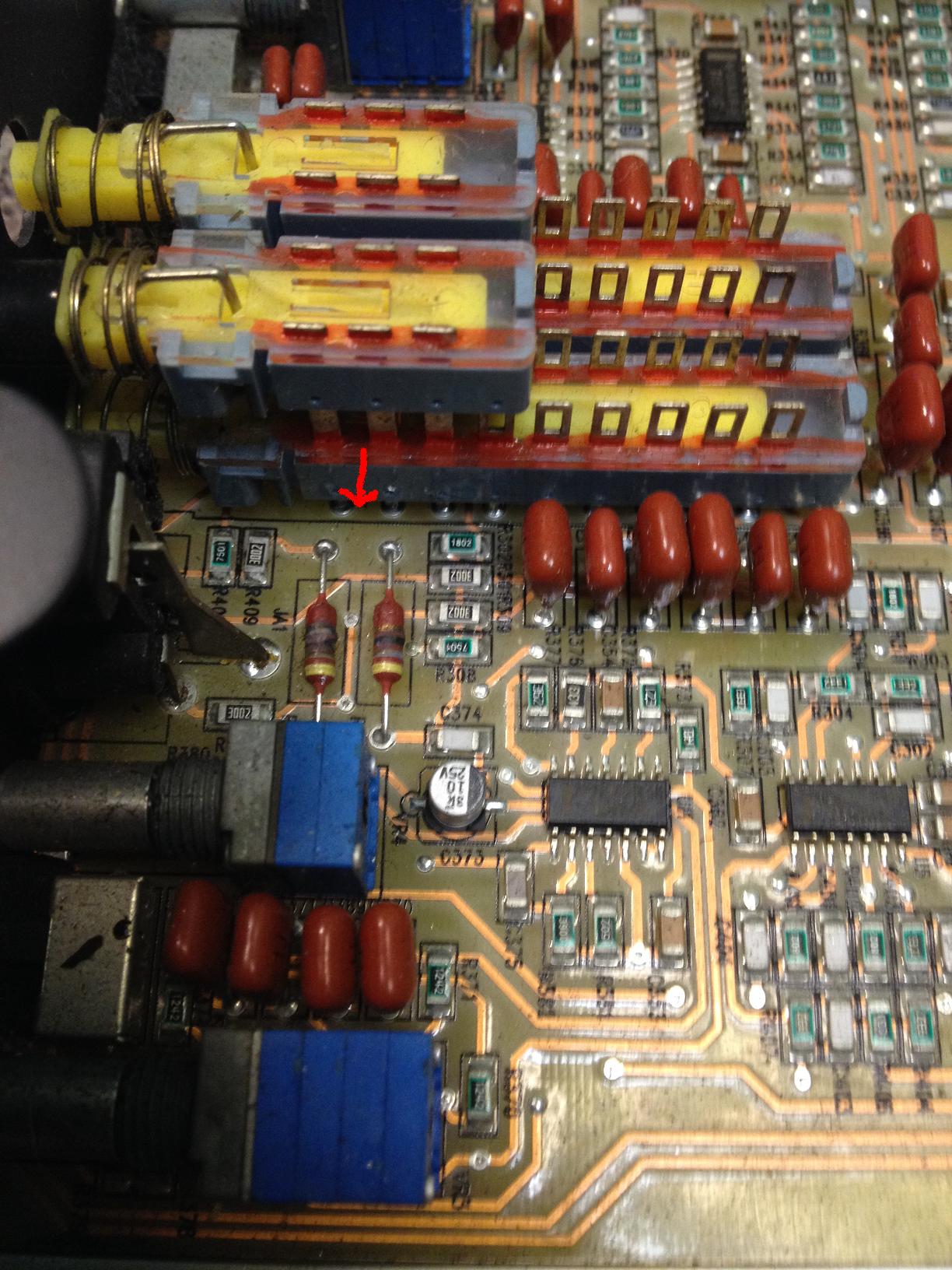

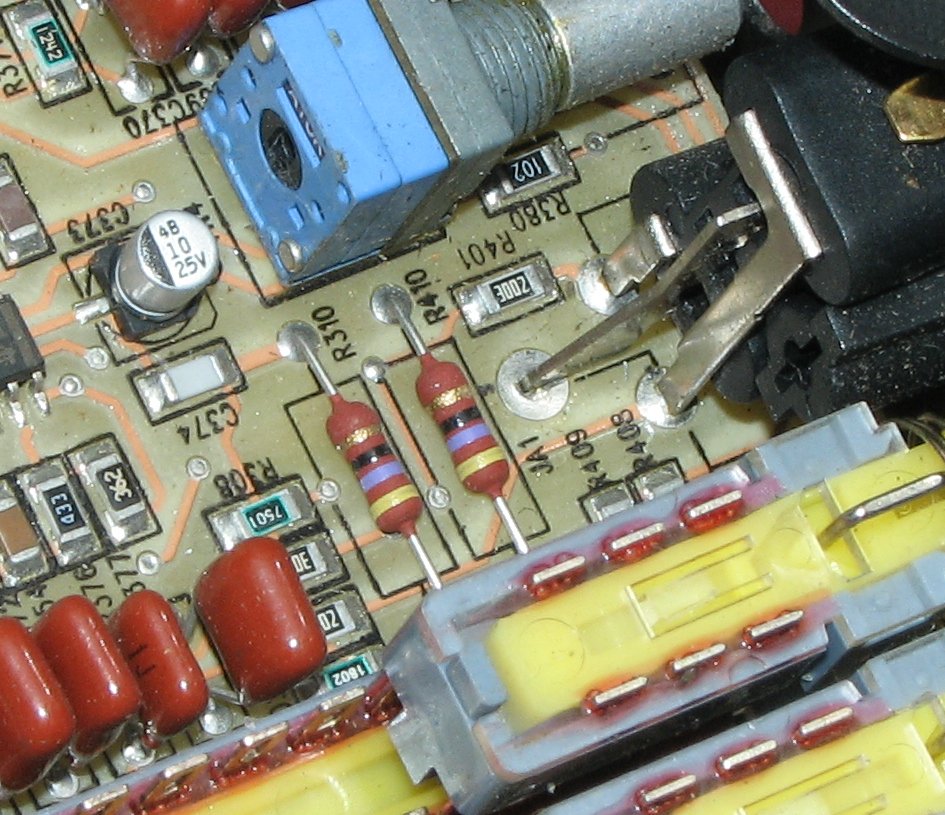

Are these 1/4 watt?
Or are they 1 watt do you know by chance?
Reason i ask is because ive orderd resistor from Digikey before and the 1 watt resistors are in a 1/4 size

A resistor's size is determined by the heat that the components that it's made of can withstand. Smaller resistors with high power ratings are made of components that can operate at higher temperatures than common resistors. When I order resistors rated for more than 1/4w from DK, I generally order the light-blue Panasonic resistors.
I don't know what the rating on the original resistors is. They are connected between the RCA shield and the secondary ground. There is essentially no current through them during normal operation.
