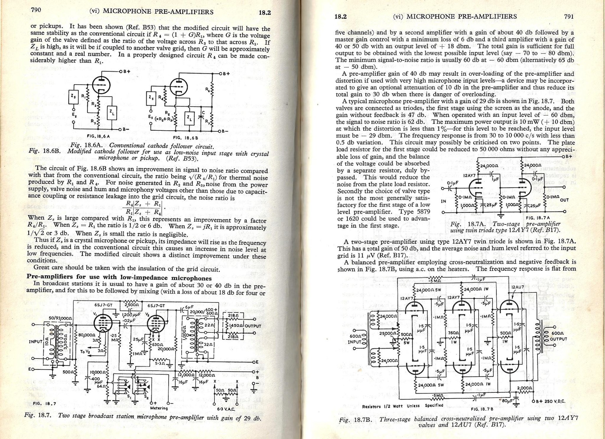

Like this one at bottom of p790, RDH4? This uses a 6SJ7, I tried it circaThere is a side-show. If you want a small triode of moderate gain for low levels and at minimum weight, use 6AU6 taking G2 as "plate" then G3 and real plate to ground/cathode for built-in shielding. BBC did this on some OB (remote) mix-boxes
in a small mixer using a 6SJ7, worked well them 👍
