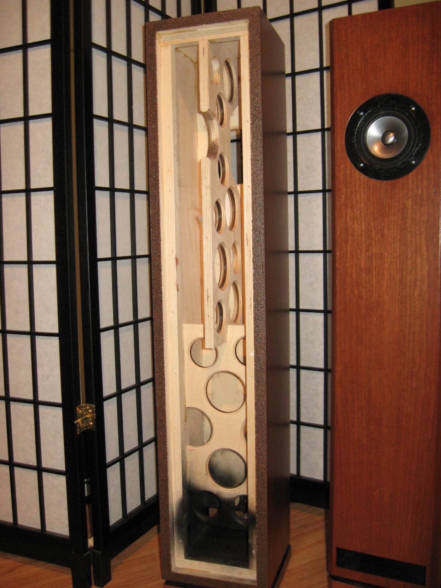

Need some help with a pensil build, while the speakers are slowly being warmed up.
Due to restricted materials availability locally, the intended cabinets are posing problems by either quality of ply available, or restricted thicknesses (I am off the normal map if you will). I even considered building the main cabinet in 20mm granite which is available, until I worked out the hernia inducing weight of a single speaker. 😱
I even considered using 40mm beech worktop for the sides as it was more consistent than the ply here.🙄
With the throat thickness for the pensil baffle defined as 18 - 20mm, is there a way in which a thicker material can be used (and round the throat edges), or would that have a detrimental effect otherwise ?

Thanks Scott,
I realised the limits 18-20mm from reading earlier postings, but I was wondering if more like 30 or 40mm could be viable with a taper on the inner bottom part of the baffle to hit the 20mm mark or chamfer/fillet the throat to hit the 20mm on the flat.

If you're able to taper a significant part of the baffle, then yes. If you're talking about a simple chamfer of the back edge of the vent, then unfortunately not. The extra length will lower Fb somewhat away from the stock alignment. However, the difference won't be all that much, so I wouldn't worry about it too much.
Having heard speakers made from both solid stone (diamond cored basalt) and "Corian" or equivalent acrylic solid surface counter-top material, I'd say stick with the plywood.
And as boblamont mentioned, good luck finding a shop able to rebate holes for flush mounting the drivers in solid granite, as well the requisite rear side chamfer. Through holes and some degree of profiled edges are easy enough, but if the technology exists to achieve a clean rebated round hole, the machine time would likely cost more than enough high quality plywood to complete the project.
If you need to use the thicker wood material for the front baffle, a few cross-cut passes with a dado blade could effectively reduce the thickness in the vicinity of the vent. You'd also need a deeper chamfer at the driver opening.

The stoneworker guy said he could do it Chris, but warned against it.
He pointed to the weakness of the thin granite left at the back of the speaker rebate through which the mounting screws would have to mounted, the screws applying pressure radially on a thin flange. Granite does not give or form a thread tap like plywood, it fractures. He was not happy about the amount of meat left on the periphery of the baffle at the driver either.
If I have to go thicker for the baffle, it will be a long taper as both suggested.

Just use 18mm Baltic Birch ply. It is probably the best material out there for loudspeakers. It should be readily available, if not then buy from ebay.

For the 7.3s you can get away quite nicely with 15mm plywood of decent quality, and even with the smaller drivers, I wouldn't consider the Pensils without some front to back and lateral bracing.
Regarding 18mm ply and having read about Bob Brines new 12mm ply M12 MLTL, I built a 12mm version of my 18mm Fe168 MLTL and I hear no difference at all between them, the bracing is the same in both.

I am working on (applying veneer now) a 12mm version of my M10-A10 tweaked to work with the A10P. I here no difference between the thin version and the original built with 18mm material. This is real hardwood Russian birch, not the softwood Chinese knockoff.
IMO 12mm BB/Russian birch is good to ~12" panel widths with only a 12x50mm panel stiffener. I do use window braces around the driver and a 24mm top panel. Gives the whole structure a nice sounding knuckle rap.The long panels of a MLTL don't sound so firm, but once 24mm of type 700 fiberglass lining is applied, the cabinet is sufficiently quiet.

The Pensil design family is by Scott Lindgren - the bracing & aesthetic flourishes in the photoed pair have become a bit of a signature by the Planet10 team.
The "details" are that I built as per the drawing (with extra bracing), chamfered the long front edges, added grilles and a 1" plinth echoing the footprint with a 1/4" recessed spacer to create a shadow reveal line - pretty standard stuff.
Chris,
Is there any particular reason that these holey plate type braces are better than say hardwood dowels or battens randomly spaced?
I can see that front to back and top to bottom would be firmly linked by this arrangement, but would cross dowels not lock the side panels adequately?
