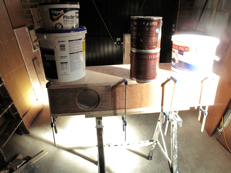

Well I've eventually started the prep for the Pensil 7's build. Started running in the drivers. They are just in their boxes and wired up to an old stereo at the moment but are already sounding pretty good. Also designed and made a router jig and started work on the baffles.

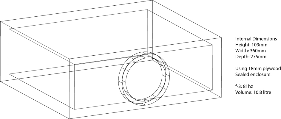

I've also done some initial calculations for the centre speaker. Attached are the plans and dimensions. The design is for a sealed enclosure with an F-3 of 81hz.
A couple of questions about the design are:
As the baffle isn't very high (internal hight of only 109mm) will their be any problems having the driver so close to the wall?
Would I need to consider any form of BSC for the design?
Any feedback would be much appreciated.
Mark

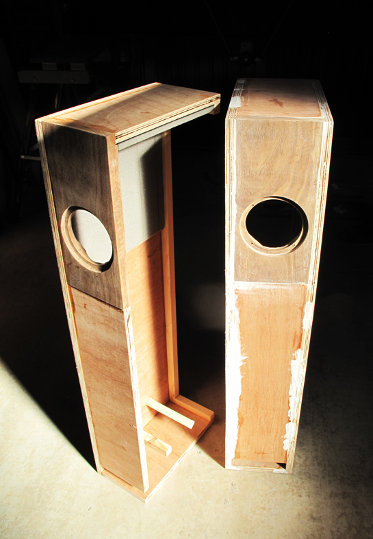

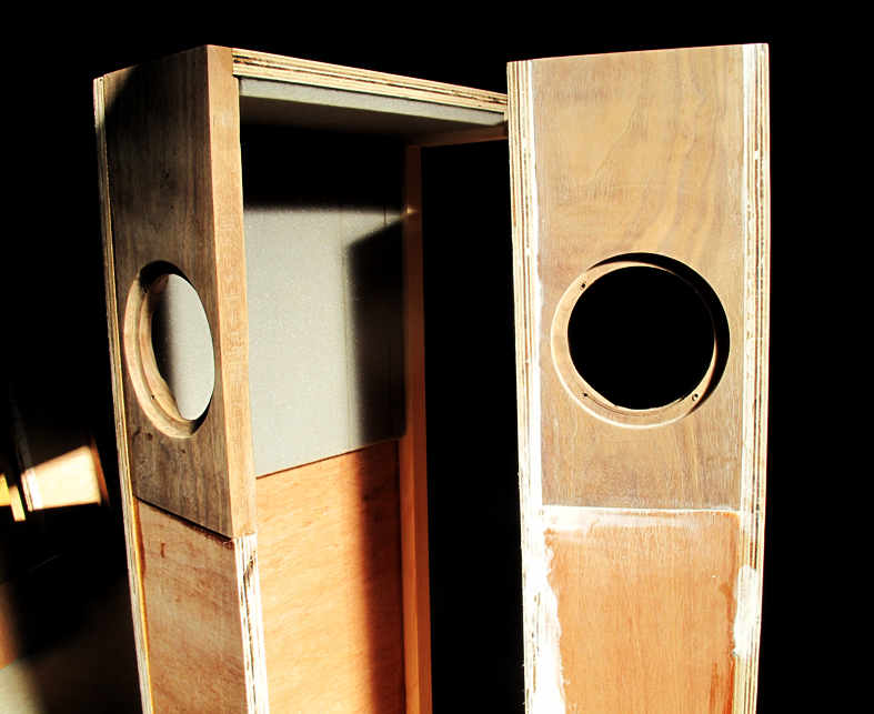

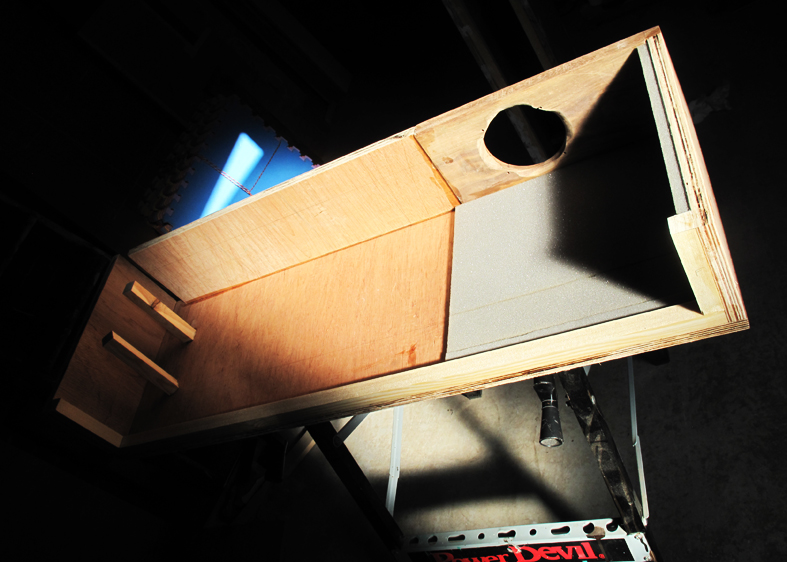

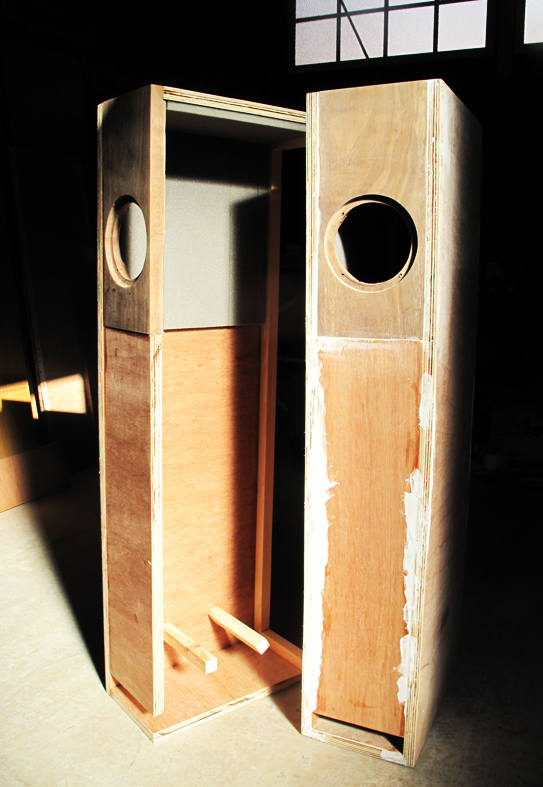

It’s been a while since my last post so I thought I’d give an update on the Pensil build. Finding time to dedicate to the build has been tricky but I think I’m nearly there.
This is the first speaker build I’ve done but me being me, I couldn’t just follow the plans, I had to tinker.
As you can see from the pictures I’ve used a piece of walnut on the baffle, where the driver sits. As the walnut width is a few millimetre smaller than the plans I re-calculated the speaker and vent dimensions to maintain the original volume.
Lesson 1: Check measurements. Check measurements. And check again.
As the eagle eyed reader has probably noticed, the cleats for fixing the back panel are flush with back of the cabinet. After much swearing and rechecking of measurements I had to accept I’d got it wrong and the only way to get around this without scrapping the wood was to trim the side panels and have the back panel fixed directly on, rather than set in. This now means I’ve got a bit of a job to make sure the seal is as airtight as I can make it.
One of the hardest things I’ve found with the build is cutting the plywood accurately. Trying to make millimetre accurate cuts with a circular saw is pretty difficult. And even when using hand saws, getting everything exact has taken some patience.
How sensitive is the Pensil design when it comes to measurements? Even re-measuring and re-calculating every time I cut and sand panels their are still slight differences between what I have and the plans.
Hoping to get the cabinets finished this month and then start designing and building the centre speaker. Final stages are to sand, paint and add the stuffing before fixing the drivers and start to test the speakers. The plan is to paint the main body of the cabinet white and wax the walnut. This should look fantastic once the natural paper CHP70’s are fitted.
I’ll post more pictures as I progress.
Mark

The alignment deliberately has a high internal volume since it's meant to be flexible; as such, within reason, a mm or so out isn't the end of the world.
