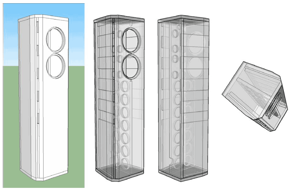

Okay, so I figured it would be best to start my own thread about this rather than clogging up another existing thread of someone else's. http://www.diyaudio.com/forums/markaudio/249666-chr-70a-gen3-dual-driver-pensil-6.html
As I stated in that thread, I have a pair of barely used Alpair 10.2's that I want to work with. I'm tired of seeing them going to waste in the closet. I was reading through that thread above about using dual drivers in a Pensil design. I want to do the same, only using larger drivers and twice as many. Yes, I want to use no less than four Alpair 10.2's per enclosure.
I want to make this a 1.5-way design, rolling off the two bottom drivers at a certain frequency to help out with bass duty, sharing the load and drastically reducing excursion and distortion while reinforcing bass output to create a more "full range" speaker. I want to avoid subwoofers altogether as that's an added expense I don't want as well as more clutter and room in an already limited area.
I've read that the CHR 70's are capable of output into the upper 30Hz range in a Pensil. Since I have 10.2's which are already capable of lower extension, I should have no problems reaching down into the low 30's or possibly upper 20Hz range with four of them running per channel.
Size of the enclosure is not an issue as I'm used to somewhat large enclosures already. I own a pair of NHT 2.9's which stand 40" tall and 22" deep. I'm currently borrowing a pair of Polk Audio RTi12's which are nearly 50" tall and 20" deep. If I had to guess, I'd say Pensil's large enough to properly load a quad of 10.2's would probably end up being around the size of the Polk's or something close which is completely fine with me.
Of course, I'm not committed to just the Pensil design. I'm open to any design that will allow these drivers to perform, meaning really good bass extension while staying crisp, tight and detailed in the bass, excellent mids and vocals which these MA drivers are known for, natural, smooth highs and an accurate, clean, balanced sound overall.

You already have 4? Or just the pair mentioned? If the latter you are now on a search for a 2nd set of A10.2.
4 won't give you more extension, just more omff...
Size of the enclosure is not an issue as I'm used to somewhat large enclosures already... Of course, I'm not committed to just the Pensil design.
Twin Pensil would double the cross-section and the vent area. If really big is not an issue you could consider stacked Frugel-Horn XL, or the Twin Mar-Ken10.2TT (won't go as low).

Go FAST. Use a real woofer on the bottom. The magic happens on the top. The Alpairs are great on the top, but give them a break on the bottom. Intermodulation/doppler/phase distortion is real. if the XO is below 250Hz or so, IM is reduced to near zero.

No, I'm not in search for another pair of 10.2's. I'm in search for THREE more pairs. Remember, I'm going for a total of FOUR 10.2's per cabinet/channel.
I know more won't give me more extension. What I'm looking for is more "oomph" as you said. Clean, clear, crisp output top to bottom with nothing but EIGHT 10.2's running. I was just saying that if the CHR 70's are capable of upper 30's, I should be able to get lower than that with the 10.2's.
I want to keep the enclosures somewhat simple, meaning no horn designs. Size isn't much of an issue, but I don't want them standing 7' tall either. 😉

I can see using a pair, going to 4 makes less sense than adding a big helper woofer.

Unless loud is a goal, 2 FRs as mid-tweeter is a step backward from a single.
With a single A10.2 & a passive XO you will want woofwe(s) that are 90-93 dB sensitive.
