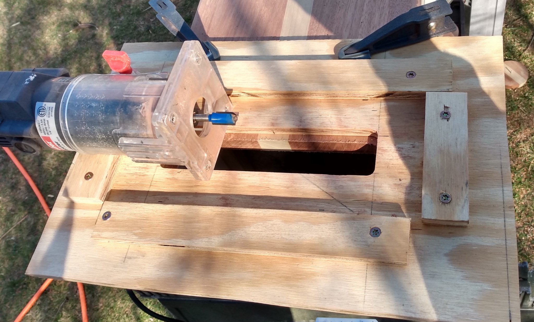

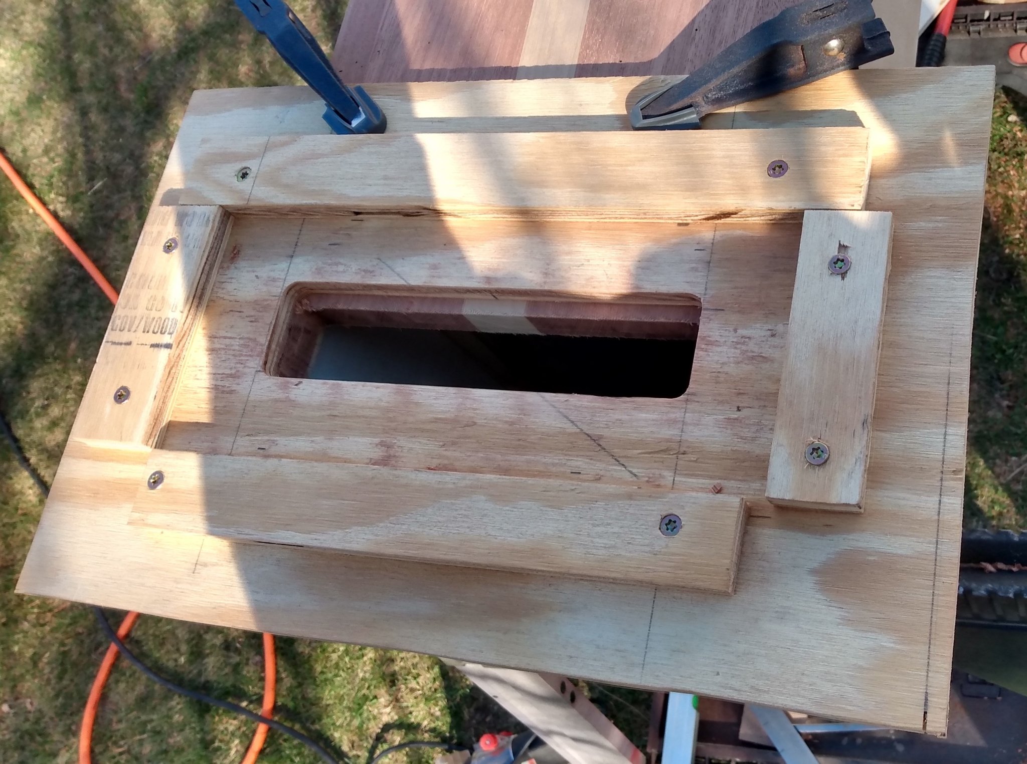

DIY Pensil 10.2 speakers are finished! Quite a project saving the bamboo cabinets that simply didn't want to cooperate! I'll be doing a whole article on my web page soon...www.rvbprecison.com

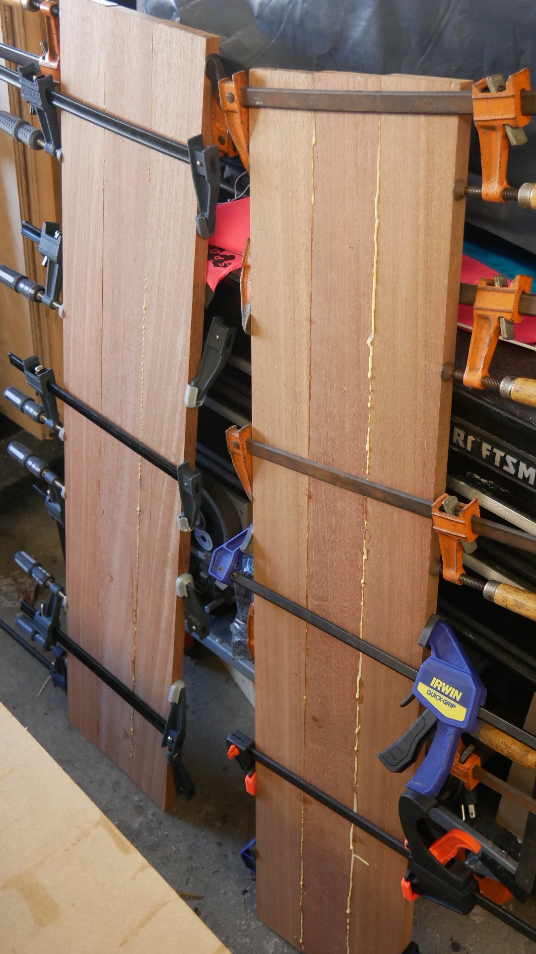

Thanks ChrisB....Yes, it is a glue up of four strips of African Mahogany and the center strip is Poplar. This glue up is 3/4" thick, it is then glued and screwed to a 1/2" piece of bamboo plywood. The walls are 1/2" bamboo plywood with 1/4" MDF glued with a resilient adhesive of about 1/16" thick.......They are TOTALLY non resonant.....(Well, there isn't anything that is TOTALLY non resonant!).......But they are VERY solid.....I'm pleased with the total outcome....

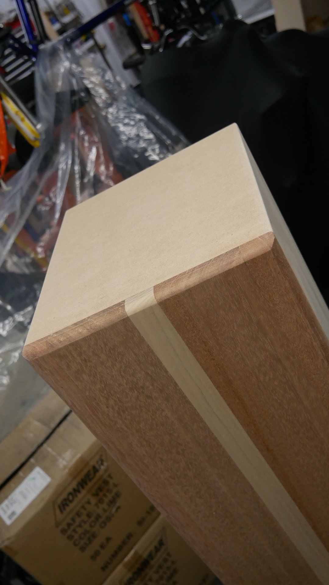

As you might be able to see in the above photo, the center strip of poplar is missing. Well, my calculations were a bit messed up. After edge planning the pieces for this glue up, I found I was about 1/4" too narrow for the existing cabinet, once I added the MDF and the 1/16" of resilient material. And I was out of the African Mahogany.......Over in the corner of the shop was that piece pf poplar......... Rip the panel down the middle and add it...BOOM! Done!. 🙂
