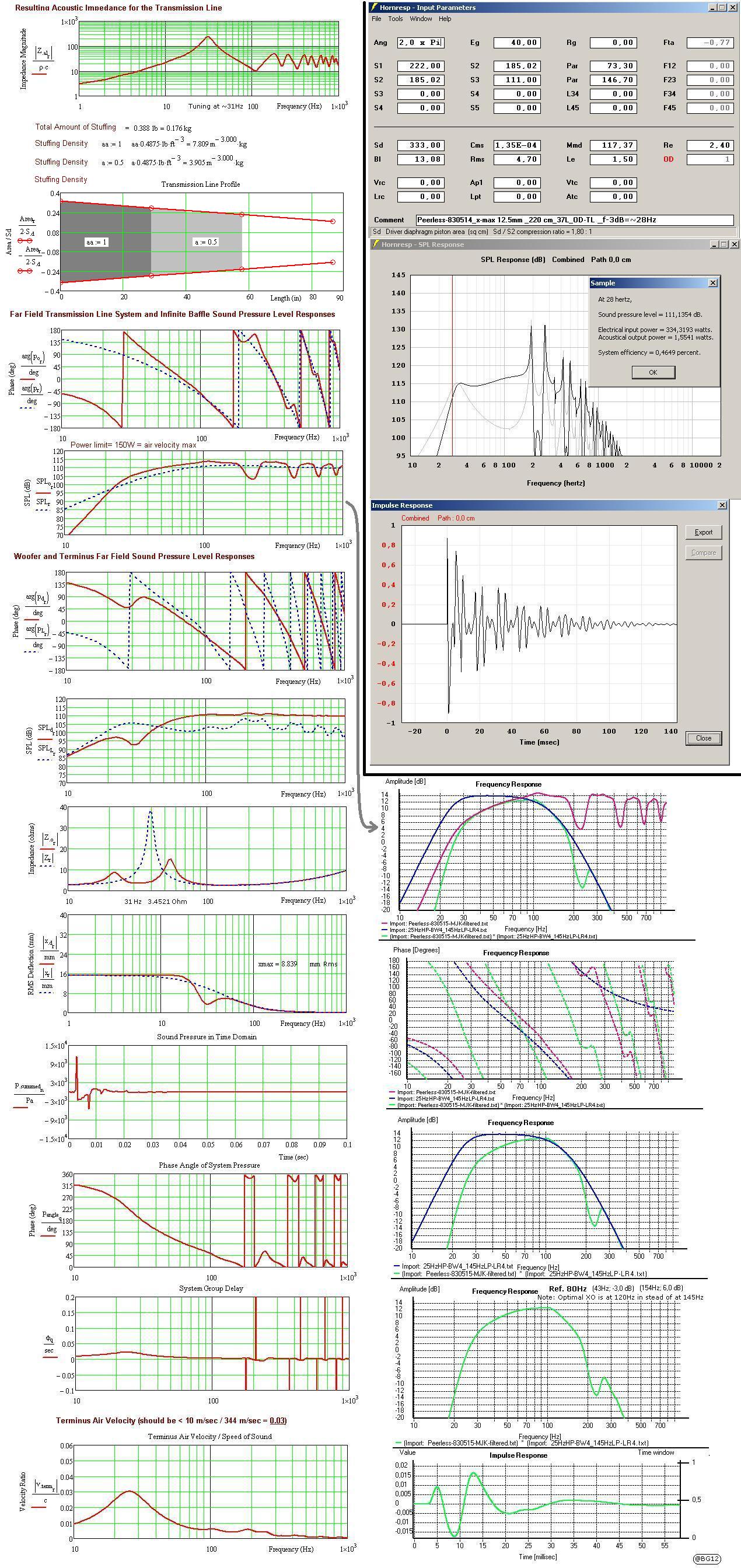

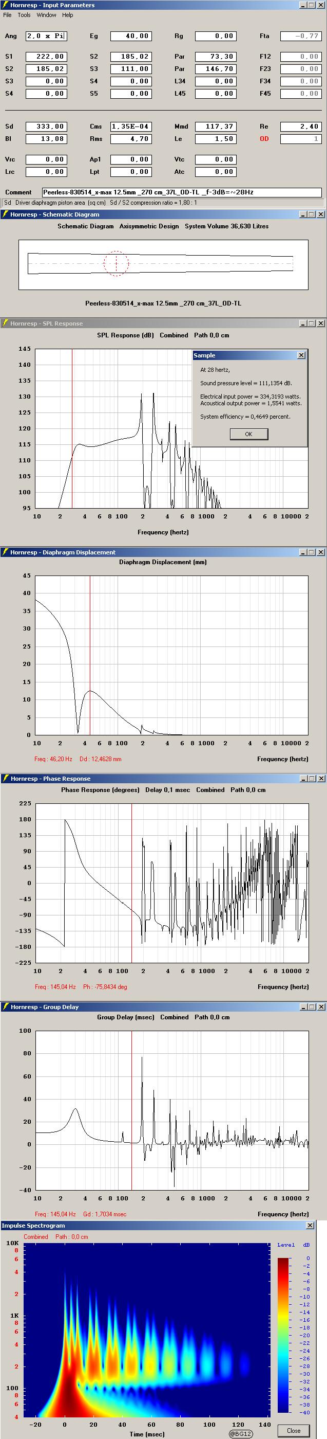

Hi, I liked your requirements despite 😱 the Car-TS-data for the drivers...
Here is a suggestion I think comes near:
First 150 Hz XO using a 24 dB/octave filter should be IMO relaxed to 145 Hz as a LR4 would then be 20 dB down at 250 Hz, thus would not 'push' down the phantoms towards the floor when listening to the subs placed close and summed to the mains.
When stuffed with damping material the FR slope will be smooth and gentle sloping like for a Qtc=0.5 closed box. Off-band ripple will be benign.
The suggested OD-TL have a sufficient wide BW and good phase/Gldy and the driver 'sees' an equivalent of Qt very near 0.5(If the terminus is closed).
The OD-TL must be stuffed and also used with a sub-amp providing a HPF at ~30HZ.

..The OD-TL must be stuffed and also used with a sub-amp providing a HPF at ~30HZ..
More information here:
b🙂
