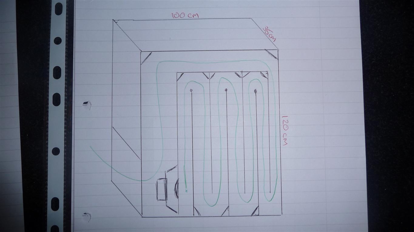

Hi everyone, i have two peerless 830452 subwoofers that i would love to use in a horn build, an member in this section wanted to build a horn sub with a similar peerless driver, and the models seemed to be very positive.
I want to build two, each with one woofer, size wise i am looking for around 120cm by 100cm by 35-40cm, smaller would be better.
For a tune is was thinking 15-18Hz low knee (if thats the right term!), I have built many other subs in the last few years, mostly ported and some sealed, i cannot figure out horn response at all, winISD no problem, but its not applicable for this build.

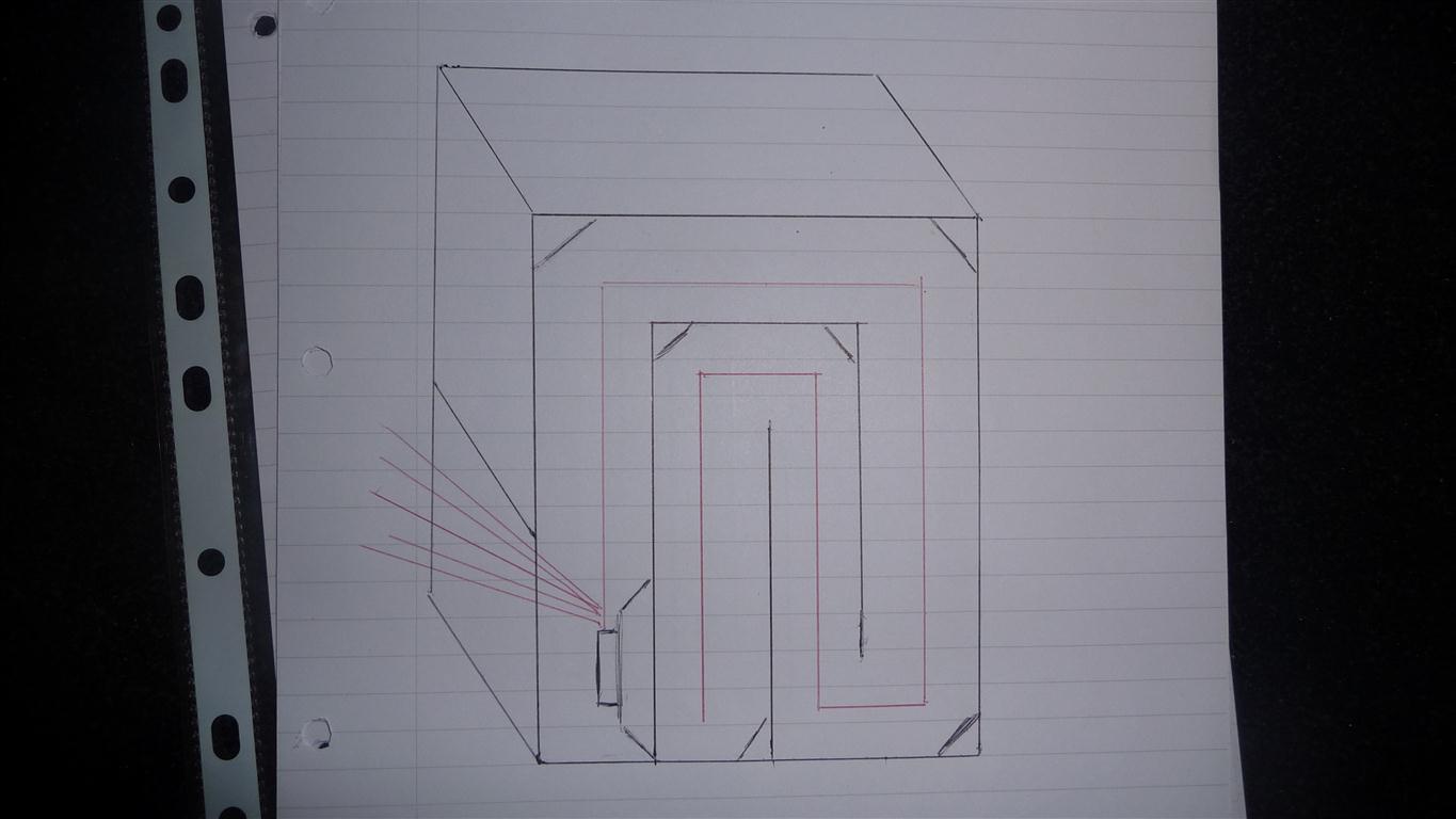

I have an basic idea for the folding (which are sketchy at best, get it😛) although it looks more like a transmission line, i was just getting an idea of the
horn path length.

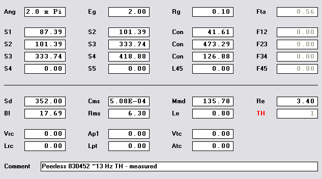

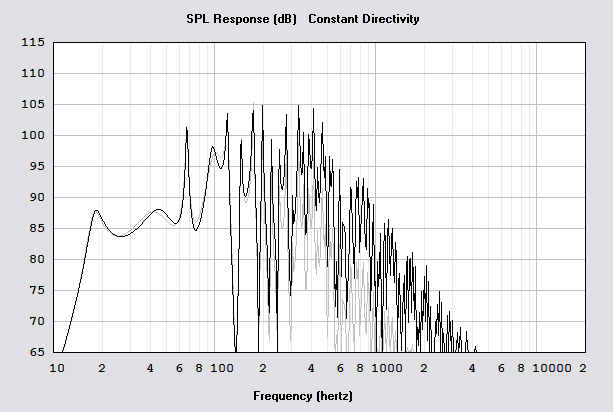

Greets!
I simmed both sets of specs and virtually no difference even with the big difference in inductance, though of course the proof is in the building/measuring.
Anyway, not a lot going on at rated power down low, though two subs not too far apart will sum at the long WLs, so combined with a bit of room/boundary gain they should be OK for all but a few movies and pipe organ symphonies unless a high pass is used to protect them. Overall though not too shabby for only ~149 L net.
As you can see in the sim, it's already a little under-damped, though from others measured builds it should be somewhat smoother in reality, so this driver's specs doesn't really want to 'feel' anywhere near a 10 ft^3 cab without either adding some series resistance or tuning it lower. Of course you can always double each section's area to get your 10+ ft^3 net or some other net Vb by using whatever fraction is required.
GM

Thanks for the input guys, very helpful.
Thats looks like some pretty decent Spl for a 10", in terms of physical layout of the horn and folding, was there a copy of the spud diagram that i could copy in terms of path length, and just adjust the cross sectional area, as i am only using
a 10" single, vs two 12" drivers?
Would 15mm ply do for this build or is 18mm a must?
