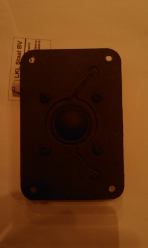

I am looking for an old model peerless tweeters but cant seem to find information about them. Maybe someone on the forum can tell me what model they are, and maybe where i van find them.
I know they are out of production so i am also considering an alternative, closest i could find was the peerless DT-105H but since i dont know the characteristics i cant be sure.
Thanx !

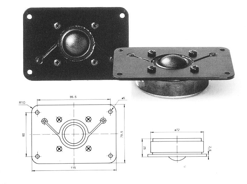

I know those Peerless KO10DT tweeters intimately, the top end is
not good at all and a modern tweeter will likely work much better.
The size is very similar to the ubiquitous 12cm x 9cm Audax.
🙂/sreten.

Tnx for the info,
I didnt know the tweeter didn't perform well at the top range, shape at the moment isn't really a problem since i am building the speaker myself.
I do have a Kef t27 so that might be an option, is there another tweeter u would recommend in stead of the Peerless ?
What speakers are you building ? The T27 may or may not suit.
FWIW the soft domes of that period were in breakup mode in
the top octave, with a treble rise being very common, especially
in tweeters left over from a selection process for manafacturers.
🙂/sreten.
