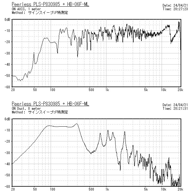

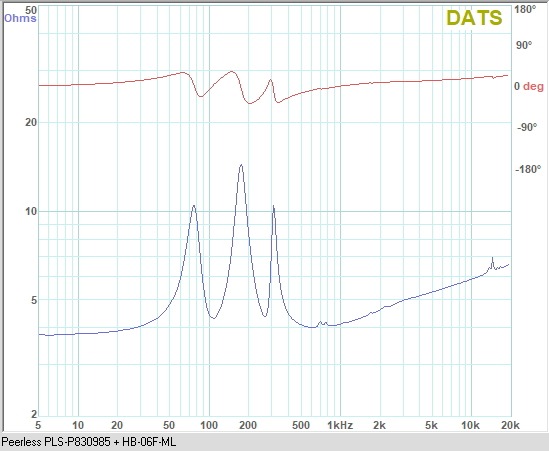

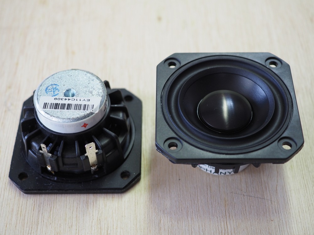

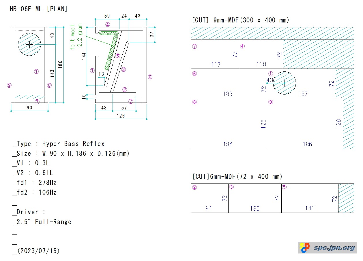

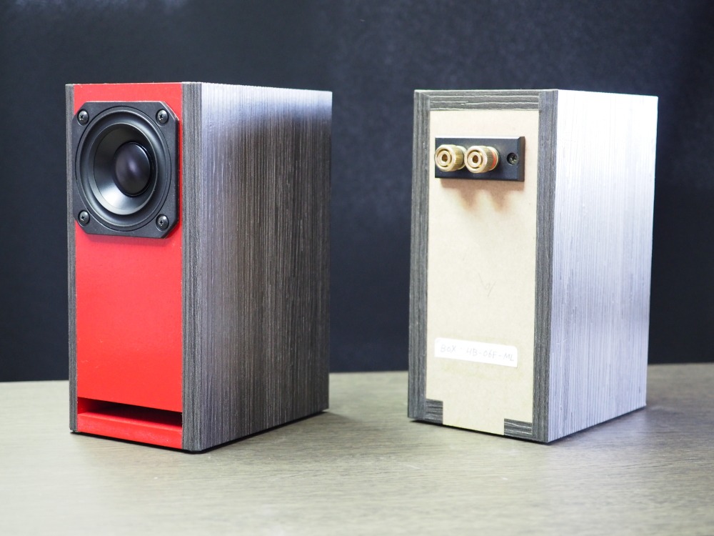

Peerless PLS-P830985 (2.5" Full-Range) + HB-06F-ML (mini speaker)
I purchased P830985 about 10 years ago for 980 yen per piece (6.34 USD at current rate).
It was sold by a Japanese discount store from the manufacturer's large inventory.
This driver is well balanced and can put a lot of power. It is a true little giant that can be used with many different types of boxes.

I think I have some of these! Do you have plans of the boxes? 🙂
edit: oh mine are PLS-75F25AL02-08 😕

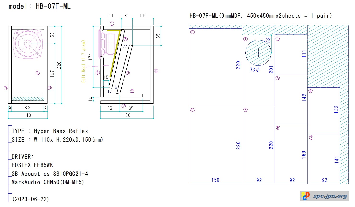

PLS-75F25AL02-08 would fit in HB-07F-ML.
Is there any possibility you can do level-referenced distortion measurements?
Sorry, distortion cannot be measured.

I was interested in building this HB7 design with the MarkAudio chn50, but noticed that the outside diameter of it is 103mm and the front is only 92mm...
Anyone built this combination?
Would it be better to use the chn40 (which, remarkably enough, has a lower resonance frequency) or the Peerless P830985 ?
And then in the hb6 or hb7?
Any advice appreciated!

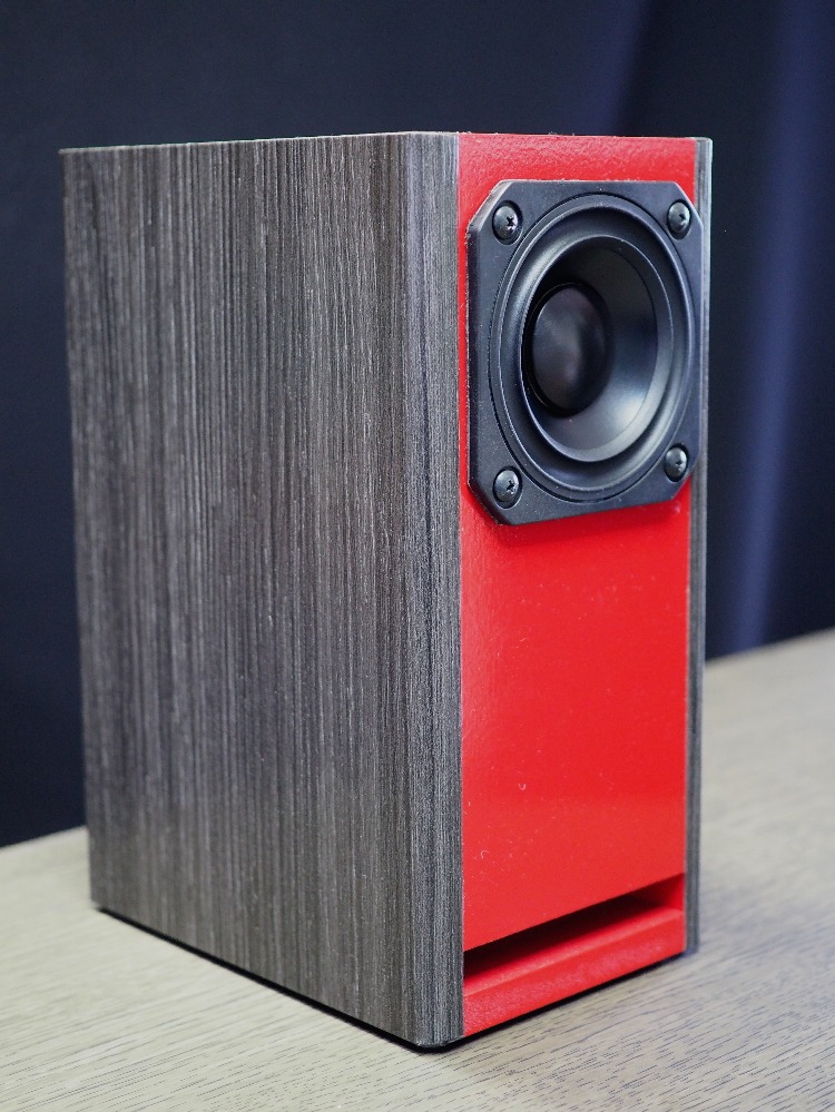

It looks a bit like a child with a water head 😉 with those wide flanges up to the border.
No problem that they are not countersunk in the baffle?
I guess it will show better if the whole baffle would be black. Or use 12mm ply.
I read somewhere that these boxes sound best with female voices, which you chose indeed as well.
How do they sound, for example, with rock or piano?
Can you comment on the sound difference between chn50 and peerless or tang?

Hi Dupt.
All my enclosures do not have countersunk.
I don't know, I rarely listen to rock at home.
Other genres do not make a big difference.

Hi @nandappe I'm trying to make up my mind which cabinet with which driver to build. I might choose to make two and compare, but can you tell how you choose or which specs are of decisive effect to fit a driver into a certain cabinet.
For example, I saw that you choose to put the CHN50 into the HB-07F-ML cabinet, but it would also fit into the HB-06F, which has the same width but is higher/bigger. I'd expect the HB-06F would give better bass for example. Is this a matter of trial and error, or can I use technical specs as a guide line to choose (and which)?
Thank you for your designs and inspiration!
Reactions: nandappe
Hi Dupt.
If you have space for a larger size, you should choose the larger one.
Basically, the smaller size has less and tighter bass volume and the larger size has more bass volume.
The mids and highs do not differ as much as the bass.
HB-08F is used by many and is my favorite.
