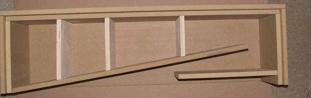

I cut all the wood for this project today. It took a couple of hours after planning. I made the top, bottom and front double thickness 3/4" mdf for greater rigidity, and also allowing me to do a 1 1/2" roundover without putting the stringers in the corners. I am also using baltic birch plywood for the internal braces for more rigidity.
The mdf is quite heavy, and it will be a bit of a hassle moving around the finished speakers, but they should still weigh less then my Thor TL speakers, which are 3/4" mdf covered in 3/4" solid oak on both sides.
I forgot to bring my camera to my roommate's garage when we were cutting the wood. I will try to take pictures the next time we go to cut wood. It fits together quite nicely.
We also cut the wood for my roommate'sMJK's ML TQWT FE-164 based speakers, and it was quite a challenge getting the large non-rectangular pieces cut and organized to work together. We are doing double sides on this project also, in order to make it more solid, and allow for a 1 1/2" roundover. It took us 3 hours to cut the wood for this project, including the time planning the cuts, and trying to remember geometry lessons from long ago to calculate the angle to cut the side panels.
Good luck with your project. I will post pictures to my gallery ( http://brian.darg.net/audio ), once I take them. I am still awaiting my biscuit cutter (plate joiner). I ordered it from amazon at the end of december, and it has been delayed 3 times, so I cancelled it and will get from another vendor next week, then I can begin assembly hopefully soon 🙂

I finally took some pictures of the wood that I cut out. I put them together just to show how the wood goes together. I have a biscuit cutter (plate joiner) now, so I will use that to assemble them pretty soon. The top, bottom and front are double thickness. All wood is 3/4" mdf, except for the braces, which are 3/4" baltic birch (suggestion by Bob for greater rigidity)
picture from my gallery at: http://brian.darg.net/peerlesstl
Brian
