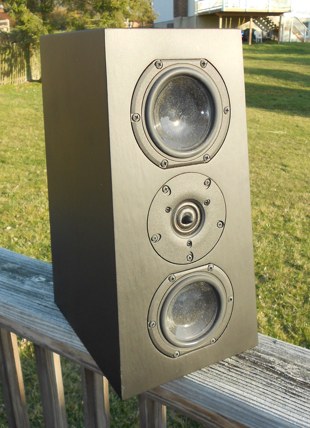

Madisound has sold this kit for a few years: The Madisound Speaker Store What is shown in pic is the kit, bought a few years ago. I did have a three set, this is all that is left now, just parts for one.
It was in a MS recommended size sealed box, but advertised as vented: Peerless 830870 4" PPB Cone HDS Woofer 264-1070

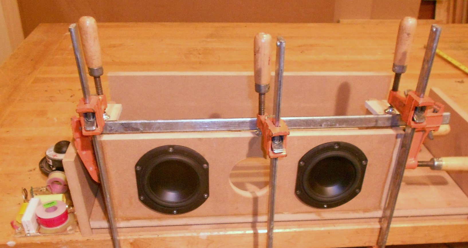

Today's project is gluing up a VENTED test box with cut-offs, which had just enough scrap.
Tip - cut woofer hole 3 -3/4" and bevel/chamfer back of baffle, the woofer(s) will slip in, without notching for terminal.
xo plan attached, the pre made xo does not fit the in the 3-3/4" hole which drove me crazy and why the sealed box ended up in the wheelie-bin. I.e. had to cut the sealed box open 🤐
The sensible thing to do is simply DIY two mini xo's for woofer and tweeter.
Note a 2.2ohm series tweeter resistor is not shown on Schematic.

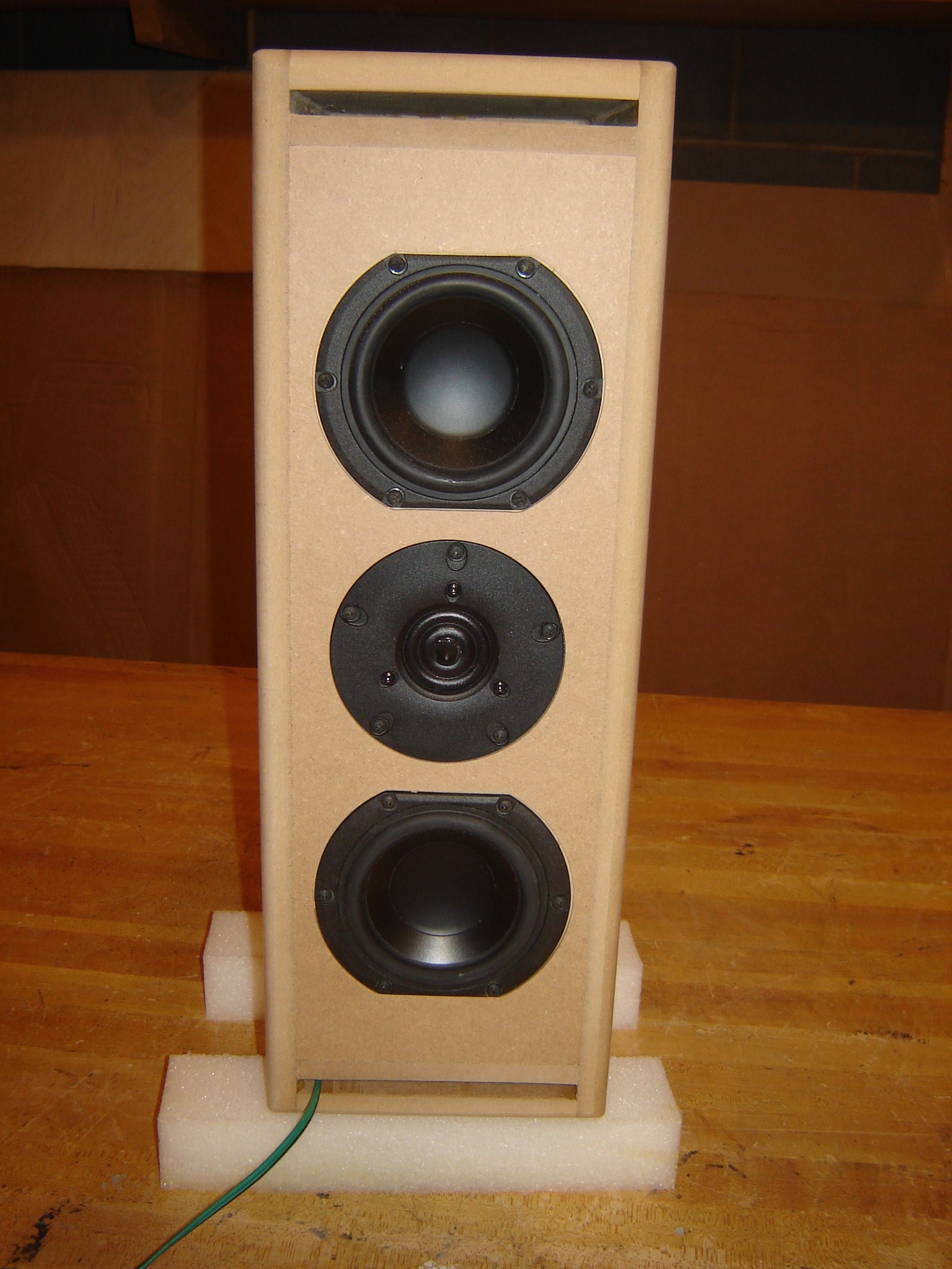

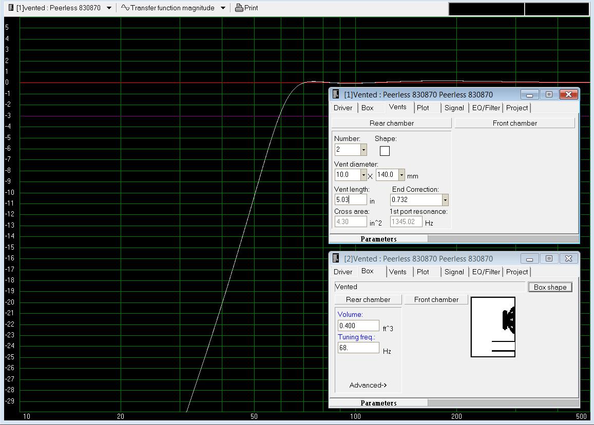

So yes, pretty impressive bass; they were going pretty strong down to 60hz (sweep test). Darn smooth also! The tuning also looked good, Fs-68hz.
I'm going to see if I can get a buddy to measure them, if okay, we can clone this test box.
Surprised this worked so well with the high Q drivers, .74.

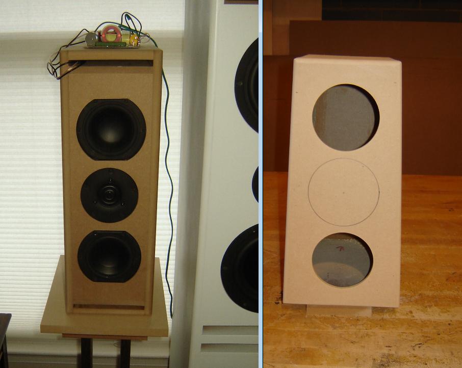

Pic: box that got cut in half and silicon on cones.
btw, the .42 (net volume) vented box has some power; the overhead ducts in the room were vibrating, not that loud/not much cone movement.
