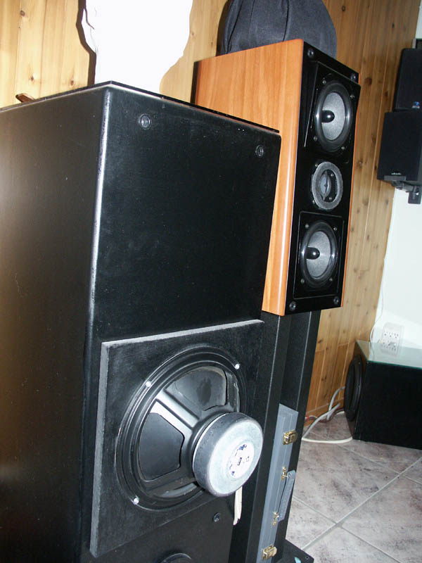

these are my 2 subs finally finished. I have 2 Isobarik boxes (75 liters) using 2 Peerless 831727 each, tuned with a 4 inch port 38 inches long, tuned to 22 Hz. These are very musical subs, not boomy. the box is 1 inch MDF all around . Total weight is 75 pounds each. I also built an small 1 cu foot sealed box with an Peerless 10 inch 269 and its passive radiator. This one doesn't get as down as the Iso (-3 at 30Hz) but it makes up in total output. Really good for H/T, very quiet motor
Push-pull, two woofer sharing the same enclosure with one driver's magnet firing out of the sub so both cones move together.
Isobarik is used as a piston to reduce the size of the sub.
I first built them with a single hp and I got very good response.
Adding the second woofer in Iso config, changed everything. The bass just tightened a whole lot. Boomy bass just dissapeared. Adding the seconf woofer did not really improved on dynamics. I still could bottom the speakers on h/t,(That's the reason I built the small 269 Peerless). What it did is change the whole speaker response, I guess it is true that all the distorsion is cancelled in the process. If you can, add that in your design, you wont be sorry.

I am at the moment making a similar sub using 2 of the 831875 12" classic series drivers in a 60 ltr box .
could you tell me how far apart you have the drivers .
did you just guess how much you needed or is there a way to do this
Also what is the idea behind the material around the tweeter .
Are some materials better than others . Will this work on any tweeter ? thanks

busterno1 said:Also what is the idea behind the material around the tweeter .
The idea is to absorb the wave that travels along the baffle before it has a chance to defract and rereadiate.
The material pictured by Vince35 is a loose speaker damping material which may or may not be largely made out of wool.
The JMLabs above have a round ring which is probably the worst possible shape, the square cutout is better, i like something even more complex -- i use stars with a prime number of points and cut such that the leading edge of the cut is at an angle. I typically use fairly dense (& thick) woolfelt.

Hi BusterNo1, the idea is to space the drivers far enough so that mechanically, they wont touch each other at max X.
As far is the ring around the tweeter, I used an old foam mouse carpet that was laying around. Cheers
