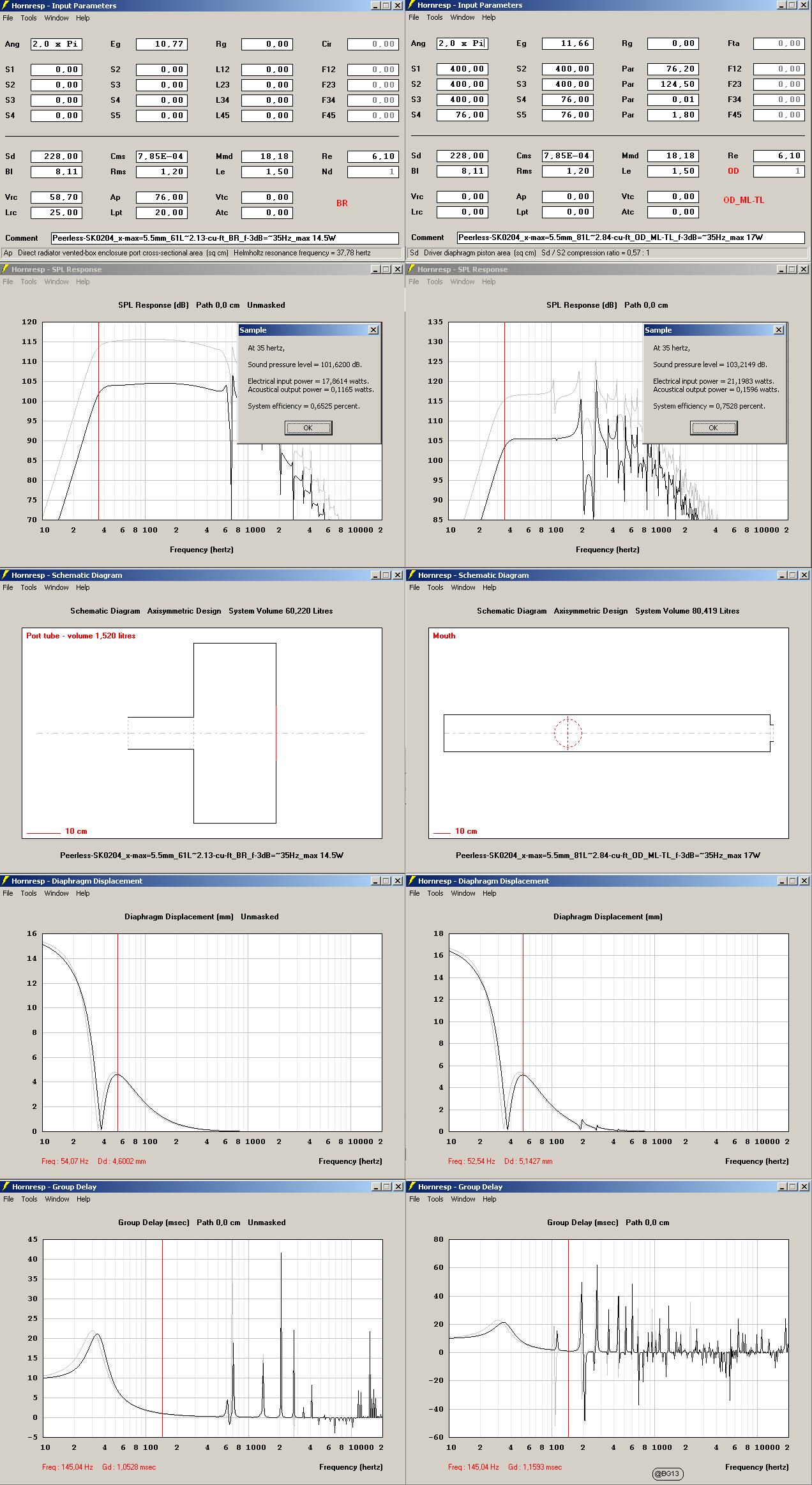

So in other words this could work fine?
I did some simulations in WinISD and hornresp and the kurves looked nice but I thougt "Whats the catch". You know I am pretty new to this.🙂

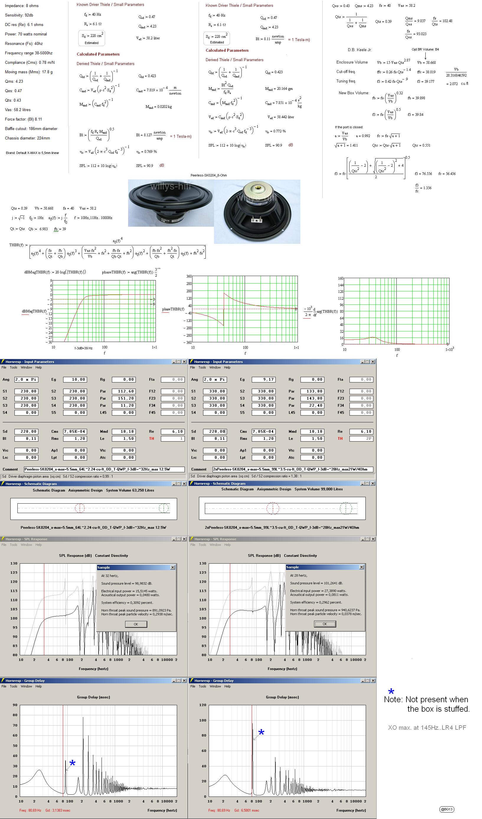

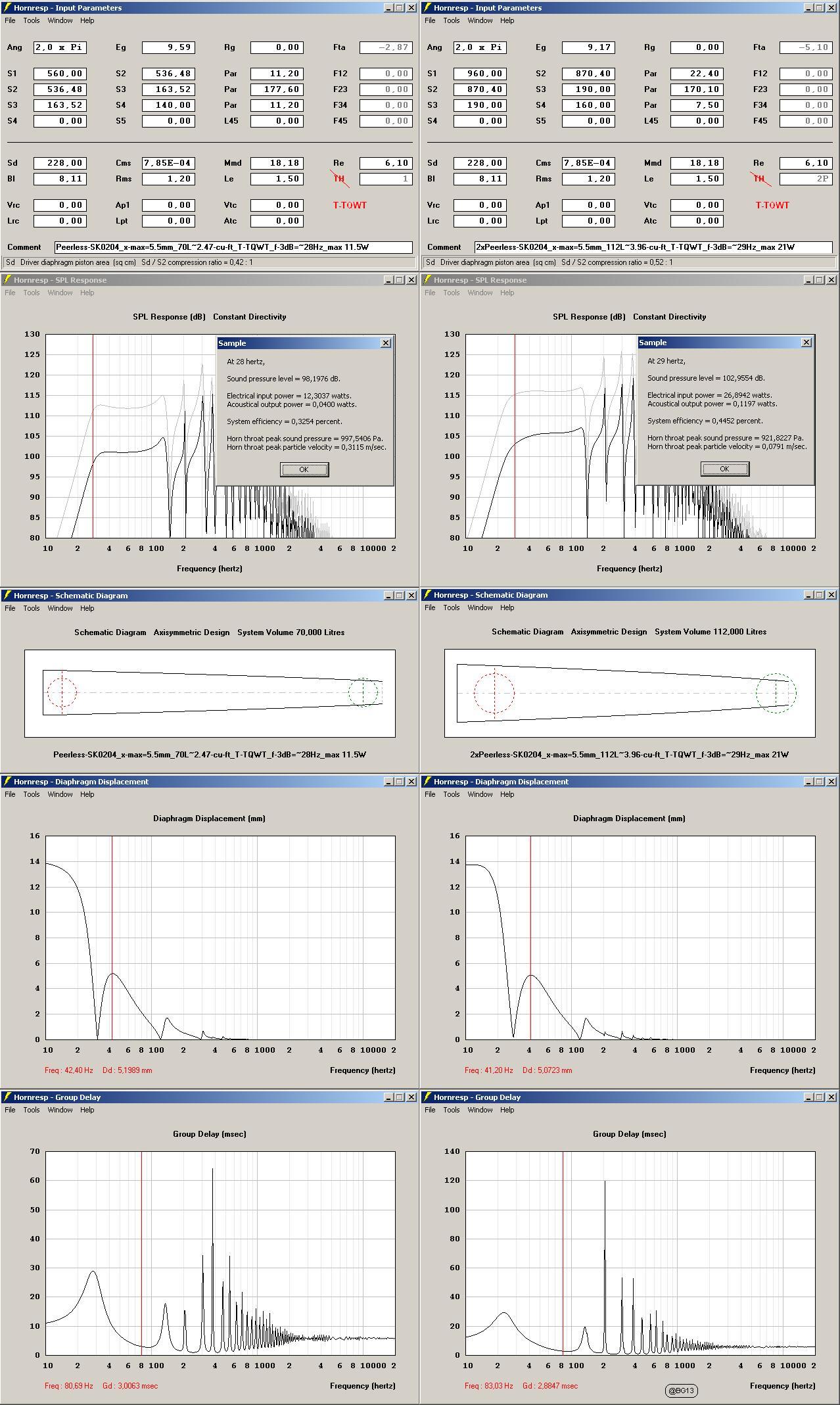

Hi Fredrik,
Work fine'? IME, I believe you will be surprised of the very good SQ that comes when choosing T-QWP: s or T-TQWT: s...
..and 'No catch' as far as I can see other than the possibility to IMO preferably pick a single folded design (not the simpler BR 100mm(~98.4) diameter port/21(20) cm length)...if.... your 'Mission Bookshelf Speakers' have an f-3dB of 52..57Hz but if around 75Hz:
I would not hesitate to choose a cabinet with more than one bend (more extended upper end BW) or the mentioned simpler BR. An example of a single fold using the Peerless SKO204 driver(s):
.. If I were you I would invest in more than 4 drivers: One or two flanking(lateral placed) smaller BR boxes would be a good idea to include besides one or two main sub(s) using 2-driver cabinet(s)..
b🙂
PS: You may dig into this thread concerning single folded T-TQWT: s. Copy and scale the dimensioning if you choose to make a couple of these.
http://www.diyaudio.com/forums/subwoofers/188283-fiddling-hornresp-peerless-831759-a.html

Could somebody please help me double fold this T_TQWT so that it will be more squarish.
Or link me to a page or program that can do so??
Fredrik
Fredrik
What program to use wen folding a pipe so that L23 really gets the right length when folded.
Fredrik
Simple DIY geometry is most effective😉
b🙂
Fredrik
Which picture(part) are you referring ?
b🙂
